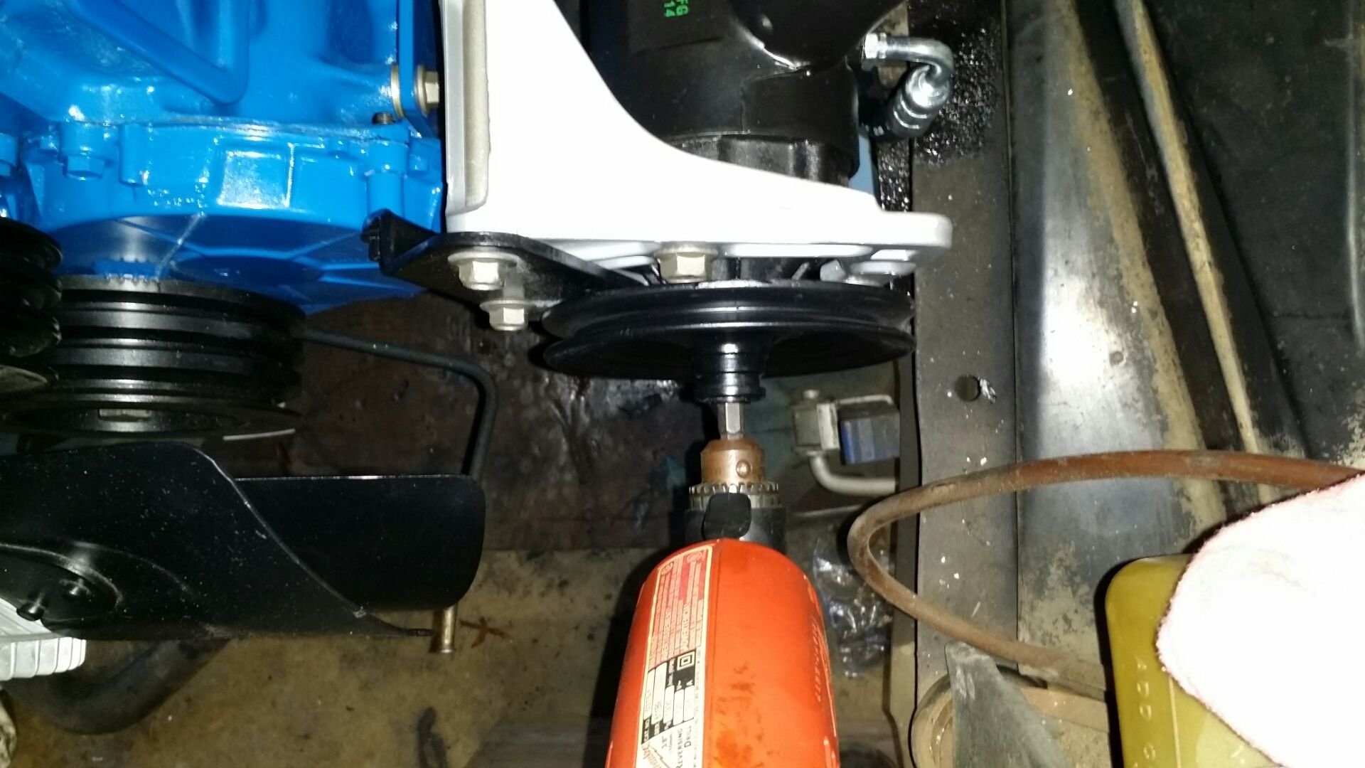

POWER STEERING FORD F100 1967 RANGER V8 352
Hello Everybody,
I just finish to install the kit:
--> 65 66 67 68 69 70 71 72 73 74 75 76 Ford F100 F250 2WD Truck Power Steering | eBay
--> It is a Bendix gear
--> And the pully come from here:
--> 390 Ford FE Engine Pulley Kit PS
the problem is that 2 time ( I change 2 time for a new pump), just after starting the engine 3 mn later the pump start to make some noise and start to be very very hot.
My mechanics told me that the pump was poor quality and broken.
But 2 time?
I check also with my mechanist.
1/ There is no foam in the fluid.
2/ We check the flow back into the pump and there is a good pressure.
the model of the pump is a Cardone 20-6000 pump
Can someone help me or have an idea for changing the pump by a more reliable.... or some other idea.!!
I attached some picture .

You have a Saginaw power steering pump and what looks like a Bendix power steering gear box. Compared to a Saginaw PS gear box, the Bendix is a less desirable unit because it tends to run hot.
The whining noise from the power steering pump is most likely caused from air in the system that wasn't purged out before the engine was started. This will often cause damage to the pump and the whining may never go away even you you do get the air out of the system.
It's best to prime the power steering pump/system with a variable speed drill motor and a 3/8" hex bit engaged into the front of the pump shaft (turned at slow speed) BEFORE putting the belt on and starting the engine.
This is how I primed the Ford C-2 PS pump and system on my truck, before putting the V-belt on and firing up the engine. My pump has never whined since using this method.

While the Saginaw (Cardone 20-6000) pump isn't very attractive looking, it's considered one of the best PS pumps around. The problem most likely wasn't with the remanufactured pump but, in the method of installing it and the lack of bleeding all the air from the system, before starting the engine. This can damage any PS pump if it isn't sufficiently covered (and stay covered) with fluid before running the engine.
The idling RPMs of an engine are much higher than the slow revolutions of using a variable speed drill motor to purge the air from a newly installed PS pump and/or PS system.
There are various PS oil coolers avaible. The factory also installed them on some trucks/cars. It would be plumbed in series between the the PS gear box and the return port on the PS pump reservoir.
