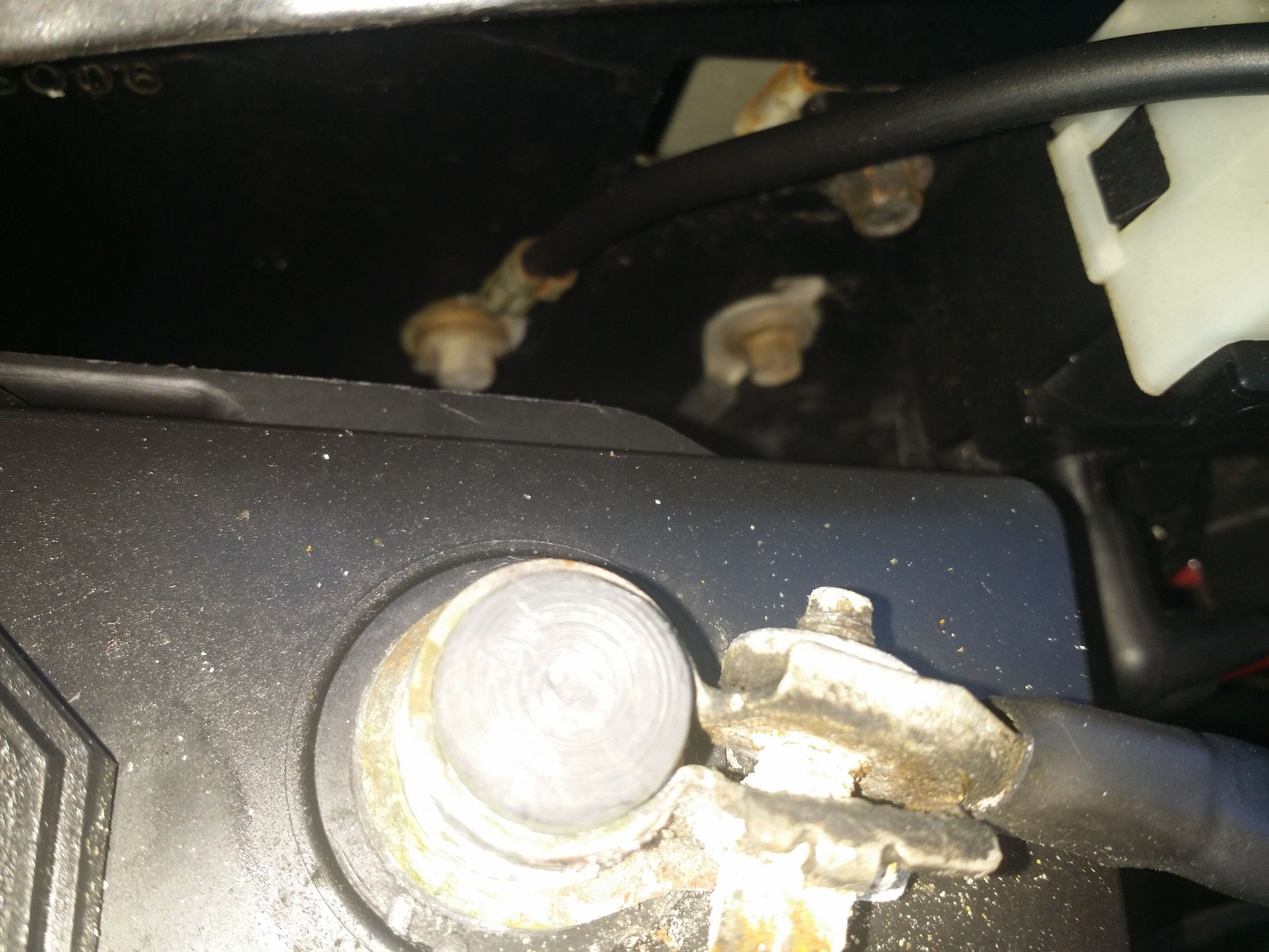

Thanks for the response, I have checked it and it seems fine. Here is a picture:

Could be the alternator...from the pic that looks like a new battery if I had to guess. It sure is the cleanest one I have ever seen inside a vehicle...
