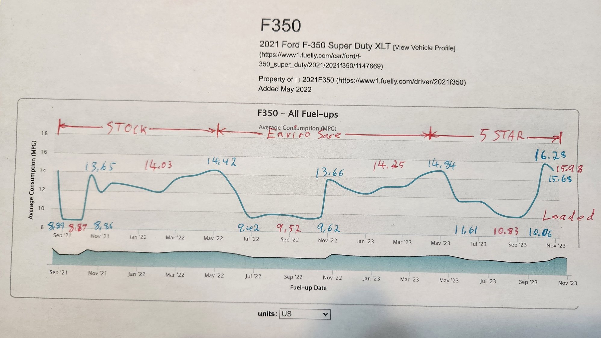

Got my 5 STAR maps installed for one week now, (87 octane, tow map). So far I just have driven it around empty but can certainly tell the difference... The shifts points are much better, the throttle reaction is much better, the load normally at 80 -85% is now more like70-75%, and the throttle used to be 20-22% is now 17-20% while going down the same roads at the same speeds I usually do, probably gained about 0.5MPG on my 1/2 tank of driving so far...

Well it's been a month now, 1,492 miles with an average that went down to 13.1MPG BUT, it snowed 2'+, it went down to -35*C, so... Maybe next month the weather will co-operate and be in the normal 0*C with the snow disappearing To get a "normal" MPG average...
As for the drivability in ECO mode it's better than stock, that's for sure
EDIT; I went back to last years February's average numbers, and I drove 1,252 miles and 11.9 MPG is what I averaged. So this February's 13.1 MPG average, doesn't sound too bad at all...

Here are my thoughts on 5 Star tuning maps... Made the truck noticeably better in every way. IMO
MPG average for 2021. after break-in.
14.0 empty 2397 miles. (Best 14.2 MPG highway)
8.8 loaded 1,992 miles.
MPG average for 2022. after using EnviroSave treatment.
14.3 empty 4,742 miles. (Best 15.1 MPG highway)
9.5 loaded 4,714 miles.
MPG average for 2023. after installing 5 Star eco map
15.9 empty 6,008 miles. (Best 18.0 MPG highway) I have also put on a tonneau bed cover for airflow control...
10.8 loaded 7,380 miles, I believe the mileage would improve even more if the stock shifting pattern was improved, this loosing too much speed and trying to make it up on hills is very hard on the fuel mileage, I do believe. will come back with more loaded numbers in the next few months...
Tried out the truck in T/H mode, and, got 9.2 MPG for one fishing trip of 74 Miles... with absolutely no difference in performance (meaning eco setting is good enough power for me)... I think I will just stay in eco mode and be happy...
Seems like I got, for my "final" numbers... an average of 22% MPG improvement with the truck loaded, always exactly the same load for the last 3 years, with all the things I did...
For "empty" I got 14.03 MPG then a 15.98 MPG average, a 13.8% improvement for 3 years of almost winter like driving...
