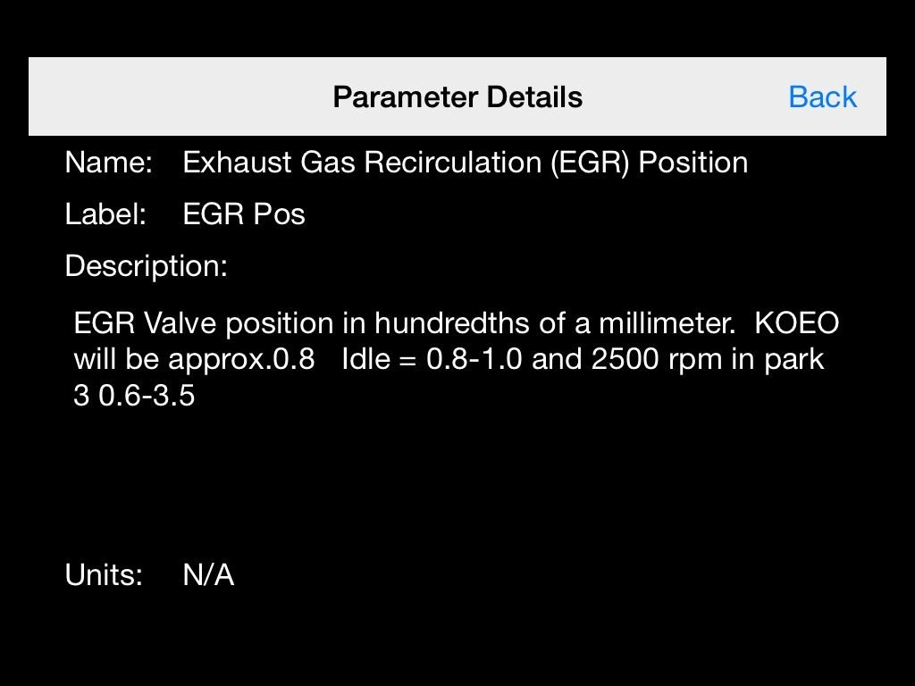

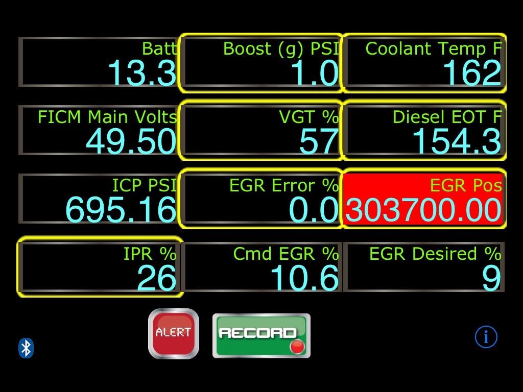

Well, I'm finally getting back to this as the flu bug got me. Still not feeling too well but ran these tests and can see an issue with the egr position.
Anyone else see this before? Not sure if cleaning will fix the issue as it looks more like an electrical sensing issue when you see the numbers in the red box below.
Interesting that the command and desired numbers are just about normal, while sitting at about 2,000 rpm's parked.
Note the explanation and expected numbers, where the egr position should be in the second photo.
I still have to get under the hood as noted above but moving a bit slow right now.

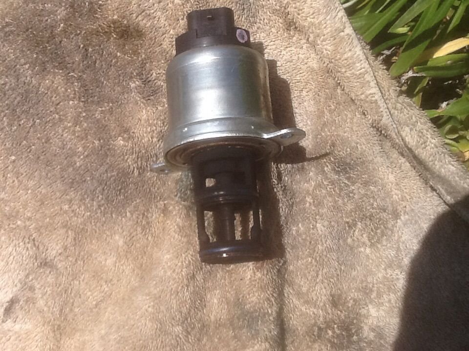

Well,
I pulled my egr valve and it looks good, very little residue on it and it operates open and closed very freely by hand. Here's a picture I took y/day before cleaning.
I put it back in and am still getting the extreme numbers for egr position on my Dashboss.
Is there a good way to test these valves with a vom?
Thanks.
