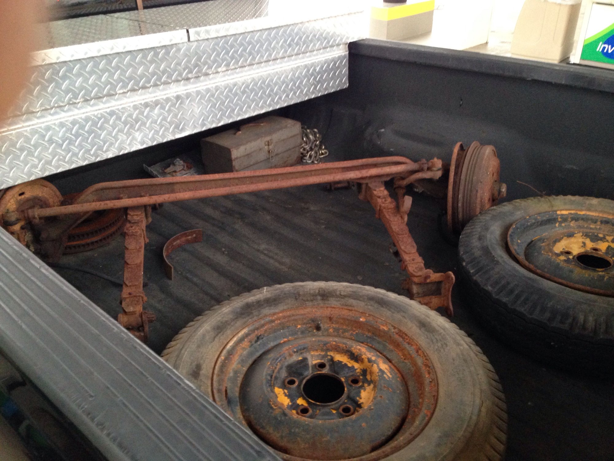

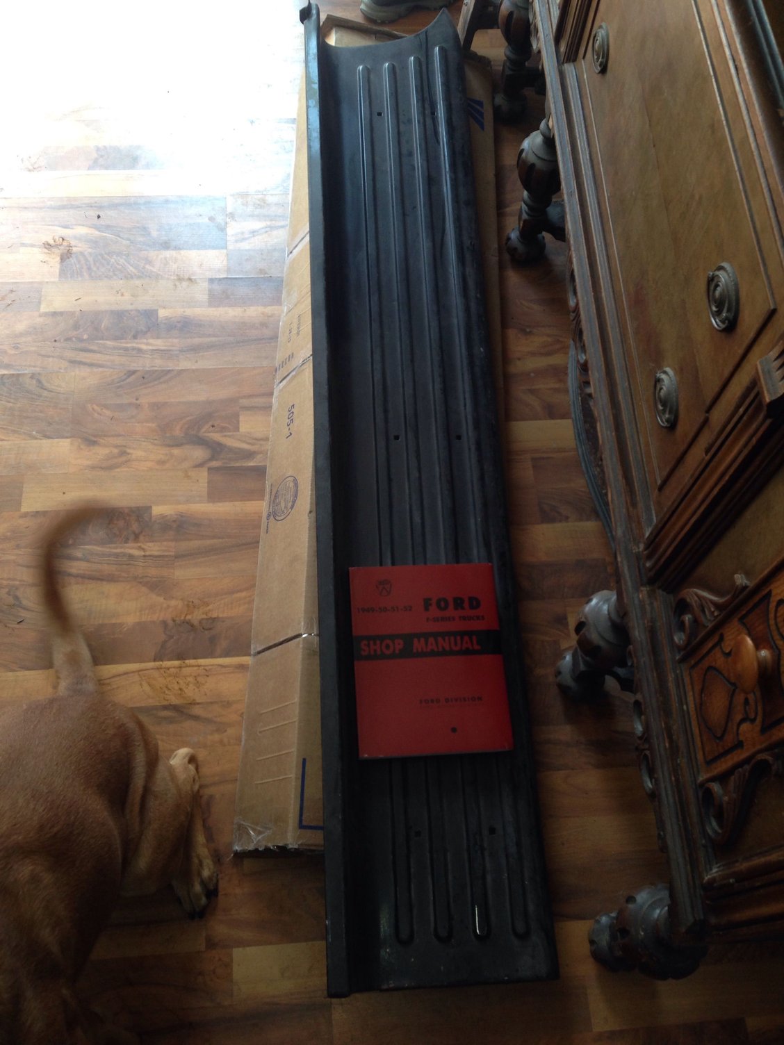

Also a couple eBay buys. Running board was supposedly possibly NOS according to seller but I highly doubt it after receiving it. Anyhow for 140$ even for one running board,reproduction or not don't seem bad.

Nice score. Man look how straight that tie rod is. I don't think I have ever seen an old one that straight. You also got some nice original rims. The innies are pretty hard to find. (Or I wasn't looking in the right place.)

Yeah I think I did alright.All in with fuel I was in under 300$ for what's in the bed.Will definitely need brakes and kingpins.Kingpin set is on it's way,trying to find the correct reamer now. Cheapest in town was 100$ to install and align/ream bushings.One shop wanted 85$ a side if i brought them everything took apart,bushings already installed.
I now have 3 16's and a 15 inch wheel now lol. "Innies" these are known as? Are they original? They have tubes installed, and so did the rear.I have my own tire machine and just threw some modern tires I had laying around on for now so I can move the chassis around.
Unfortunately the running board doesn't seem correct now that I've put it side by side the original.I started another thread for that question.

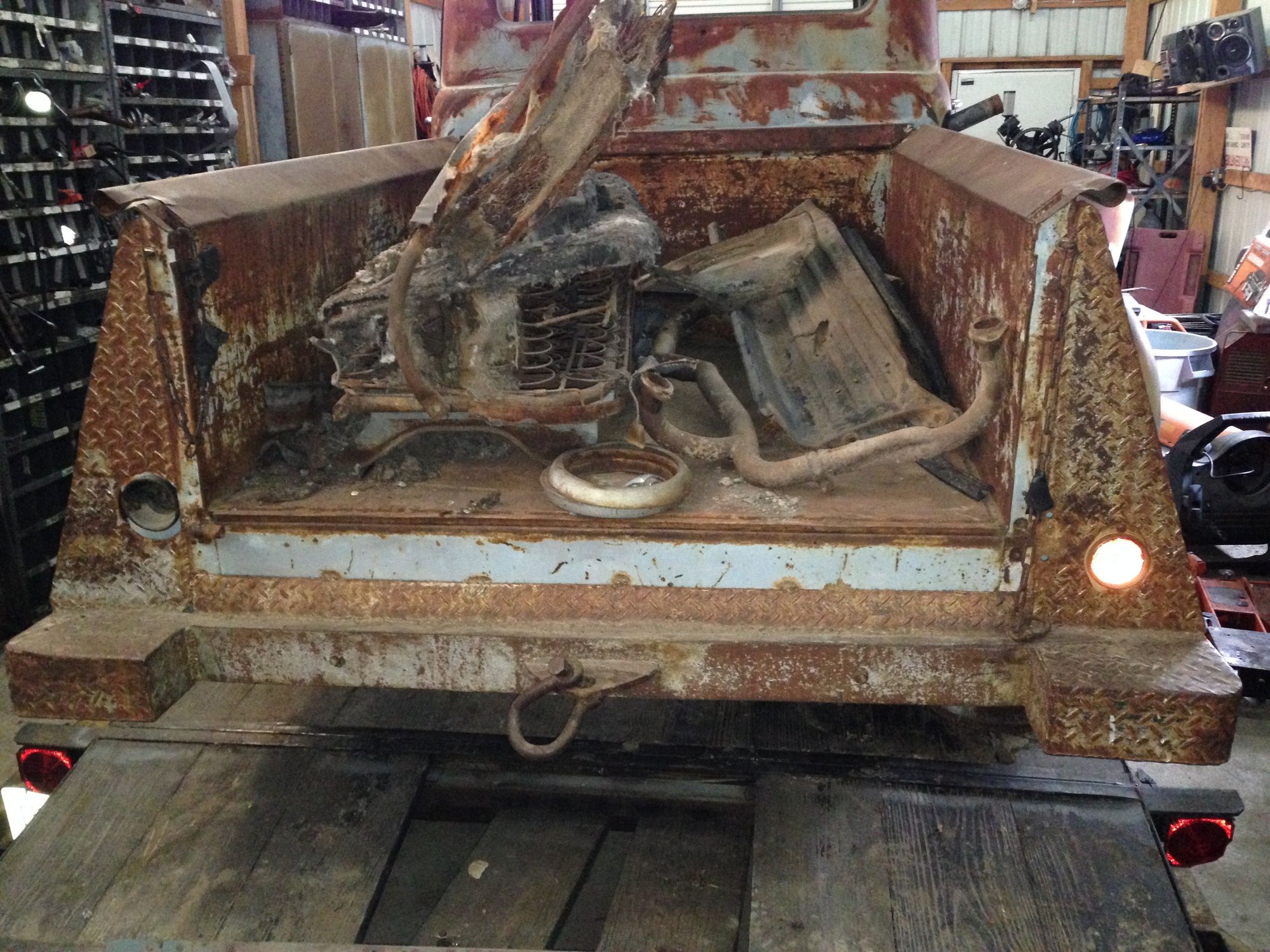

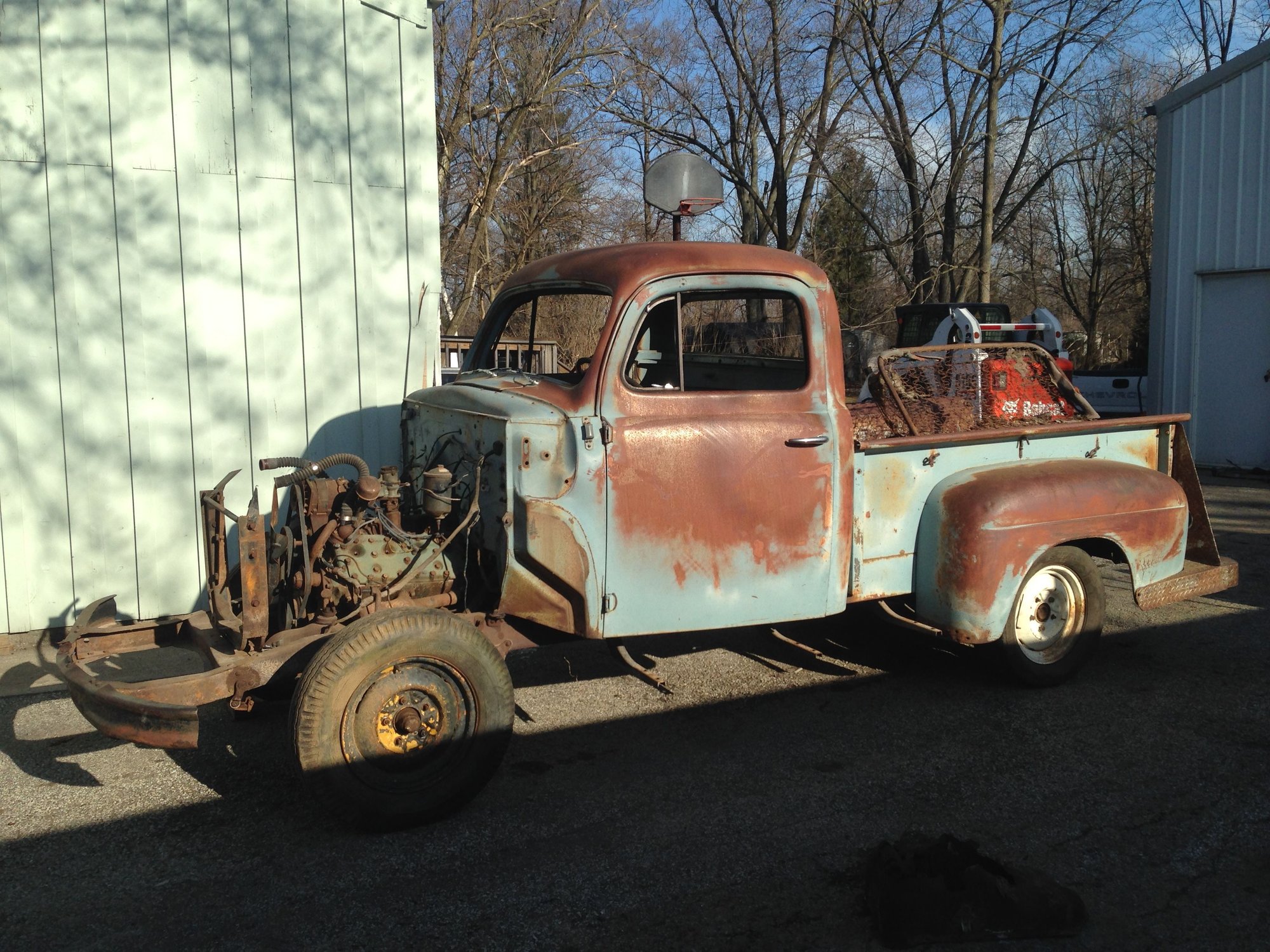

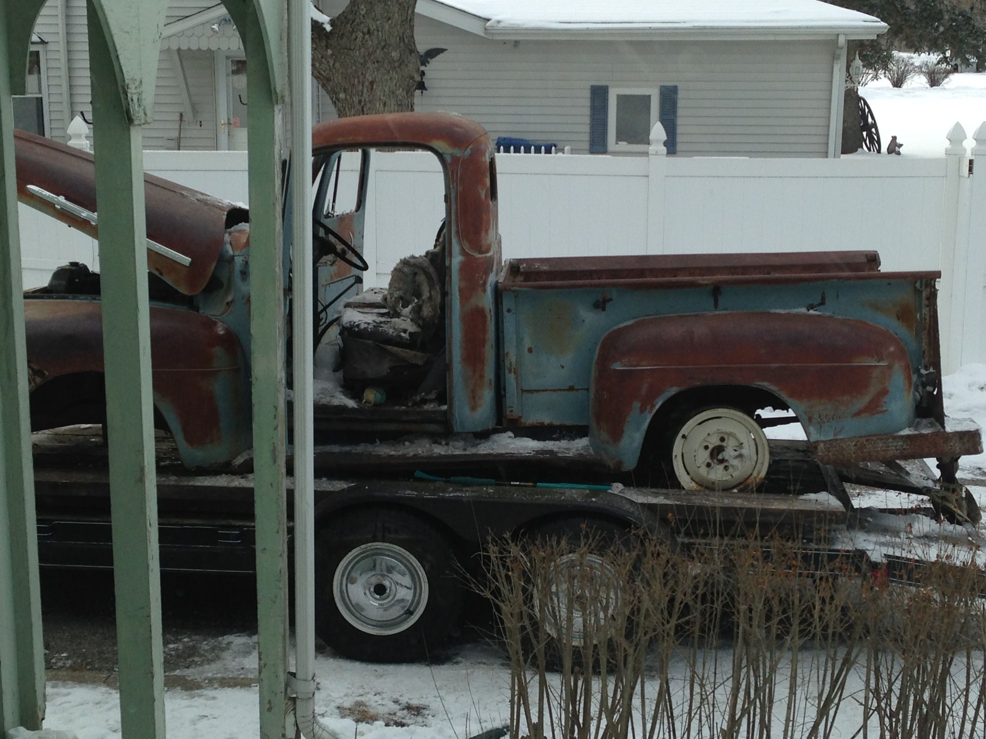

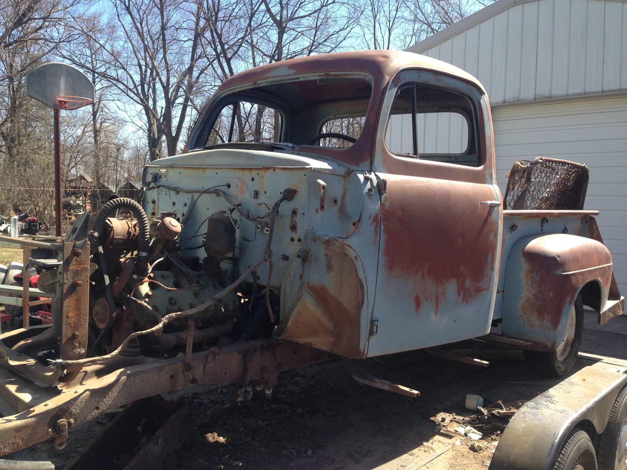

Here's some pics from when I towed it home, and a couple I took while taking it apart. I should be out there now pulling the drivetrain and getting that front axle under it, but it's 27 degrees here again after having been in the 50's/60's. Pretty well kills motivation.

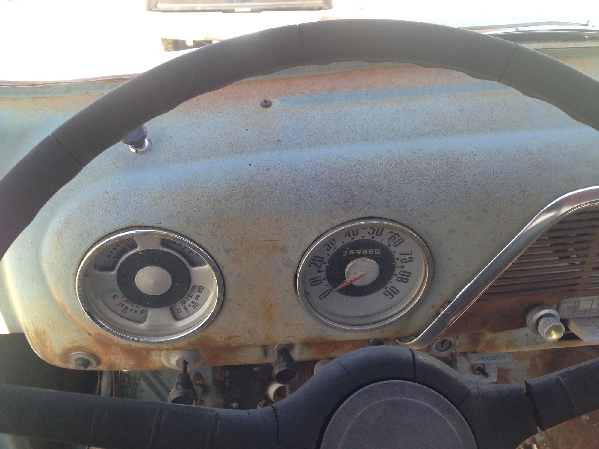

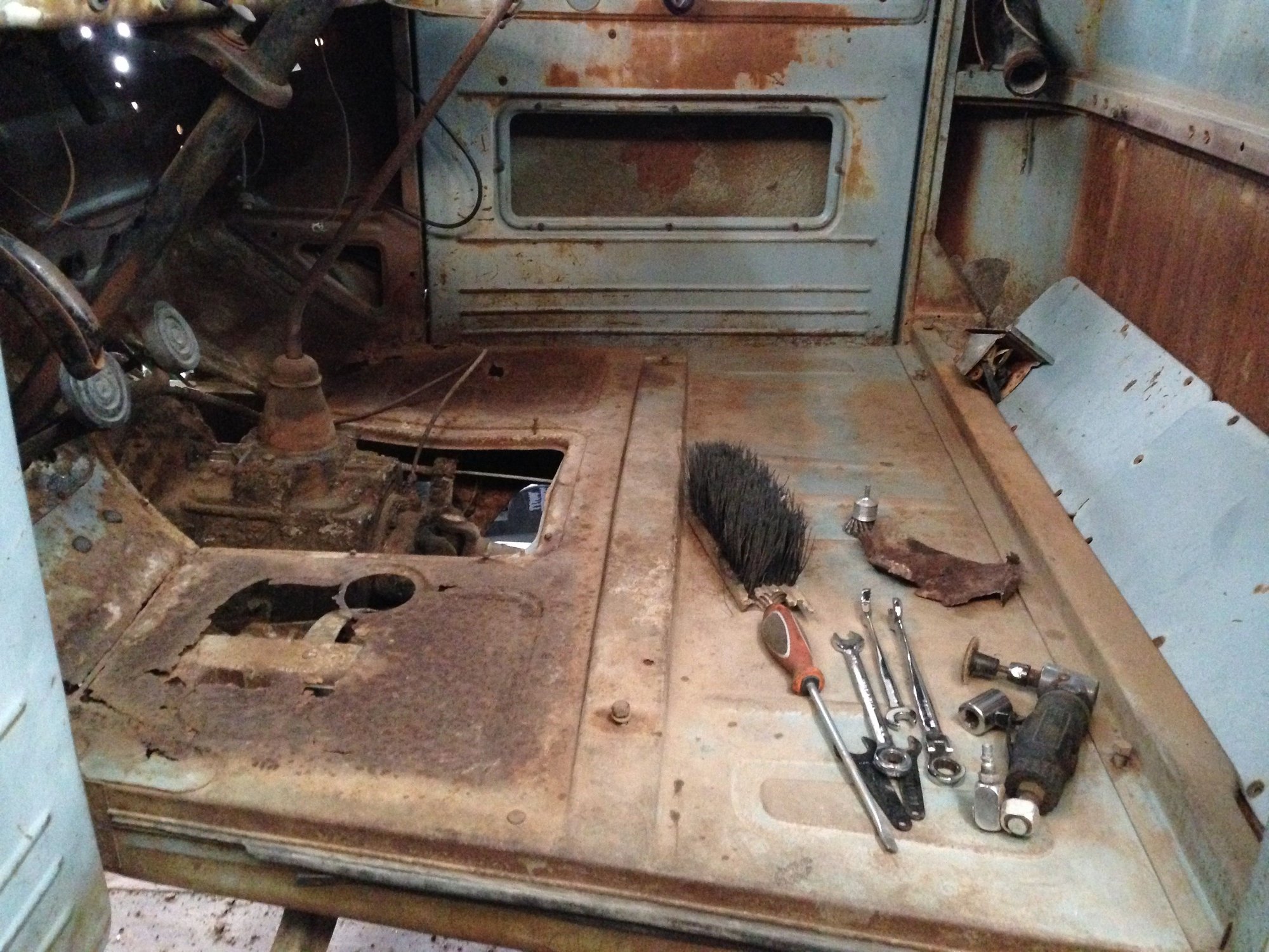

This is probably the only pic of the interior before I took it out. In much the condition you'd expect and what most probably started with. All the glass was busted out for who knows how long.

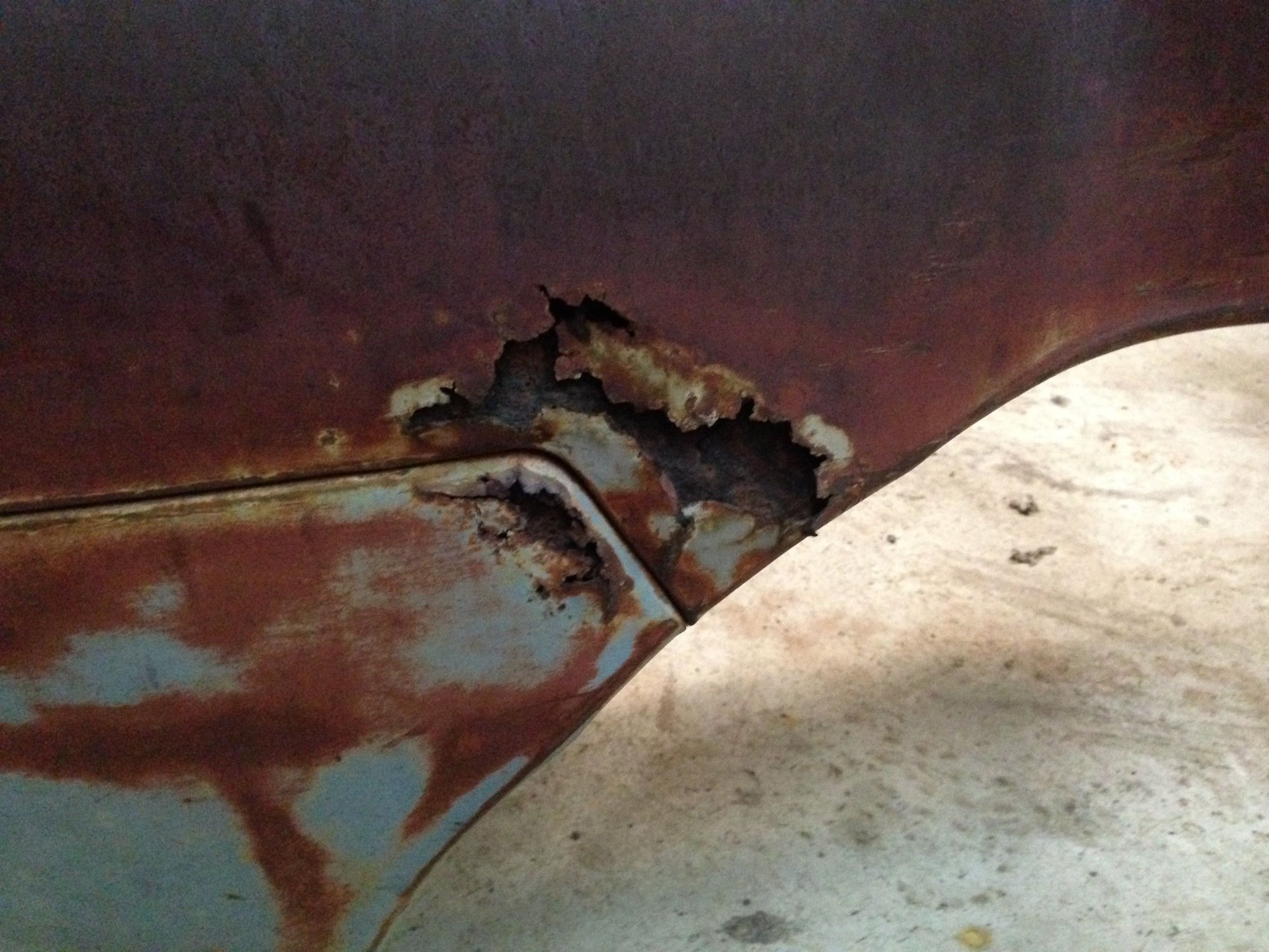

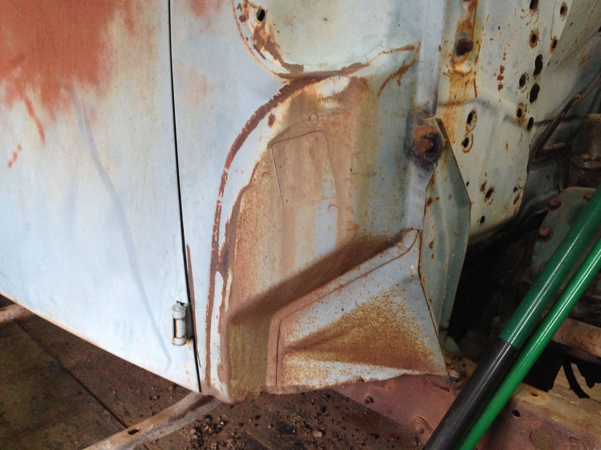

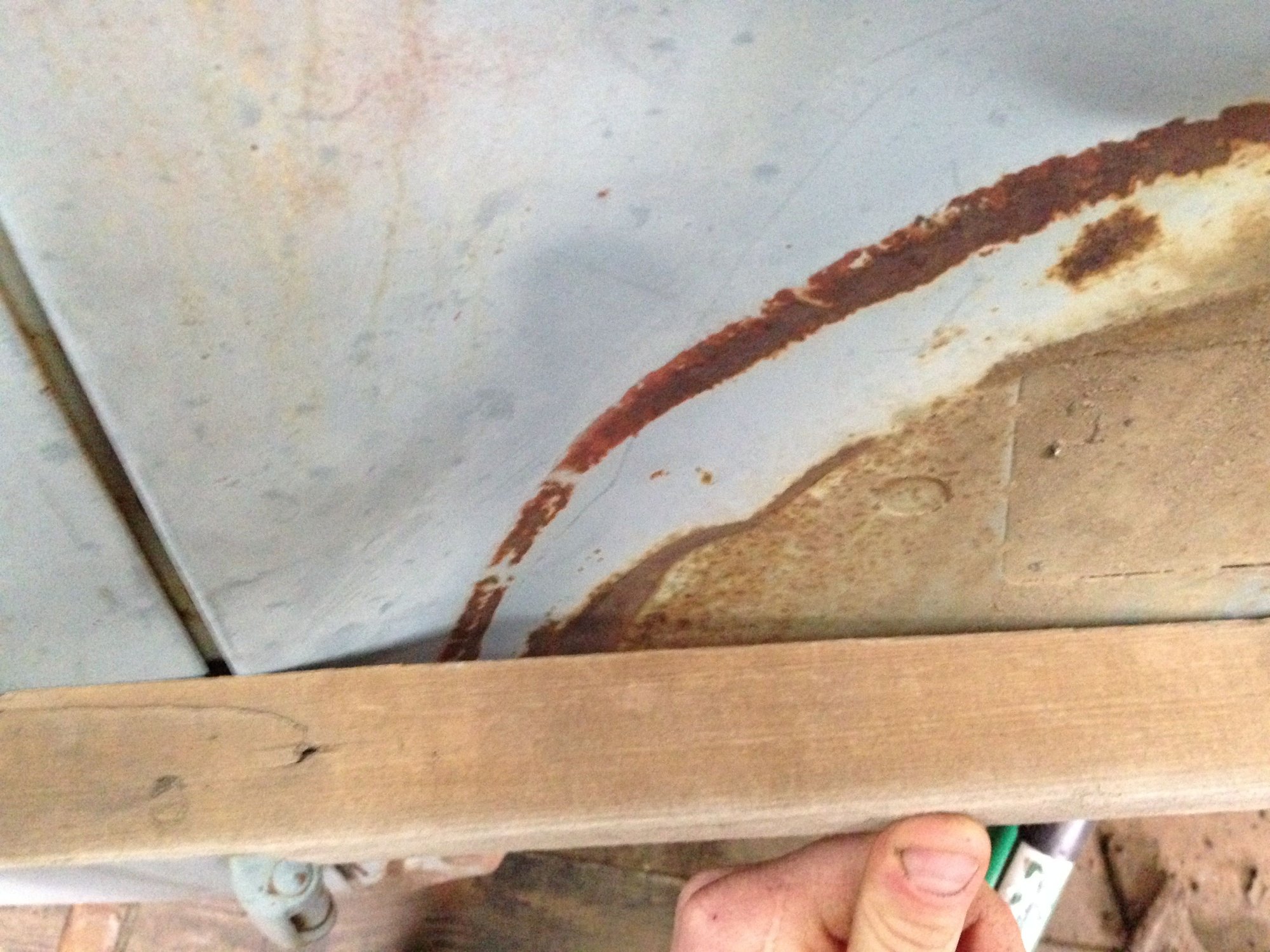

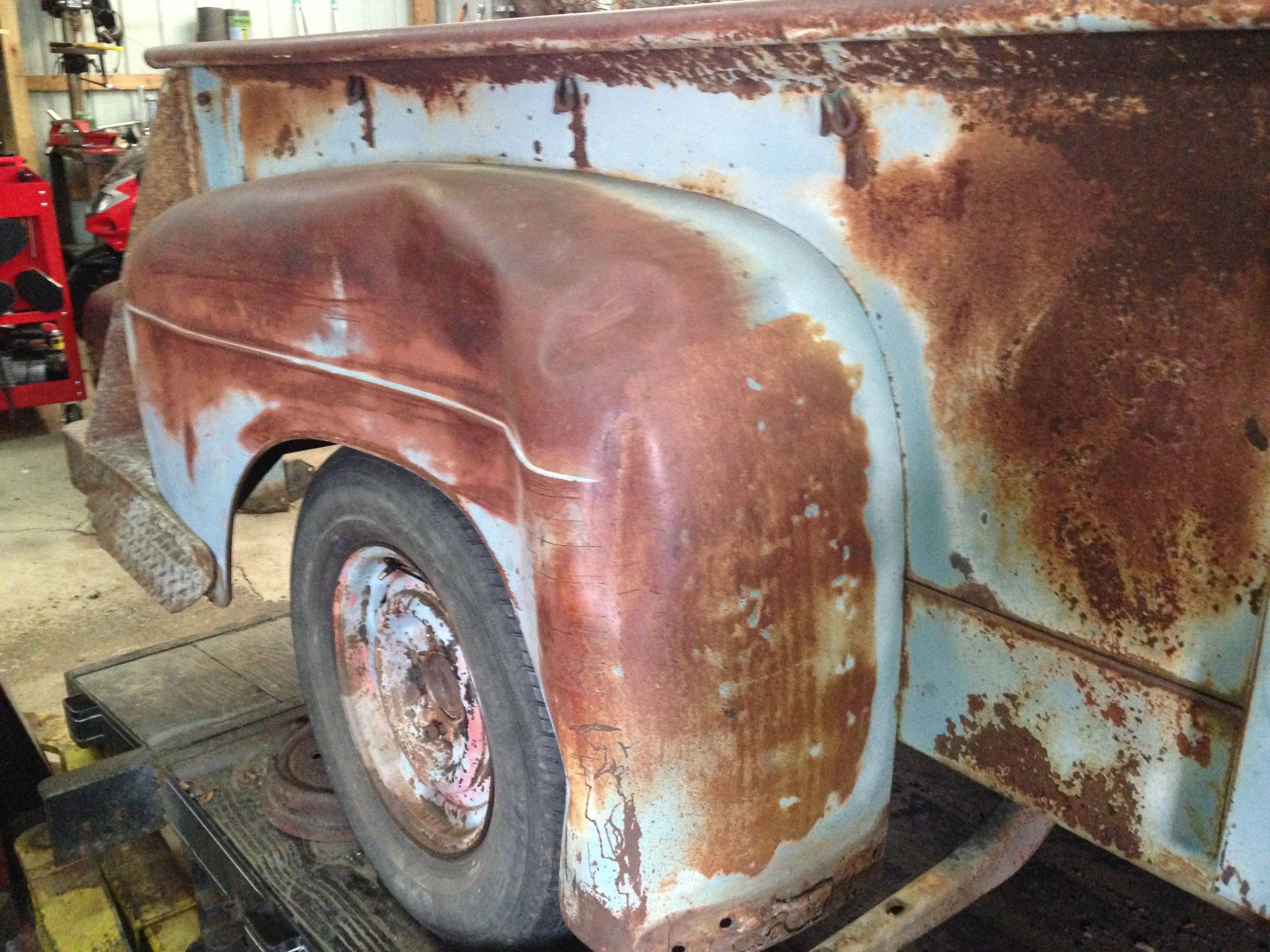

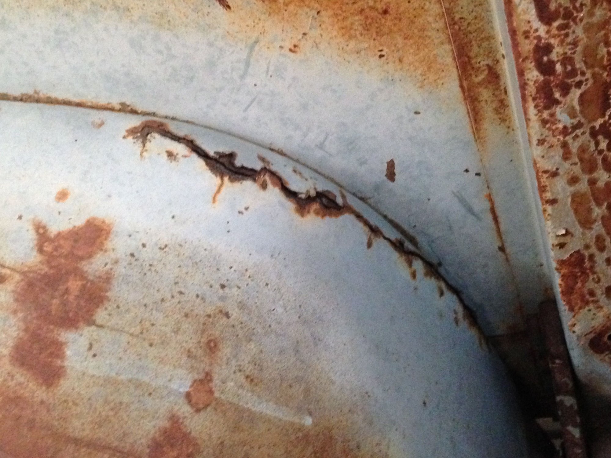

Now for some of the "bad" stuff. It's really very solid I think, came from the western side of Nebraska.Never been there but it must be fairly dry as it was obviously outside for a long time.Would not had been anything left of it here in northwest Indiana.I've daily driven cars with worse floors lol. It had literally a large wheelbarrow's worth of dust/mud in the floor,cab corners,inside the bottom of doors,wherever it could fit. This held moisture I suppose and there's rust hole in the passenger cab corner,luckily in between the cab and bed so I can patch in without losing the patina I like. As I'm sure most you guys are aware anywhere two pieces of sheet metal were sandwiched to reinforce dust collected and metal rotted.
reinforcing strip at rear of rear fender
double walled part of front fender
rear half of floor in great shape, will need to do front half,cab mount plates.

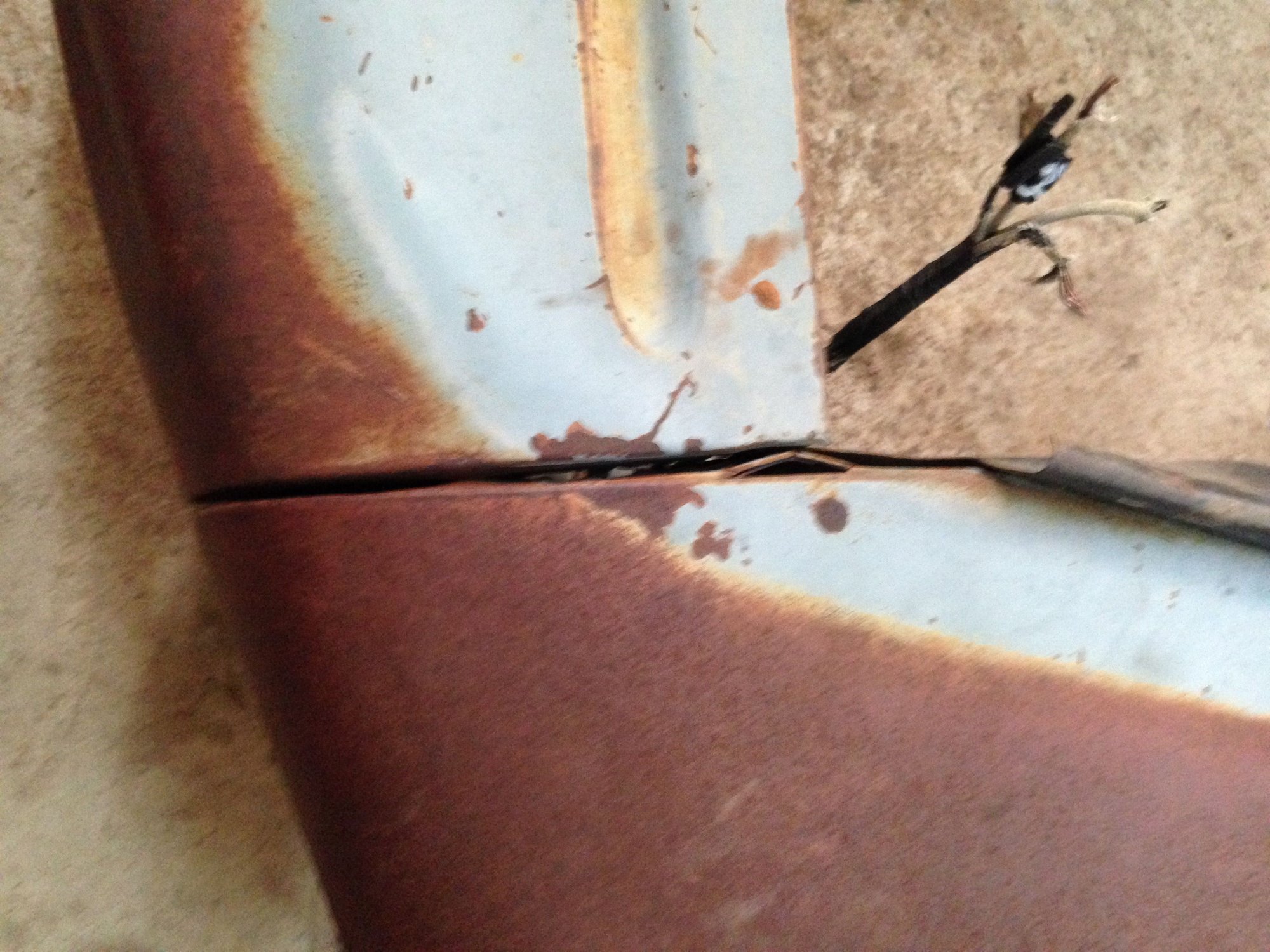

The front sheetmetal had been knocked around over time, panels aren't all straight and passenger fender was pushed into cab. This is something I'm not sure what to do about, I'm not really a body guy.I would like to pull out the dent, but don't want to change the rust/paint anywhere visible.I'd also like the seams and lines to butt together better. I think I can manage that pretty well with hammer and dolly, but any advice from those who know better as I go along is welcome.
this is where the fender was pushed in the cab
This should show how much.

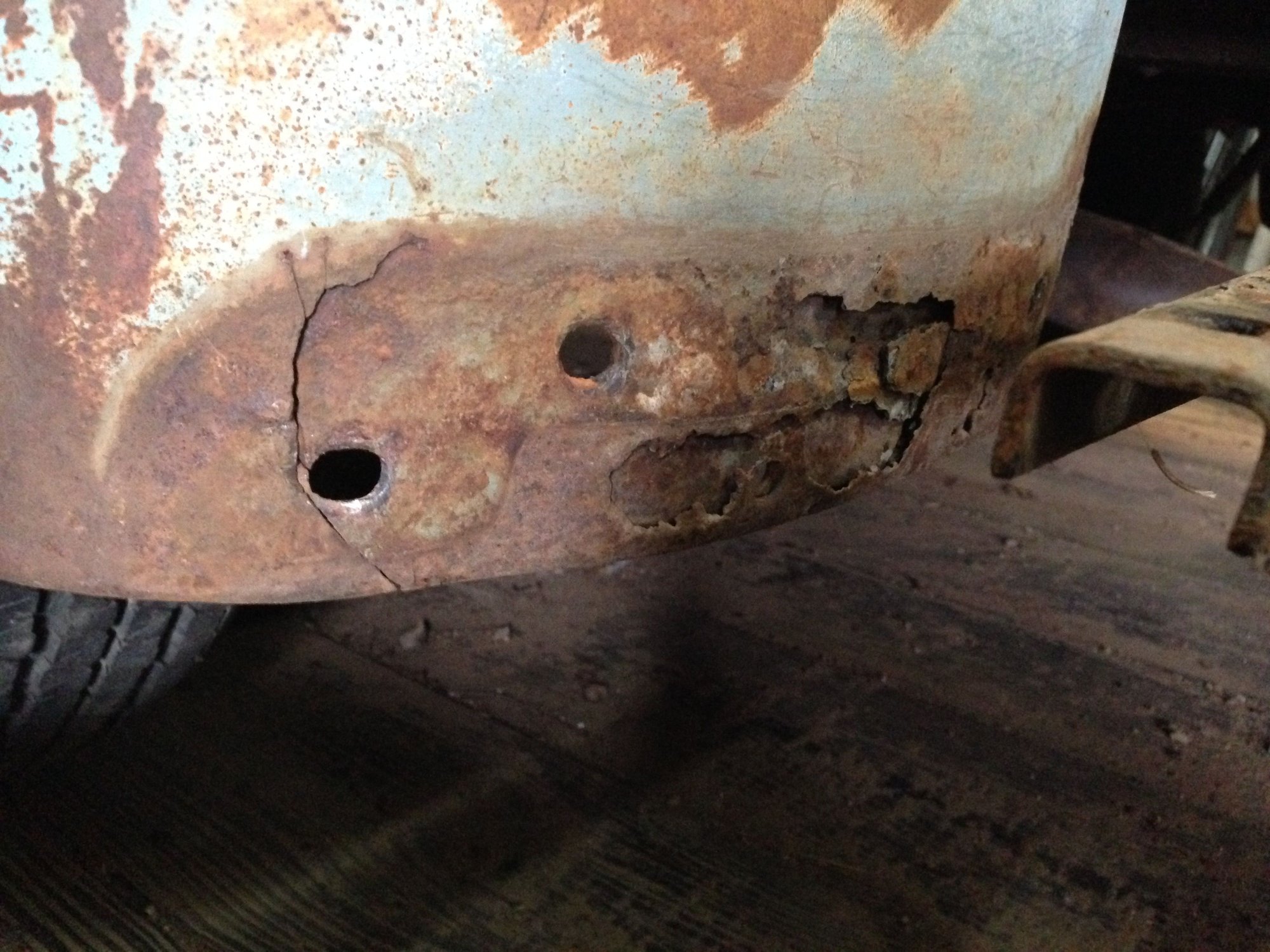

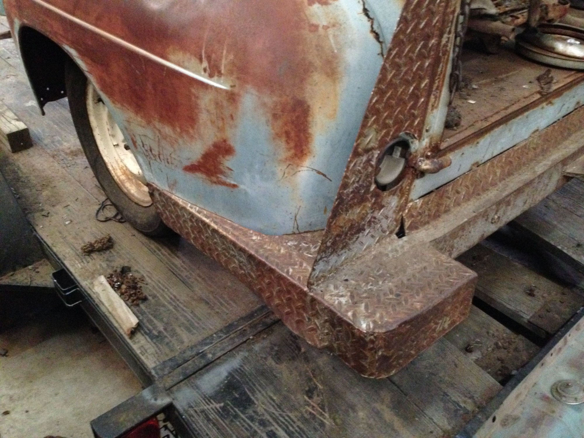

bottom rear of passenger front fender. I figure this will have to be a patch panel and tigged or migged in. Probably to crinkled too much for my at the moment non existent sheet metal shaping abilities.

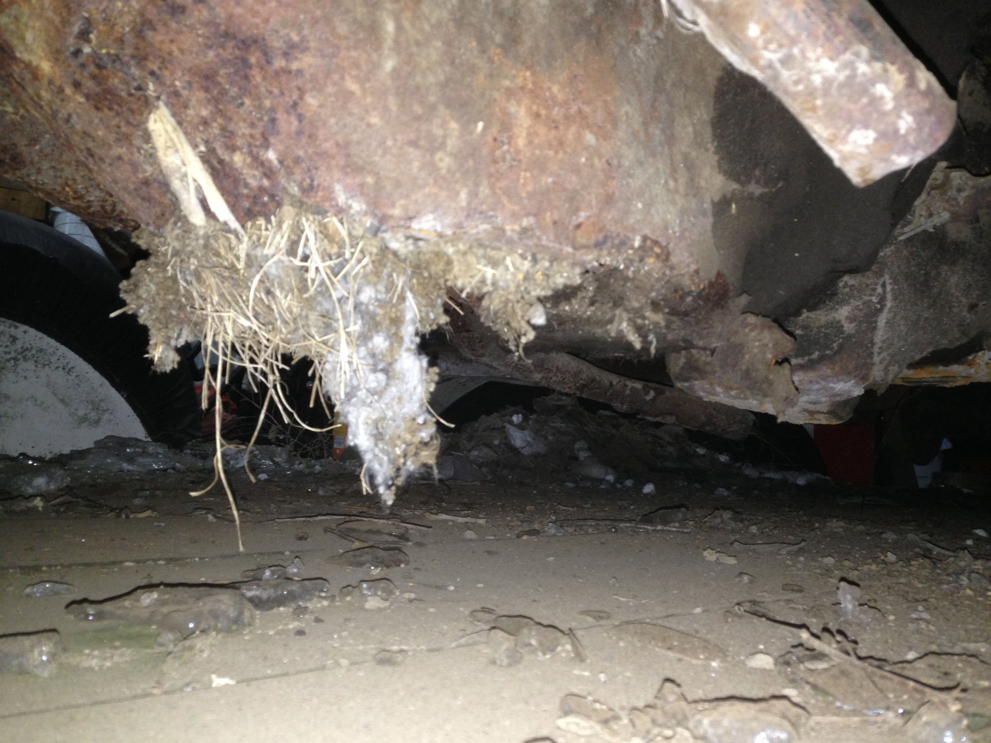

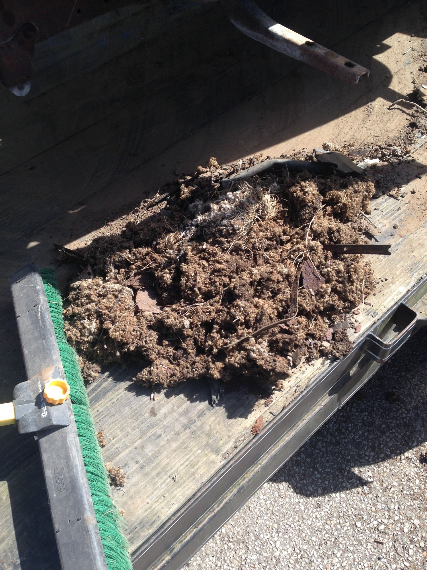

Lastly for now some pics to show why I don't know if this flathead will be worth me using. When first checking out the truck I had hopes of seeing what it was like to drive one(I'm 26,never even worked on one), figuring as complete as it was(missing only starter) it wouldnt take a lot of money to get going. I always planned for a new powerplant but would have liked to drive it for whatever amount of time it took to plan and buy everything so as to get it done over a winter or so.Or maybe I would've just enjoyed it that way.Anyhow mice had the entire crankcase packed with nesting material, and the bottom end is badly rusted.I'll get good pics for everyone to see once it's on the stand and I attempt to tear it down.It also looks like it's a mercury engine.The heads I believe definitely are as they say mercury and EAC right on them.I'm aware everything interchanges and the heads could've been put on anytime, so we'll see about the rest.
bottom of oil pan.I've read some of these had a clean out/inspection cover? I assume it was removed at some point or just from not having a front axle laying on the ground the pan rusted out allowing them in.Or maybe the downdraft tube.

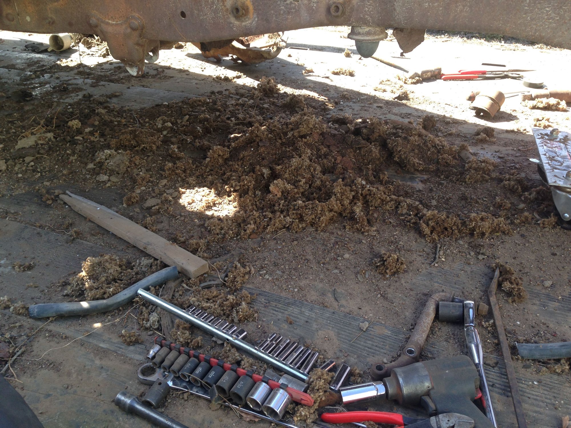

This is the amount of stuff that ended up coming out of the engine.

Homemade bumper. I've heard they were common, almost didn't go look at the truck over it but it's grown on me. Gonna leave it for now anyhow.They also put a piece of 3/16 plate over the wood.That'll probably go.

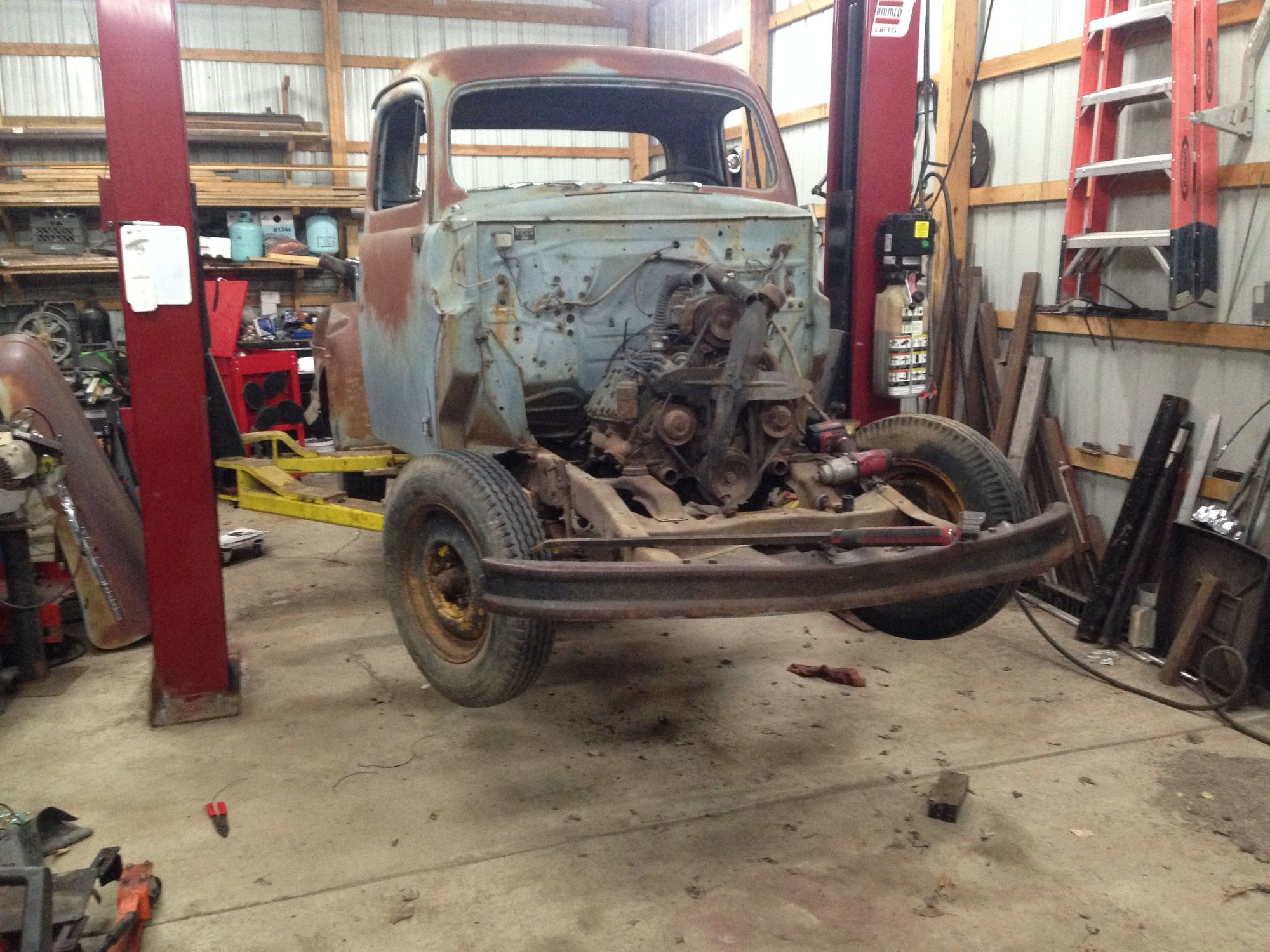

Little bit more teardown and discovery progress pics...
got the front axle I went and bought put in, it's rolling now.
First time on the lift and really spending some time underneath it. Never mind the garage, been a long winter.Definitely time for some organization.

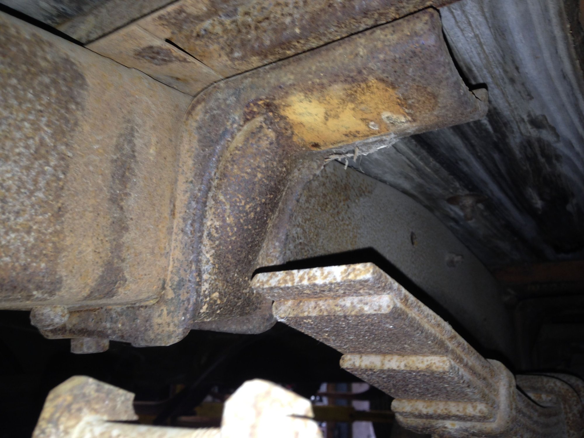

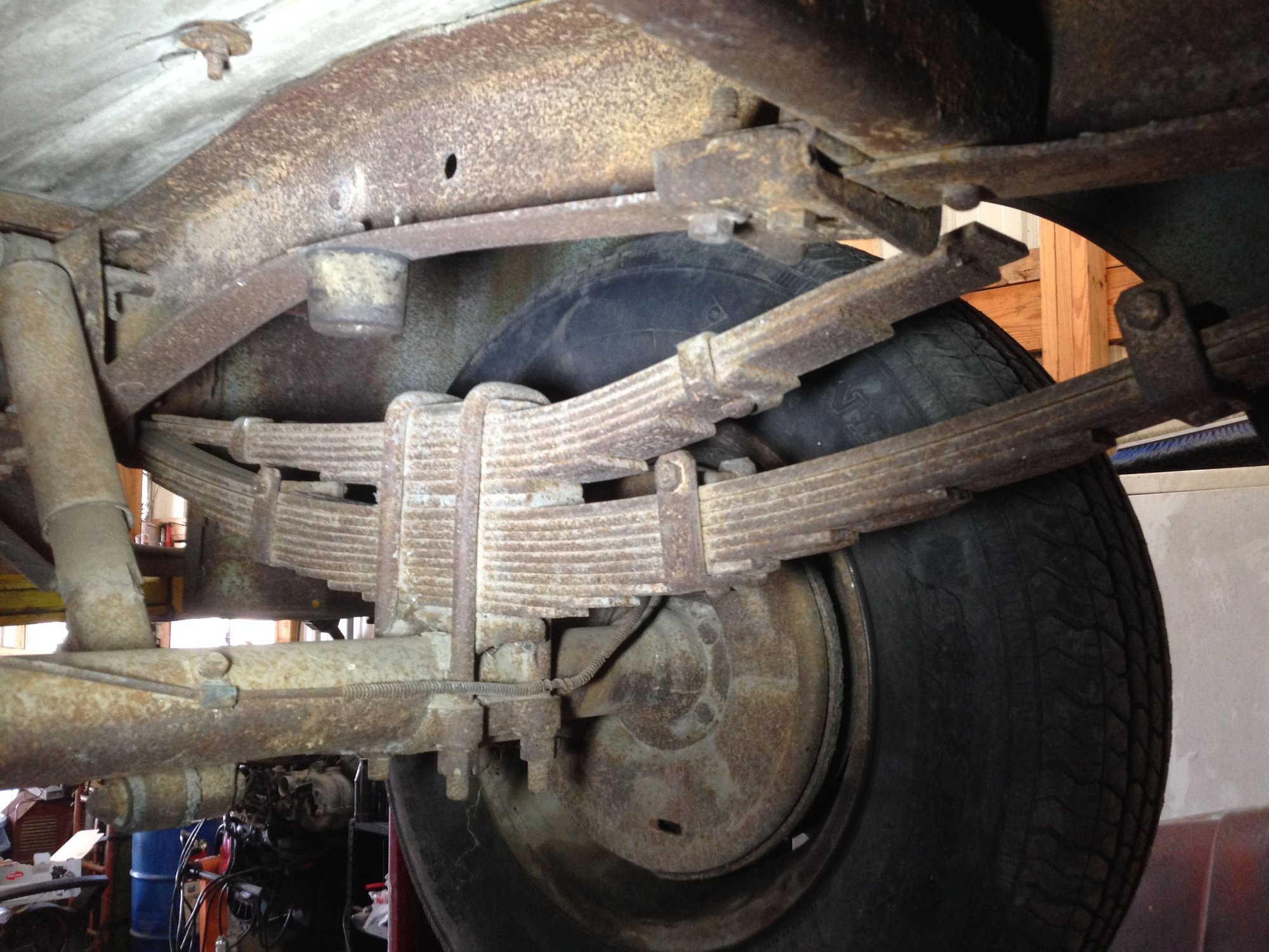

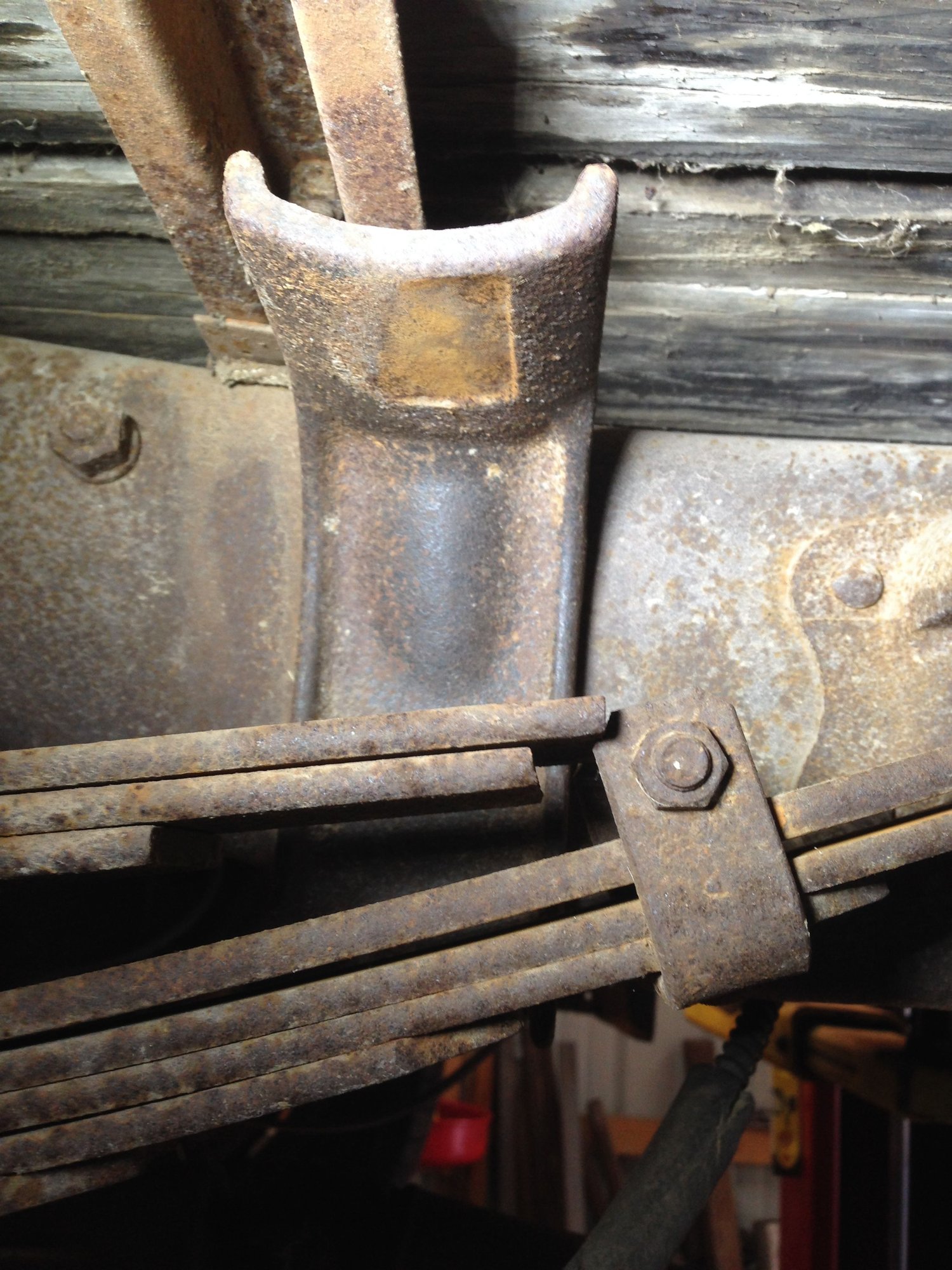

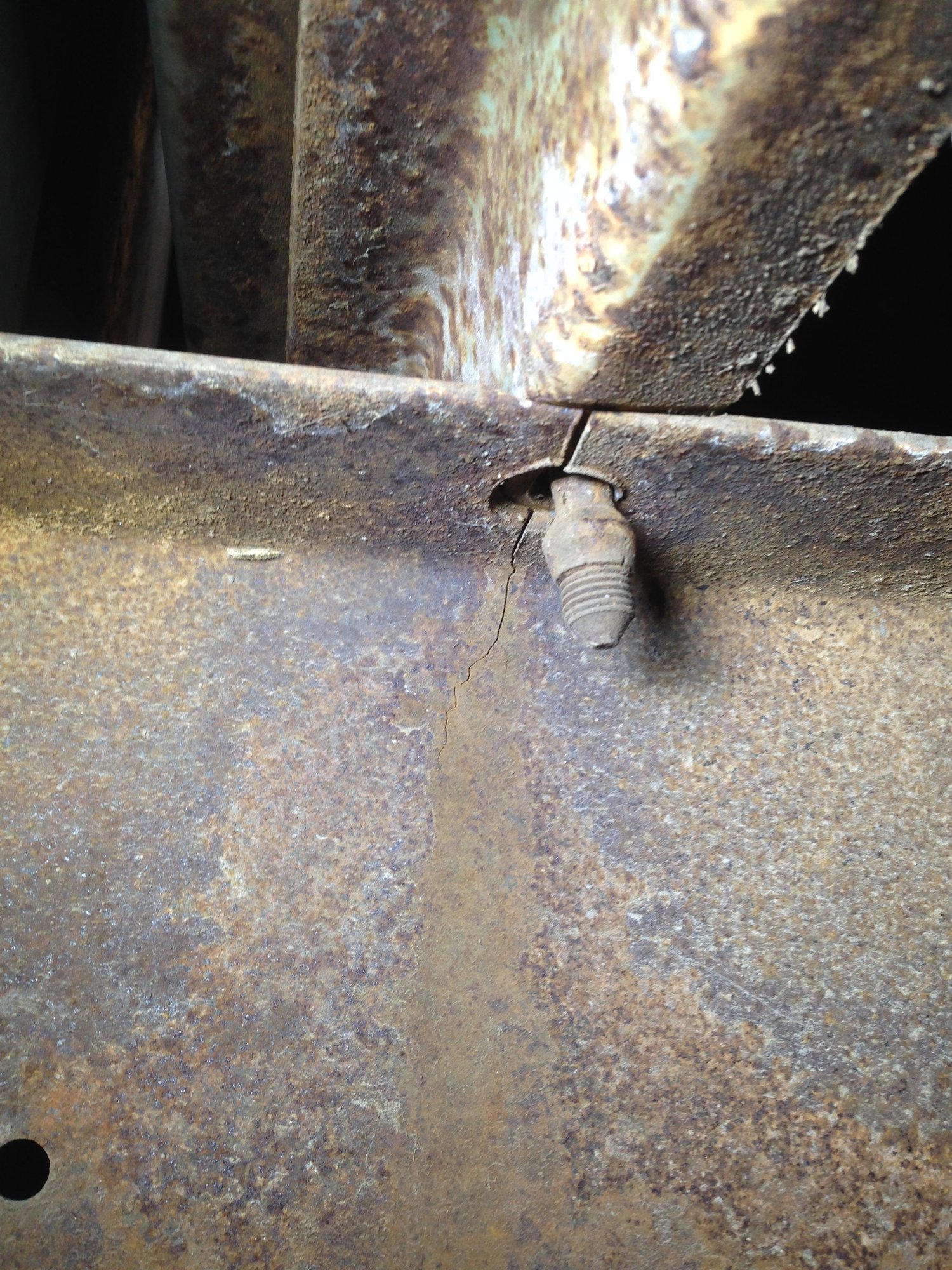

There's no doubt this truck was worked hard. Looks like they added an auxilary leaf pack, even with bolt-on spring stops for the aux pack. It appears they loaded it enough to use them, too. All the bed to frame bolts are loose, there's a pretty good crack in the passenger frame rail at the forward-most bed support. The left front cab mount bracket is cracked up, too.
