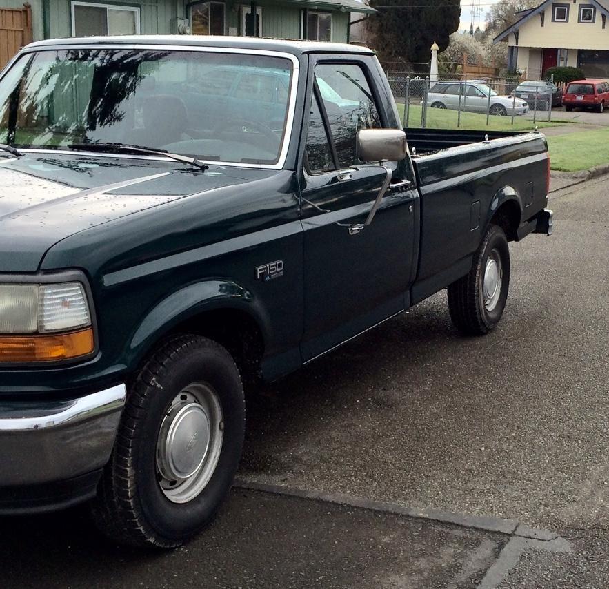

I may have carried too much in my pickup yesterday, a full yard of wet soil for about a 10 mile drive home. The bed wasn't rubbing the tires, but there wasn't much clearance! Once I got the truck unloaded, it seemed to be OK but I can't shake the thought that the bed seems to be riding a little lower now. I have not had the truck for very long so I can't remember what it looked like before
I plan to crawl under the truck today to check things out. Any thoughts on what I should be looking for to see if I caused any damage? Or am I just being paranoid?
Here's my truck now. It's a 1993. Runs really well and I just got it painted.
The truck seems level, but I could have sworn the bed was riding higher before.

I would check leaf springs, shackles, shock absorbers, mounts for shock absorbers, and spring hangers. I doubt you broke anything however wouldn't hurt to take a look make sure nothing looks out of the ordinary and such. Those are the only parts I can think of that would cause it to ride lower.
Try jacking the truck up. I know on my 88 F150 when I got it looked extremely low and after I jacked it up (tires completely off the ground) it looked like it raised itself a little bit like something was sticking.
I have hauled that much dirt wet, cinders, red bricks, and who knows what else in our 86 F150 we use to have a few times and never broke any suspension parts just wore out the truck fairly fast. Suspension was the only thing that didn't need rebuilt on it when I got rid of it.

Thanks - I just looked it over and the springs appear to be intact. Still, gonna take it a little easier with the loads!

99% chance your truck is fine. These old trucks are tough and were built to work and play hard.
I wouldn't worry bout it unless it drives different.

According to my "Pocket Ref" by Glover, "earth" weighs 125 pounds per cubic foot. A cubic yard is 27 cubic feet, so a yard of "earth" would weigh 3375 pounds! One step further, if you accept those figures, a cubic yard would be about 84 bags.
This from Google. Yes if a ton is 2000# than you had over a ton and a half
on board. That's a bunch for a half ton. But it's a Ford so It can handle it
just fine. But I would not make a habit of it. Try a half yard next time or
borrow the FIL's truck. As long as it aint a Chevy.

shackle mounts!!!!! they rote out on these truck had to replace both of mine is sucks but they look fine sometimes but they could be scerwed so look closely.

Take a good look at the spring eyes. I'd say it's probably fine, but a yard of wet dirt is WAY over what an F150 can handle. I'm surprised the yard let you get that much.
