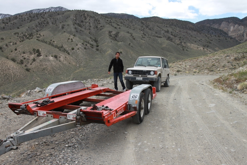

Just for reference, even the aluminum U-Haul car transporters (not the dolly) is about 2,300#. And they are basically two tracks on two axles.
But yeah, I also vote tongue weight. I haven't had a real need, but I was going to try the bathroom scale method of tounge weighing if I'm feeling mathy.
