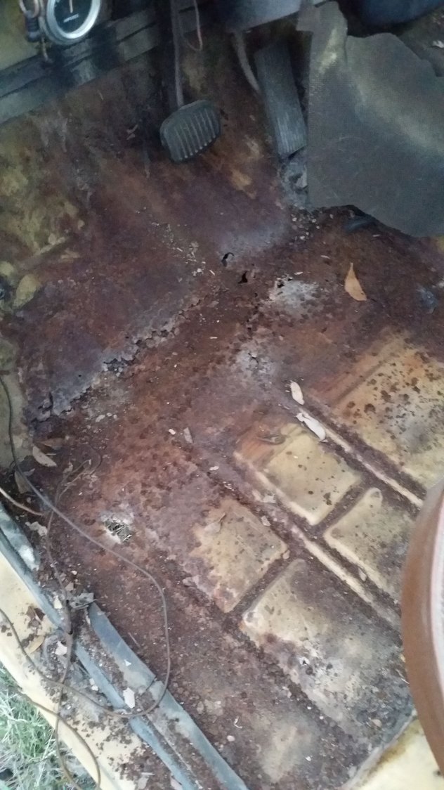

I pulled the rubber mat out of my donor cab and found this!!! I guess I need to patch some rust...

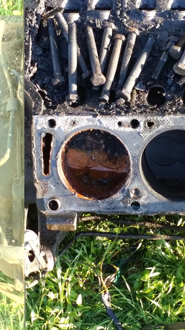

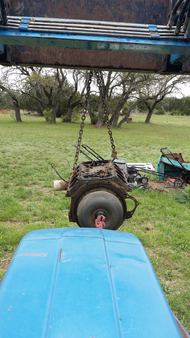

Original 360 off my SB. Pulling apart to see the damage.
Front 4 cylinders were frozen from water, and the block will need a bore, so to the scrapyard she goes!

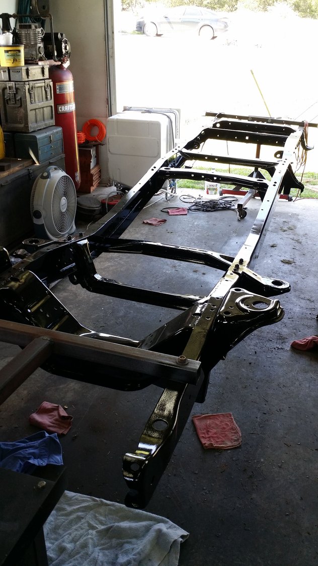

Got a few more suspension pieces coated this weekend too!

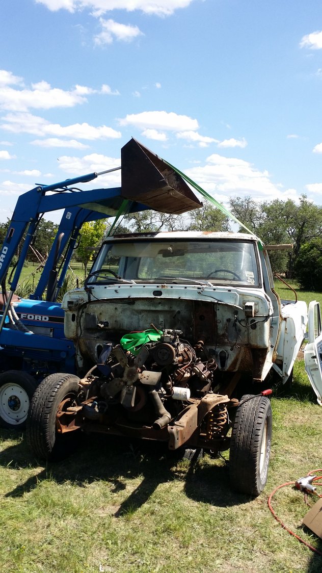

I got my donor truck pulled over to the shop so I can get the engine out of it. Should be out in a few weeks and we can check the damage on this one...

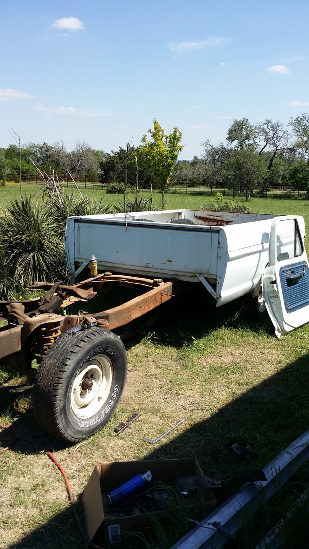

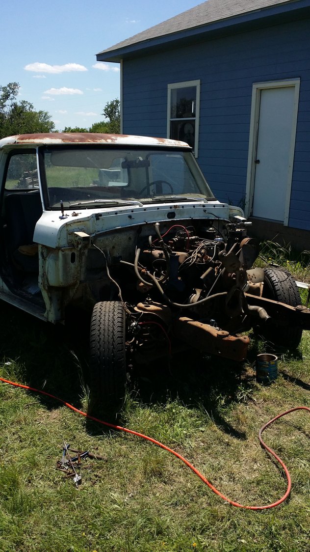

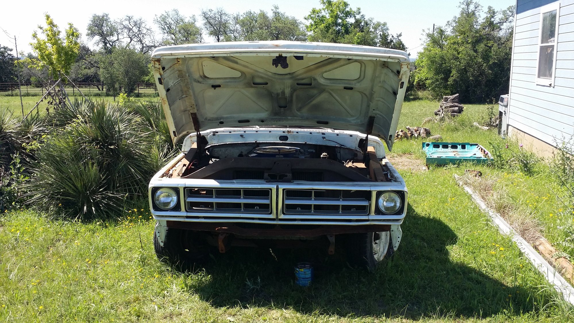

This weekend was the end for our parts truck. In 8 hours, I managed to get the entire truck apart and scrapped out for my build.
Before:
Missing a front!
Cab coming off:
The whole reason I parted this truck out. Here's the 360 in all its glory:
That was all for day 1!

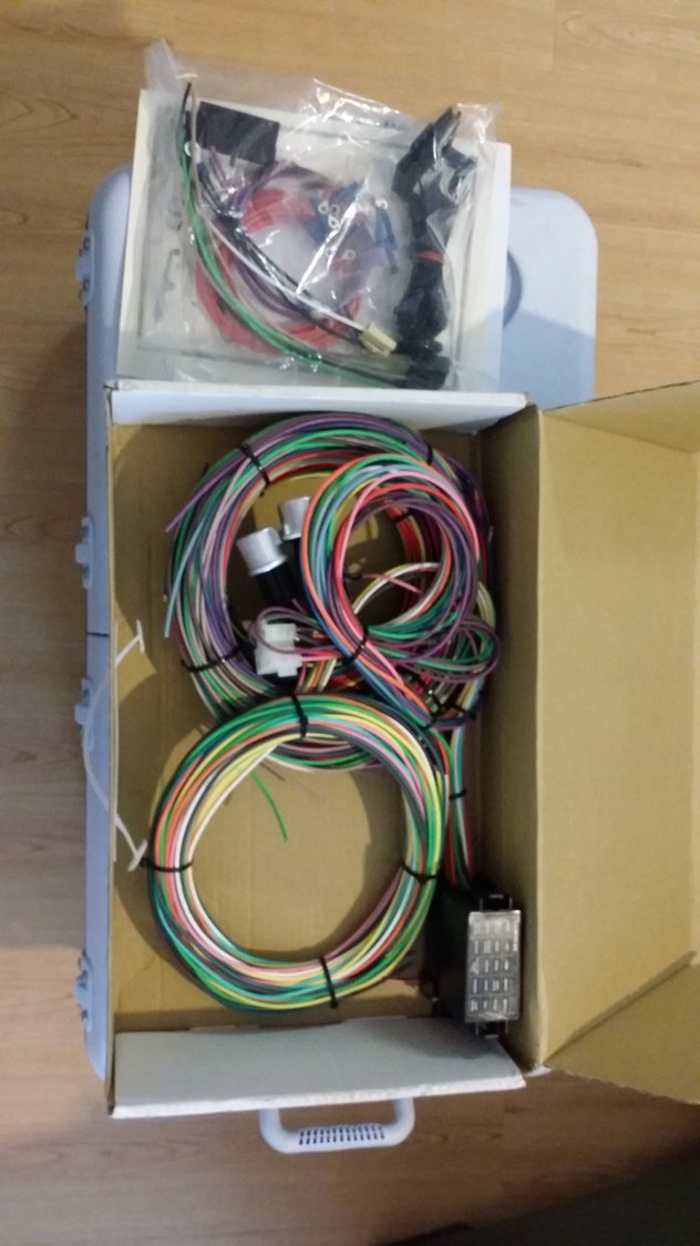

After much thought, I decided to replace the old wiring with an EZ Wiring 21 Circuit kit. This will allow me to bring the bump into the 21st century with power windows, locks, cruise, 3rd brake light, etc..

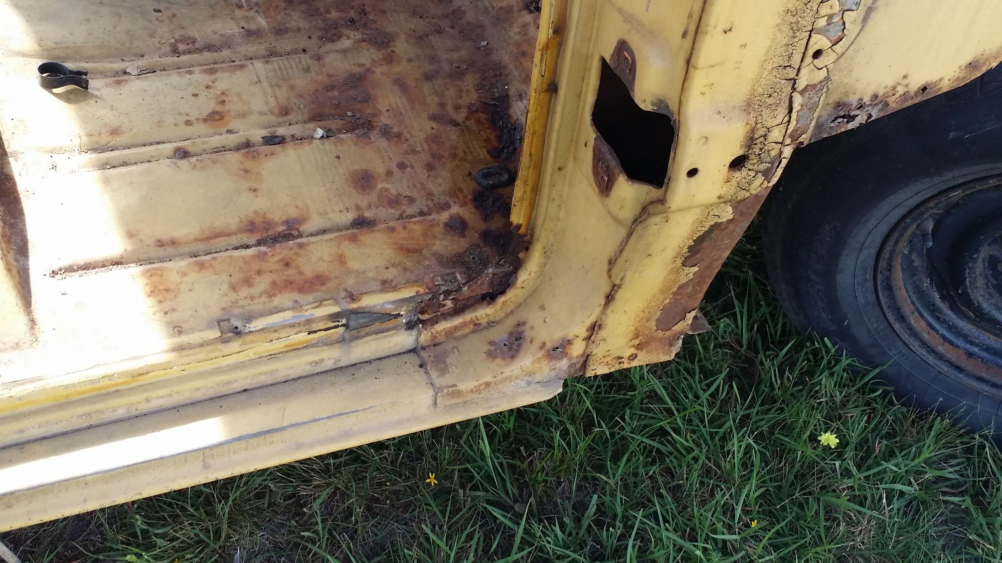

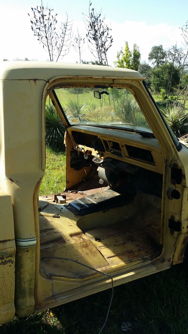

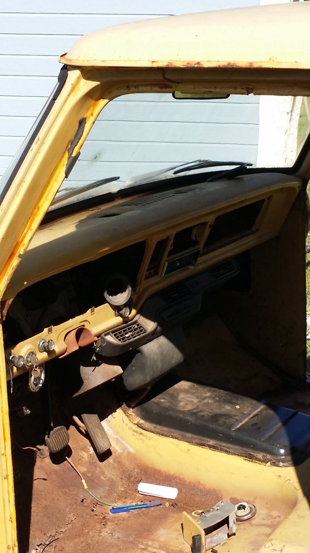

We got the donor cab stripped down and ready for rust repair:
Unfortunately, I found a lot more surprise rust in the usual places.
Like cowl rust!
And in the rocker panel
