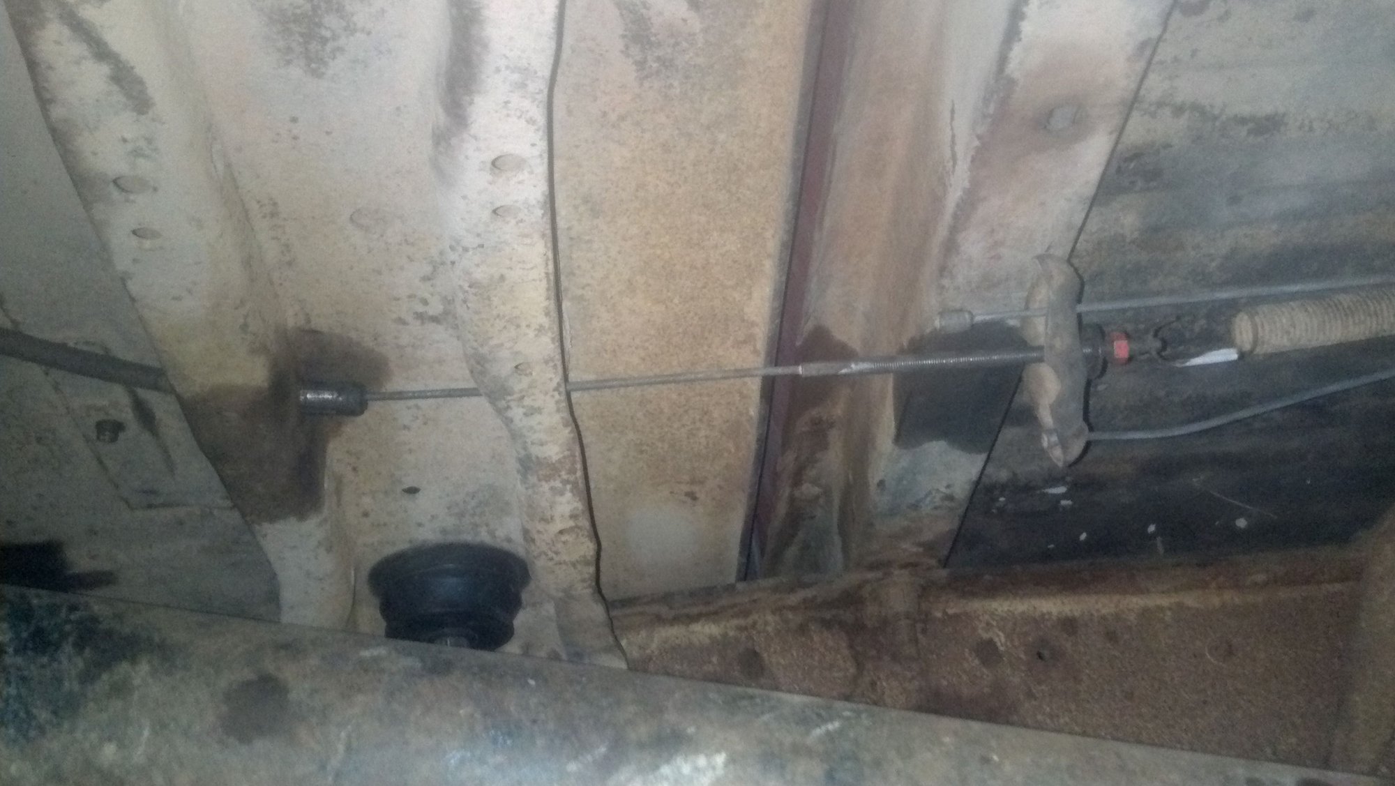

Can someone confirm that the longer cable goes on the left? Im adjusting them and the equalizer bar will sit ****-eyed by 3 or 4 inches, dont know if the PO ever had them out and switched them.

Pics are worth 1000 words, this is a short bed btw

Its just a regular ole cab, and the second pic shows a transfer case and the bottom of a front pumpkin.

so anyway....assuming that the cables are on the correct side, why is the equalizer not straight? Ive seen some pictures here where they are and some where they are not.
