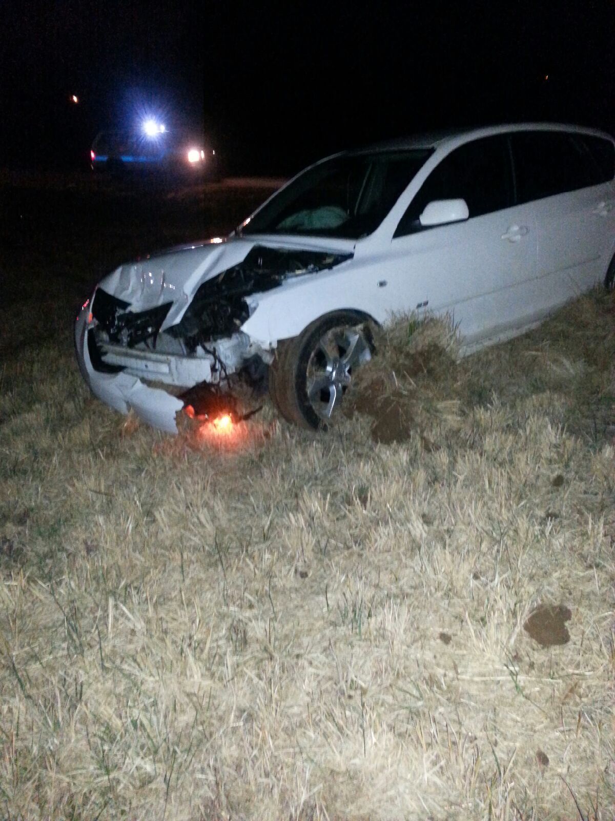

I will be removing all cladding from the Excursion, and going to spray Scorpion XO2 liner and I got it tint in Ford paint it Code H5 Caribou, and got new fender flare set (XENON 8640). So I will be spraying the rockets and flares and bumpers and will be replacing rear bumper. This is because my wife got rear-end back in February around $2000.00 damage to the excursion. here some picture of the Mazda that hit her.

Mazda3 fail sauce.
Glad it wasn't worse for your wife or your rig bud. Looking forward to finished pictures!

Yes I know she had the cruise on 70, was in the slow line on I40, he hit them so hard she loss control for a bit, and end up in the fast lane. And I will add pictures when I get it done

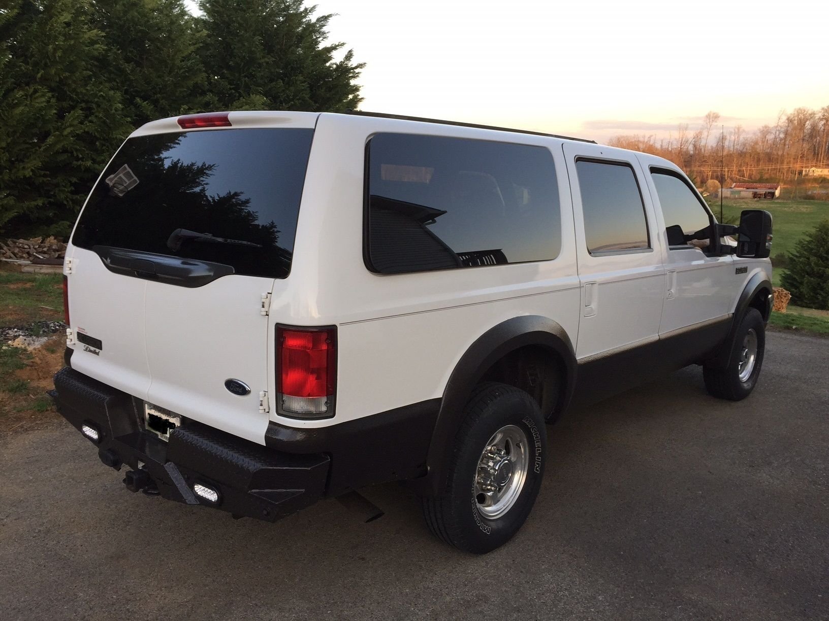

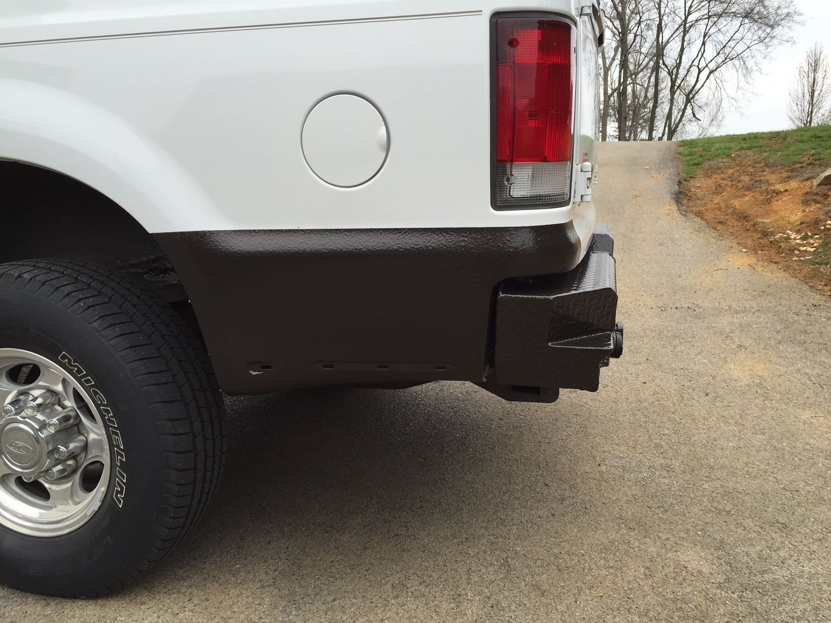

Here’s some new pictures with the Froniter gear bumper 100-10-8009 its F250 2008-15 bumper. Had to cut 6.5" off the mounting plants and 1.5 off the top L that goes against body and drill new holes

Pick up some XLT stone deflectors to cover the mounting holes aft the rear wheels.
Looks nice.

Looks great!

Looks good!

Thanks
Yes I need to get the stone deflectors.

I like it. I like those steps on the rear bumper too.

Hey jachiggie,
Nice work!
What type of bumper is that? I've been looking at Ranch King but didn't like the look of the front bumpers with the big brush guards.

That looks nice! Any plans to paint the bottoms of the rear doors?

Read man, read! Lol.

HAHA! Fair enough! lol
Totally missed that line of text between the pics. I blame it on sleep depravation!

Yes I plan do the bottom of the door too, am waiting to get the front bumper then do it,
I will add some pictures of the mounts I cut off and were I drilled the hole.
here a link for the bumper Froniter gear 100-10-8009
