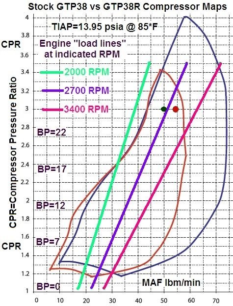

Here is a graph (thank you ErnestEugene) comparing the compressor maps of the GTP38 and the GTP38R. The brown operating envelope is the stock GTP38 and the blue envelope is the GTP38R. For now, don't pay attention to the RPM lines.
Stock GTP38 max's out at @ 60 lb/min
GTP38R max's at @ 72 lb/min

375 rear wheel HP goal
assuming this example is at sea level (14.7 psi) and our max boost goal is @ 30 psi.
To obtain 375 HP - you will need about 50 lb/min air.
pressure ratio = 30(boost)+14.7 (pressure)/14.7(pressure) = 3.04
400 rear wheel HP goal
To obtain 400 HP - you will need about 53 lb/min air.
Plot these two point on the graph and we get the green dot for 375 hp and the orange dot for 400 hp.
As you can see the modified stock GTP38 can handle the task but is quickly reaching its envelop limits (brown line). The closer the plotted dots move up and to the right of there envelope the lesser the efficiency (and more heat ). The 38R can handle the task at a lower position and more to the left in it's operating envelope. Basically the closer to the center the more efficient.
This is just some ballpark calculations, there is much more to it - but this will get you close enough to make an educated guess. Both turbos can handle the 375-400 HP task, one just does it more efficiently (and with less heat) and leaves room for upgrades in the future. But is it worth the additional $$? That's your call.......
