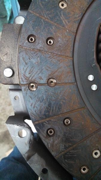

It doesn't seem to be slipping and I haven't noticed a difference in shifting, but I have no clue how many miles are on the clutch, when I had the engine out 38k ago, the clutch looked a little beat up. Or at least I thought so, this being the first time i had ever seen a clutch plate in person. I completely agree with you on the why not theory of replacing the clutch, but I'm not sure if the cash is around for it at this time.
What do you think of my clutch? Those pictures are about 38k old though. Also, if it is in fact the bushing that you suggested, how long can I drive on that?
IMG 20131225 221459 801<br/>Entire clutch plate, 12/25/2013
IMG 20131225 221508 629<br/>Closeup of my clutch 12/25/2013

I don't know why those pictures won't blow up for me. When I click on them, they actually get smaller.
Anyway, from what I can see, that clutch disk looks to be on it's last leg. Not much meat left on the pads and is that wear on one of the rivets from it rubbing?

Chris, thats weird about the pictures, not sure if it helps but they are in my albums. If that clutch disk looks on its last leg here, I'm sure its on its last toe now. Darn thing, one thing after another.....
