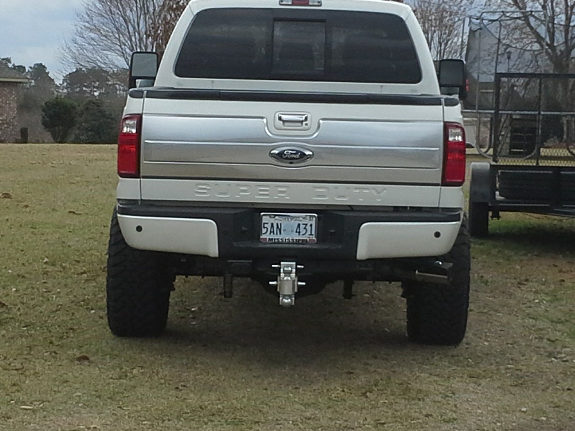

Not sure if this will help, these are 35x12.5x20 ( rims are 20x10) with a -19 offset. Not sure how much they stick out exactly, haven't bothered to measure.
Not the best pictures in the world, sorry bout that.

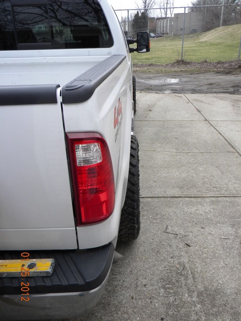

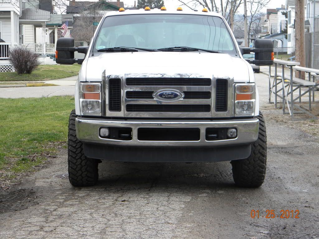

Here is my setup. 295 70 18 on -12 offset 18" wheels. They stick out 1-1/2" in the rear and 2" up front. I added the flares and they keep most of the dirt and rubber off of the body.
