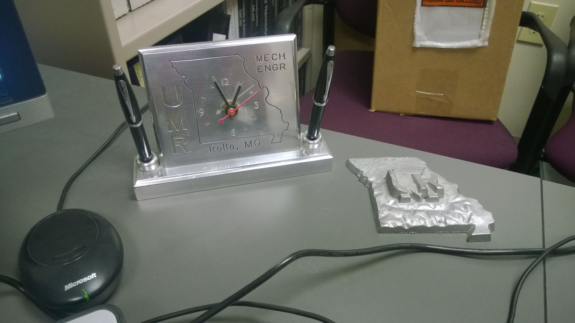

Yeah, that's good! We had a manufacturing processes class where we did some machining, casting, and welding in a lab portion. I still have the clock we machined and a little piece we cast sitting on my desk at work. Didn't keep anything we welded - it was just scraps. That class was fun.

That clock is awesome! I'm hoping for my individual project to cut out my wedding ring on our cnc lathe, then send it off to have it blued (think shotgun metal). As for the mascot, yours probably came first. I know we ripped off our fight song. I wouldn't doubt we stole a mascot too We go by hardrockers though, not miners.
