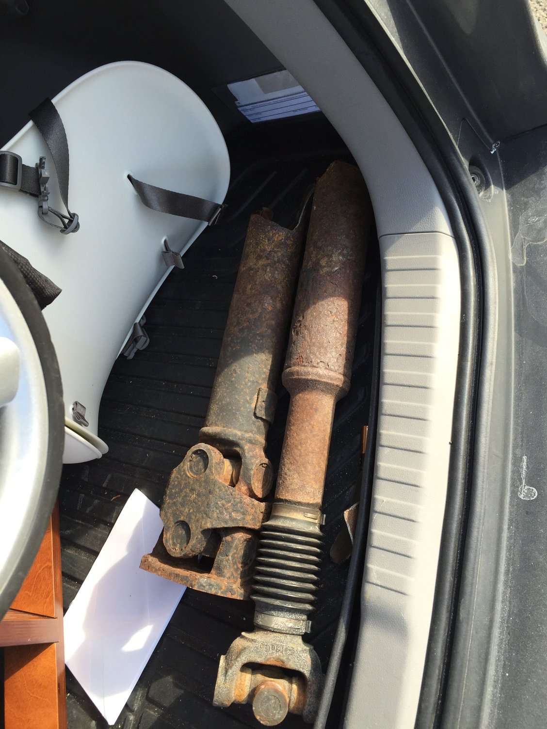

Old Feb 25, 2015 | 08:45 PM

Wow. What as the condition of the U-joints? Do they still move normally?

looks to me like it rusted enough to fail.

I agree. That is pretty bad corrosion. Good thing it didn't let go at speed.

The front most U joint went. That's what cause it to bind and twist like a soda can

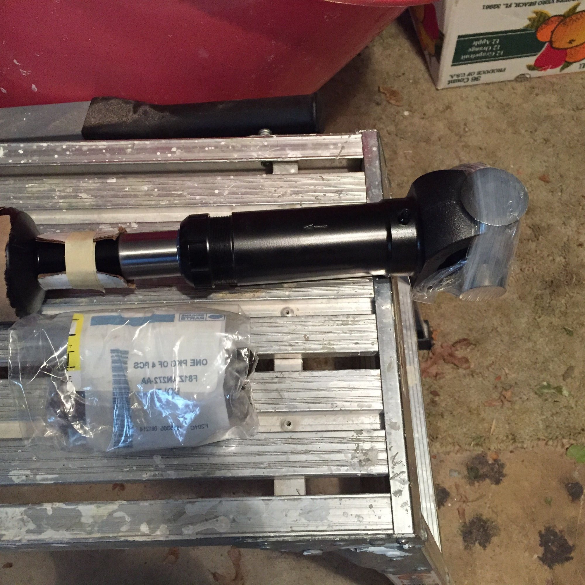

Picked up the new drive shaft. Thing is solid. The guy said he did about 20 of them in the last week and was on the phone with another broken one while I was there. Here are some Pictures. Of course it's snowing now so I can't get it in.

Looks nice!
Driveshafts aren't too bad most of the time. Had a steel shaft fabricated for my Lincoln last year and paid $300 for it. Much cheaper than lots of other stuff that can break on these things!
