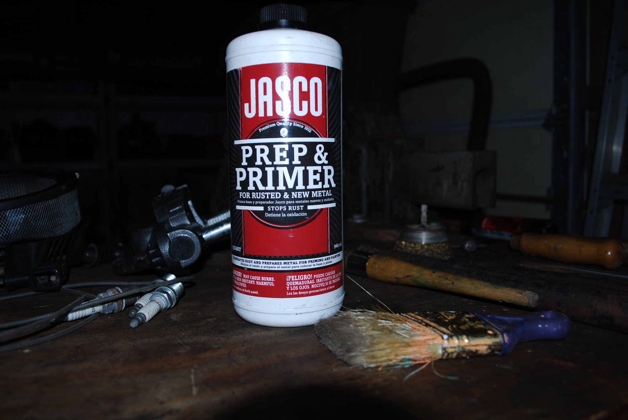

If you want to chemically change the rust and get rid of it completely use Jasco rust treatment. I used it on my whole frame for my F-6 and what will happen is the rust will chemically change into a white powder or a black tarnish that you can wire brush off, then clean the surface with some degreaser or equivalent then dry and apply paint or primer. Using Jasco you pour some out in a bowl and take a paintbrush to coat the object and let it evaporate and dry on it's own preferably not in the sun or with a fan. Hope that helps.
