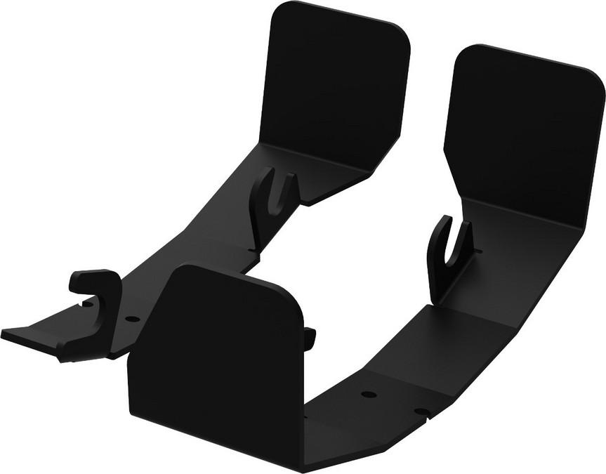

Update - I might be getting somewhere. I found an On-line store called Truck Hardware.
They have what are called "brake caliper guards" So i looked up my 2006 F-350 and came across these guards. They are not exactly the same as the ones I have but are close enough to determine that they are indeed caliber guards. Their site shows how they are mounted also. They were asking $115.00 USD for theirs.
I'm heading to the shop this afternoon so I will try to mount them. Thanks to all who contributed & I will update after the install. Cheers !https://www.truckhardware.ca/images/...jpg?1409020842

They mount on the caliper bracket. They're for calipers mounted in front of the axle, to protect them from road debris. I didn't think they were on 2006 trucks. Is that the original axle?

You are correct on the caliper bracket but my calipers are mounted on the backside of the axle so they actually mount on the caliper bracket behind the axle. I think they would still do a good job protecting from road debris & what not. And yes as far as I can tell the axle is original. I wasn't very accurate with my original thought that they were mounted on the front side of the axle. Thanks for your input & comments.

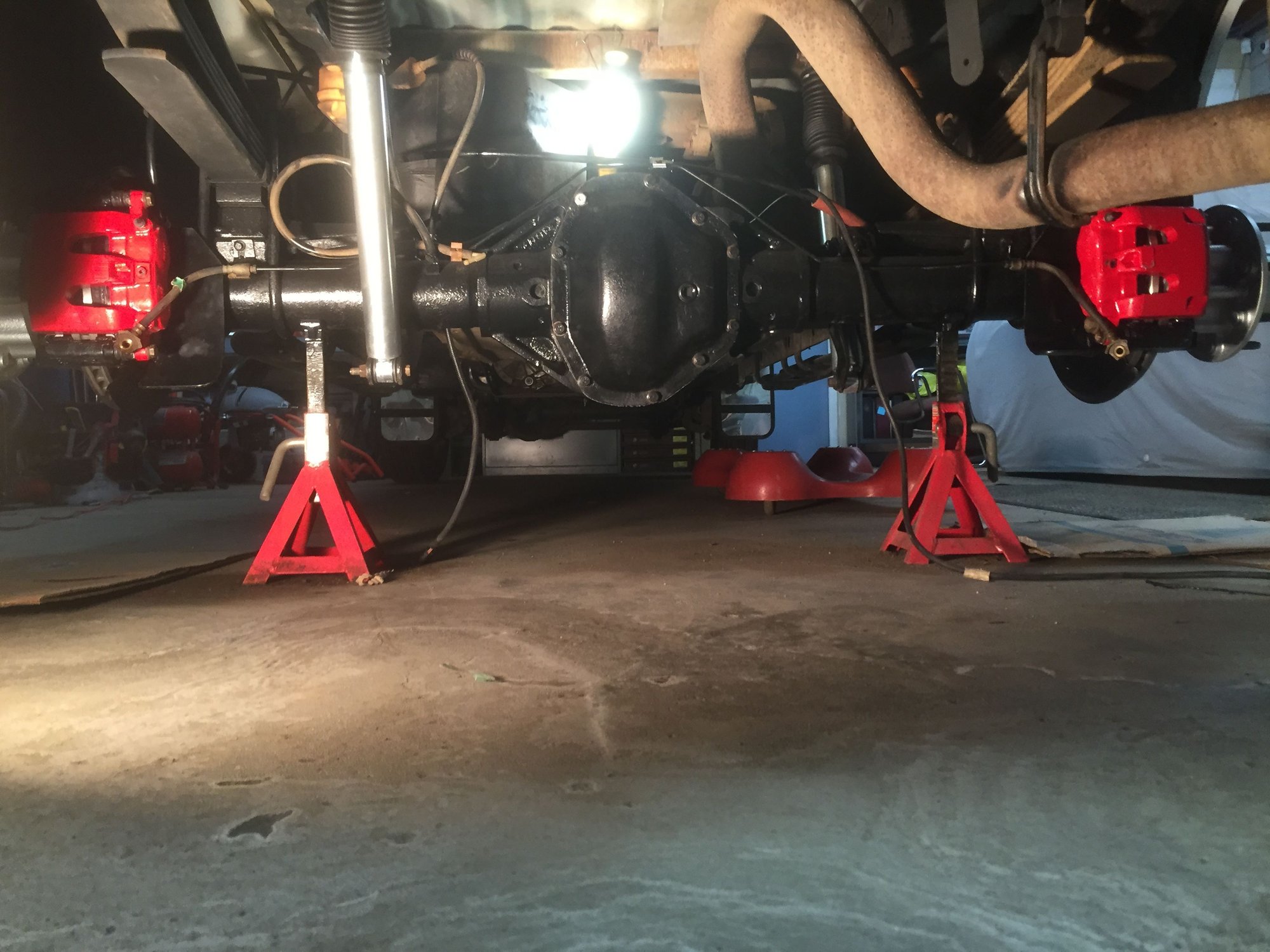

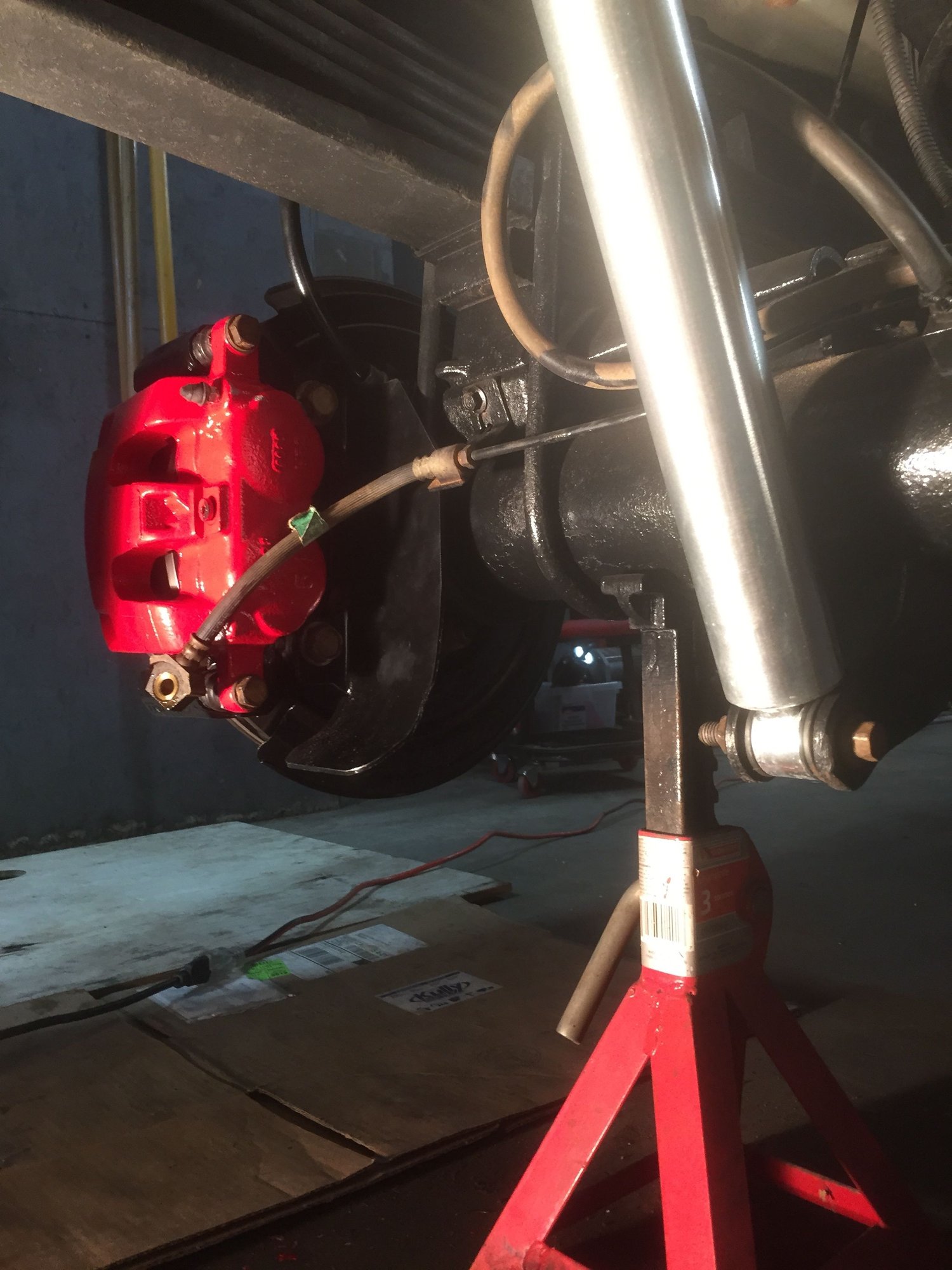

Ok Thanks everyone, I got them mounted this afternoon. It was an easy job once I knew where they went. You guys Rock !!
Here are a couple pics of them installed. Brake hoses are not connected to the calipers yet because I am replacing them both.
Right side - Rear
Left side - Rear
Entire axle assembly from rear
