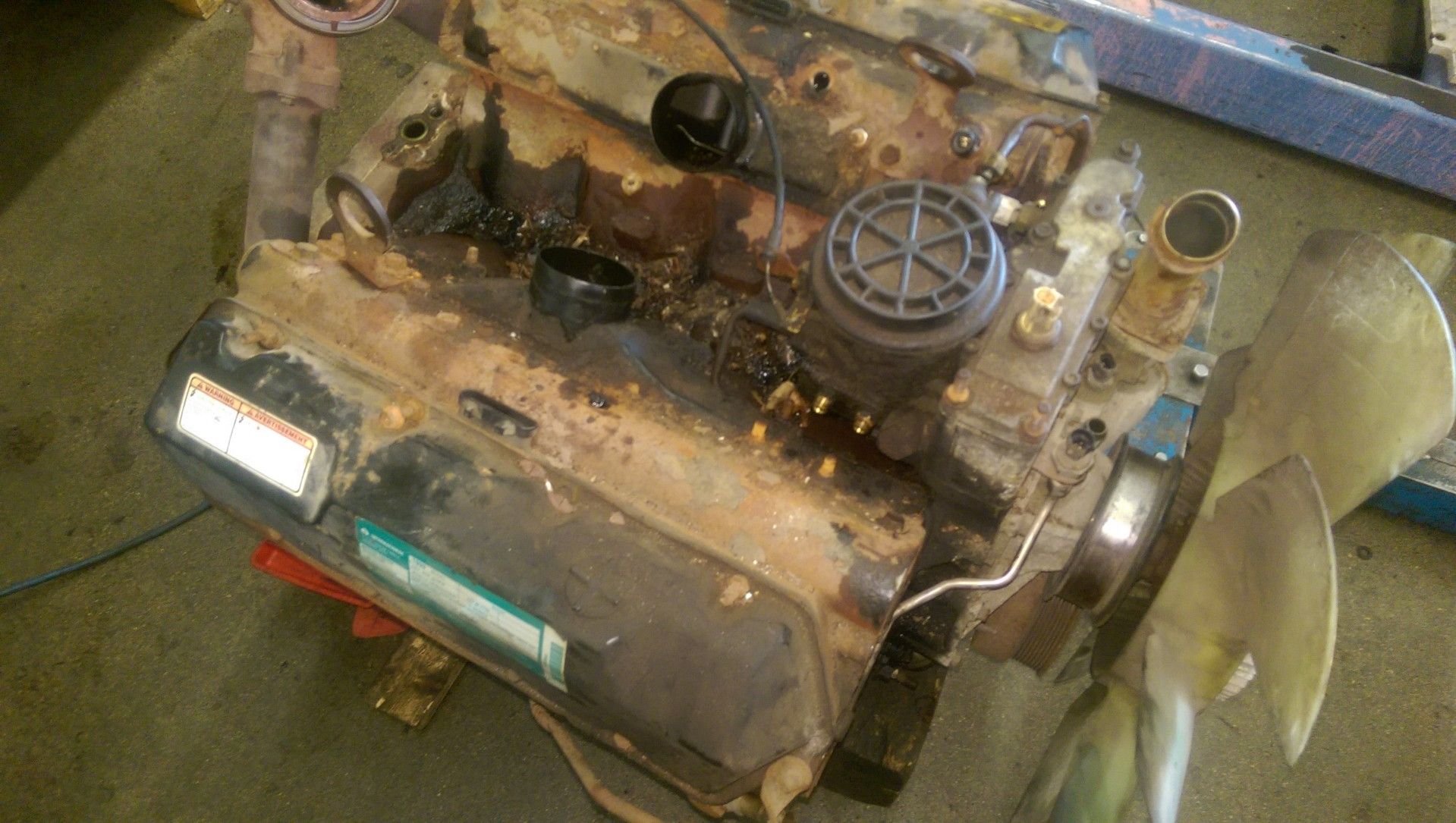

Well, I do believe it is my time to "shine" per say. I have been given the amazing opportunity to tear apart MrCarlsonq's 7.3L Powerstroke for school and to do him a favor and to get his motor freshened up. At this point with the pictures, I have simply received it at where I'll be working on it and have taken many, many, many pictures, here's two of the best looking overall views of it. At this point I've had the motor for just about a week and have been working on it each day.

Add on to previous post of mine: Fan is also removed, you can see from picture, just forgot to state as much too

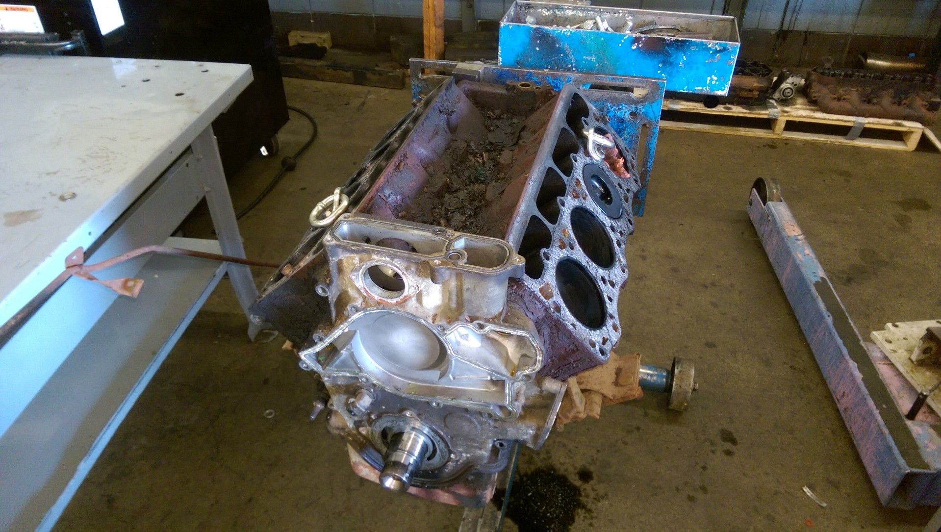

Here the engine, now light enough, is mounted on an engine stand (had tried before but the engine wanted to bend the front down to where it would've snapped the bolts off)

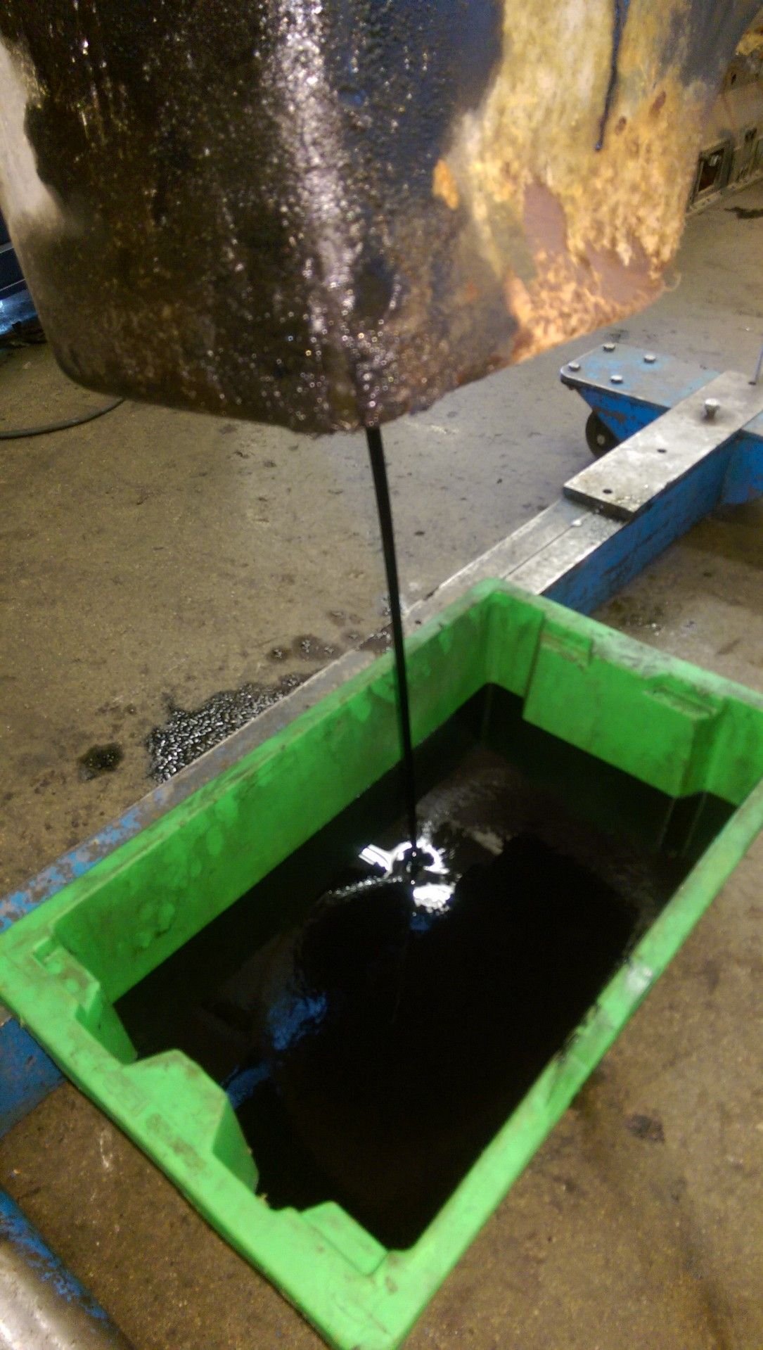

Draining the oil out of the oil pan
Oil pan is now removed, made a bit of a mess on the floor from the coolant/oil from tipping the motor to gain access to the bolts for the oil pan

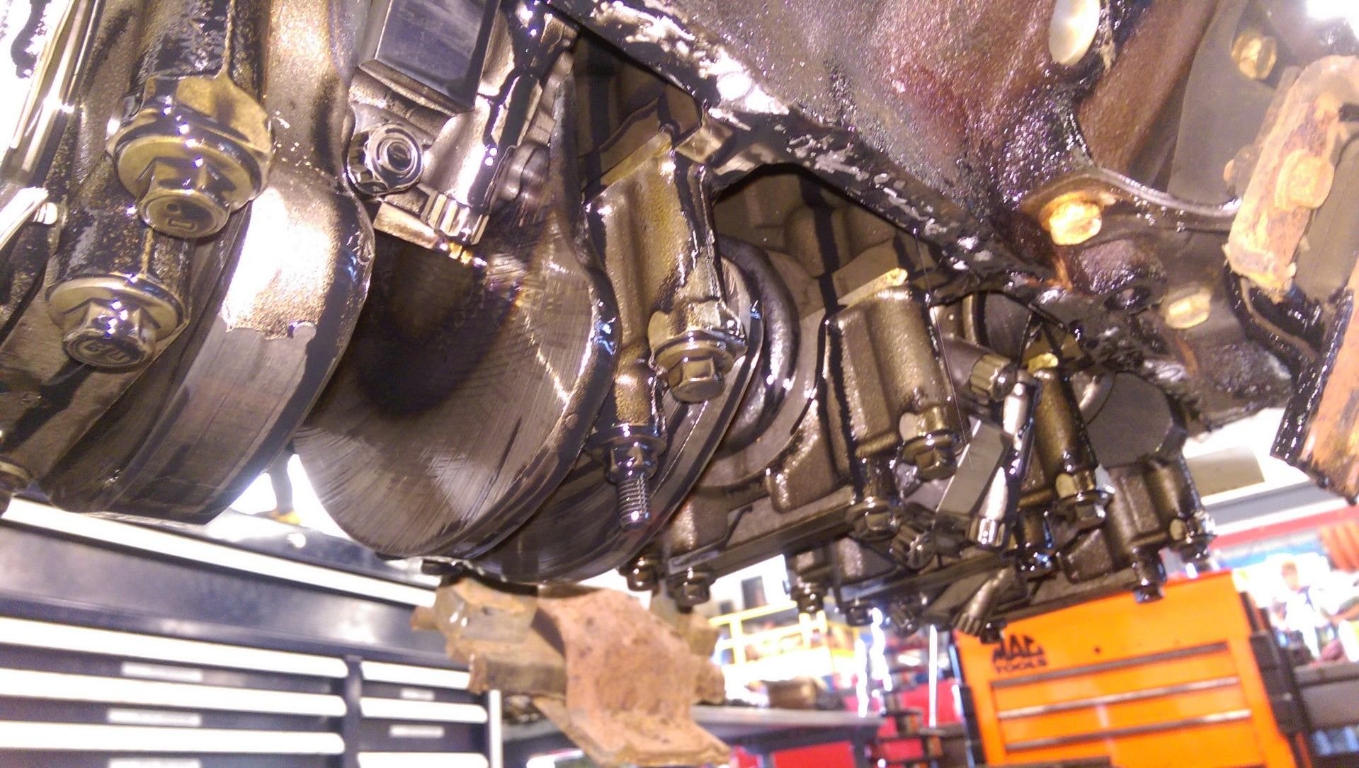

Taking a quick look at the crankshaft to see how it looks, obviously won't know more till it's removed from the block
