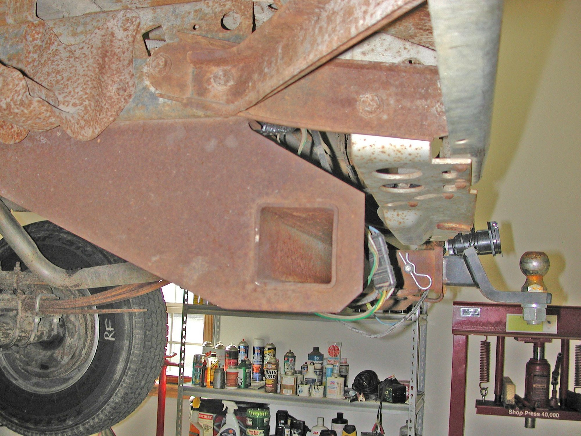

Here are a few pics to explain my thinking, the ugliness of Dad's/Rusty's hitch, etc.
First, here's a couple showing how low it hangs:
Then a couple showing how it bolts on and how it is made:

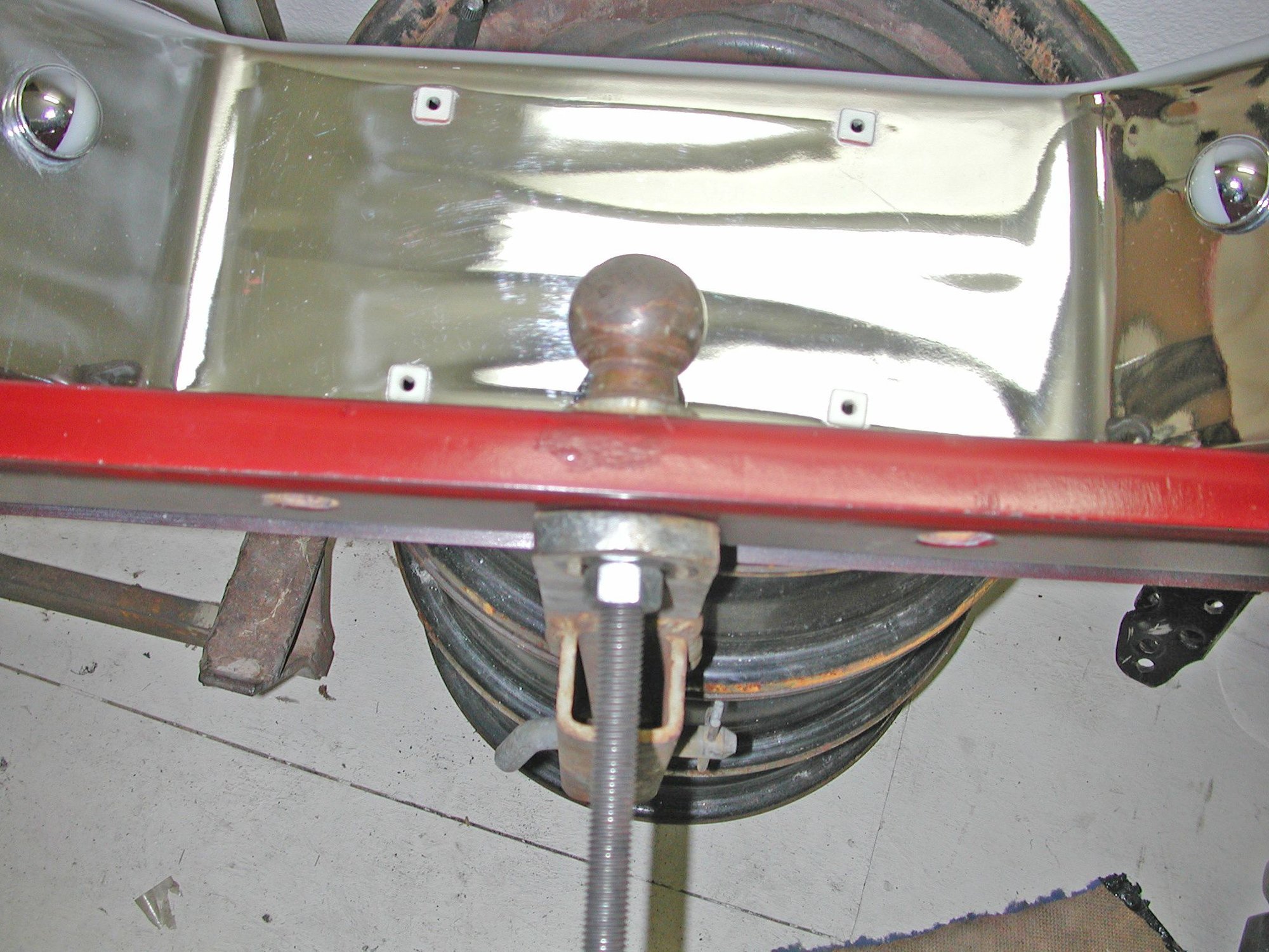

And, now for my thinking. These pics show the bumper that is going on Dad's truck when it goes back together. (Jer, you might recognize it?) If you note in the pic above the bumper on Rusty has a significant dropped area just in front of the hole for the ball, while this bumper doesn't have that. The point is that some bumpers may lend themselves to this approach and some won't. Anyway, my thinking is to raise the hitch such that the drawbar will match up with the hole in the bumper. Drop the ball through and you'll have a really stout hitch that won't be seen.
However, that means that on Rusty the ball will be 4 1/2" higher than it currently is and that may be a problem. So, Plan B might be to position the hitch such that the top of the opening for the draw bar is 1/16" or so below the bottom of the bumper. That would allow a draw bar to be inserted but hide the hitch as much as possible.
Anyway, Jer is right, I'm thinking about it.
