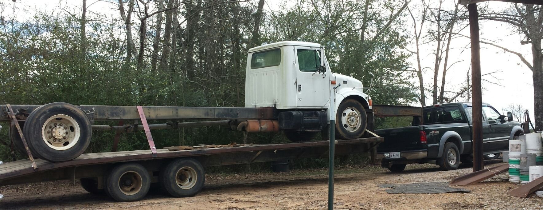

You will be fine I tow a 14k 24 foot gooseneck all the time.
Don't know the pin weight but not bad. Now this tow was a anther matter 35 foot 10 ton
