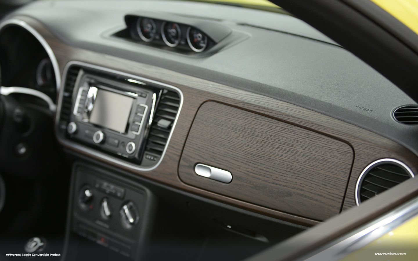

Gary,
These guys did it already. This is their link. It is not ford, but the same idea.
VWVortex.com - VWvortex Beetle Convertible Project

I showed the 3M sample to my wife today, along with the original radio bezel. She really likes the 3M Rosewood.
And, here's the one Kyle found....

That dash including the top of the doors, is a smooth gloss.
i think the 3m looks really good, but wonder if dust accumulates in the grooves.

Maybe, but a wipe-down with a cleaner should work - although not Windex as they say it softens the adhesive.
My pictures showing the grain were taken up very close, and the grain is not nearly as visible to the eye as to the camera. I think the Rosewood is a good match and will give the dash some depth that the factory stuff lacks.
