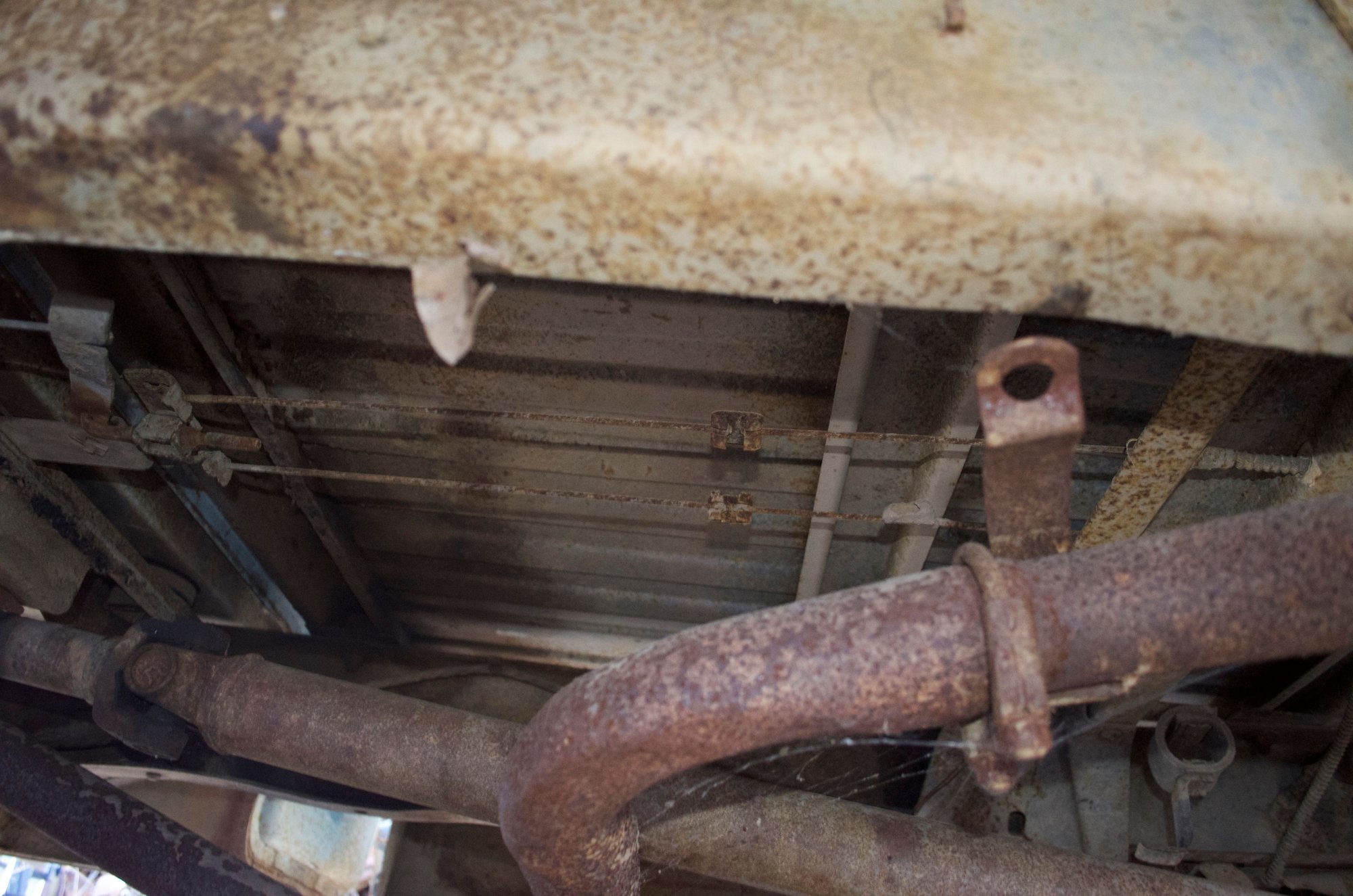

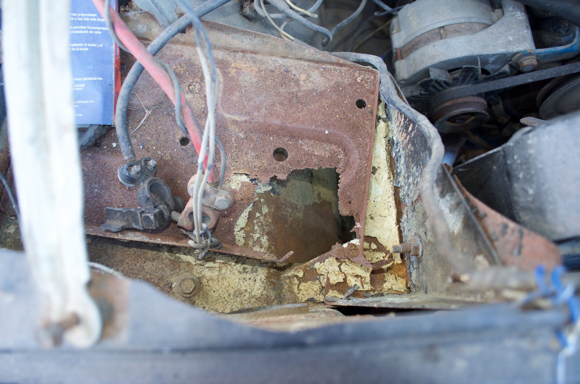

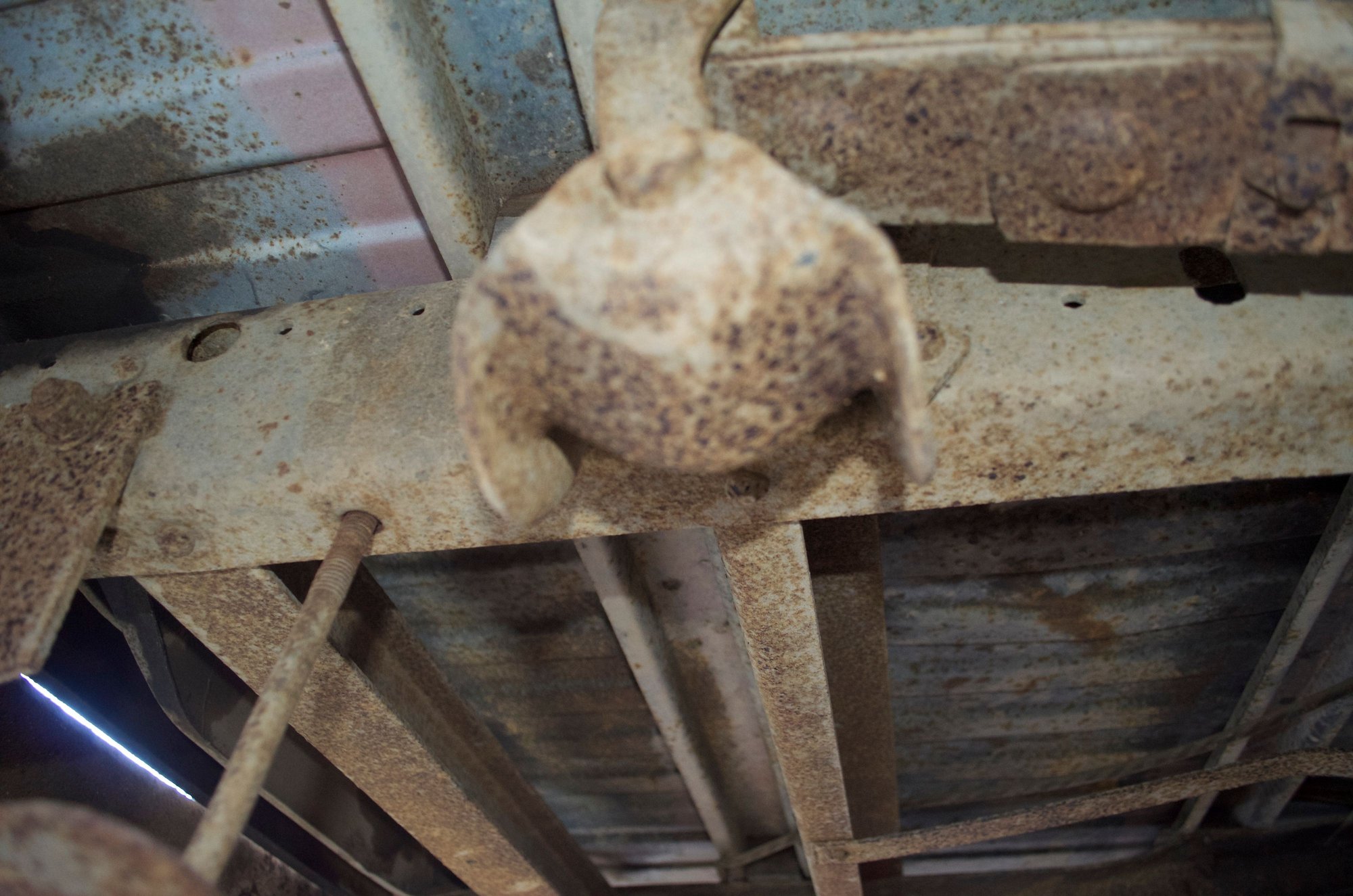

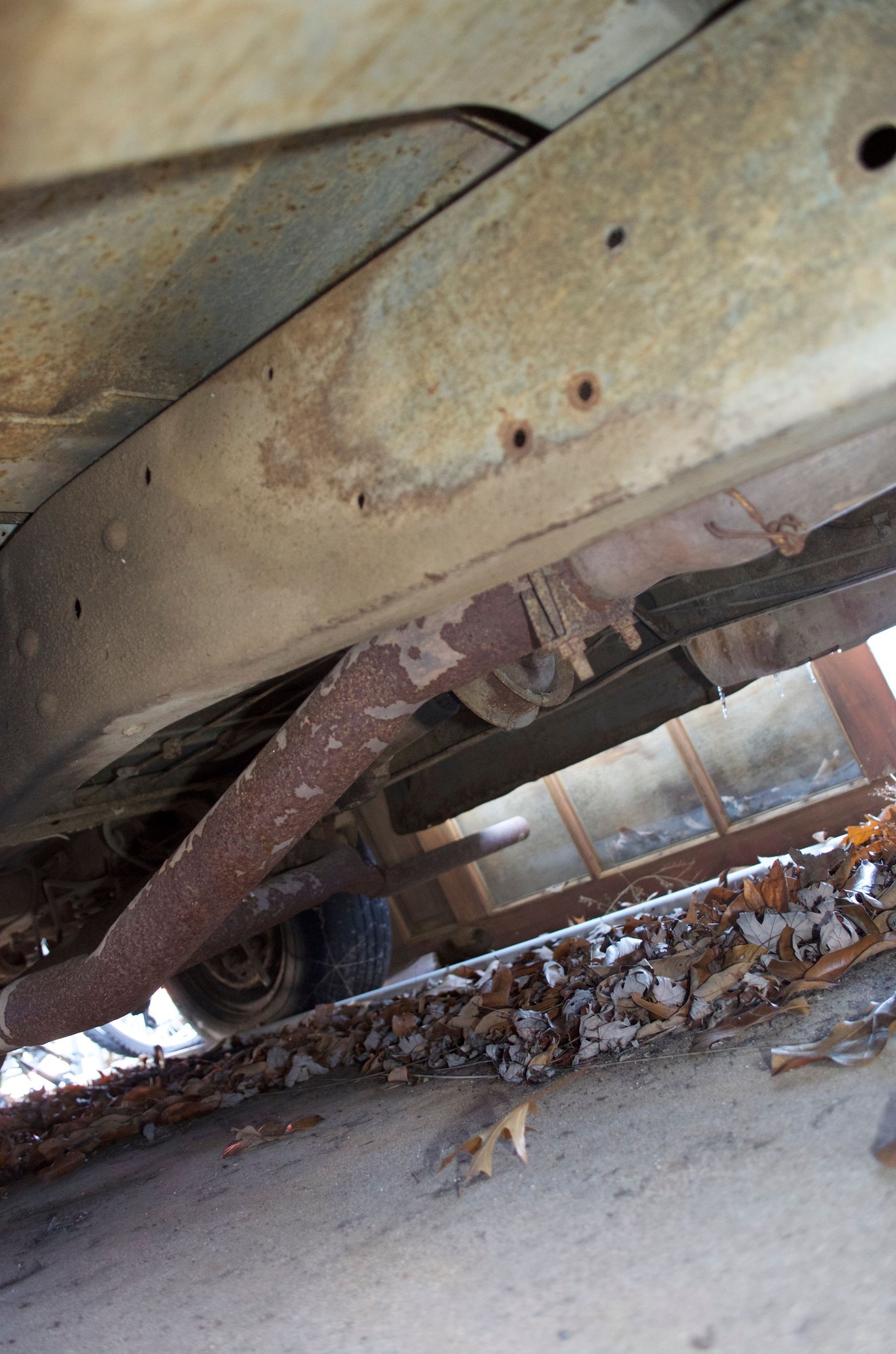

Can you post some pictures of these areas? We can help better determine your rust problem.
Front cab supports
Core support - from under the fender looking forward, battery side
Lower cab pillar where it joins the floor, beneath the door hinges. Both sides
Backside of the brake backing plate, if that is your big concern.
Floor pans
Anything else that concerns you.

Surface rust, like what you have on the frame and all over, can easily be removed with a wire wheel on a drill, or sandblasting. It is still time consuming.
Cancer repair is much more difficult, time consuming and expensive.
Looking at the amount of pitting on the frame and rear axle surfaces, I suspect you will find a great deal more of rust repairs in the sheet metal as you disassemble the truck.
Snapped bolts and spinning nuts will crop up quite a bit if you intend on doing a cab-off restoration.
If you are committed to this for the long haul, the '65/'66 trucks are the most desirable for restoration, but it will take a serious amount of commitment and money to "restore" the truck.
My suggestion would be to drive it for a while, and do upgrades like power steering and disc brakes, while you decide how much you can put into it to make it look nice.
