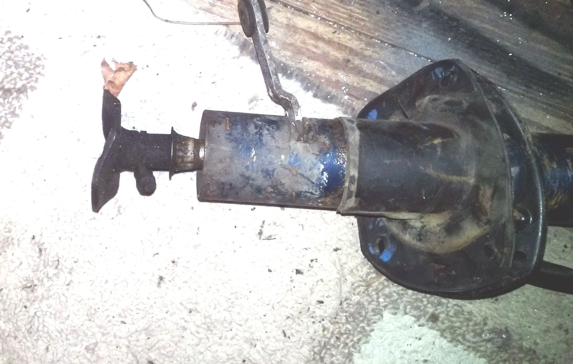

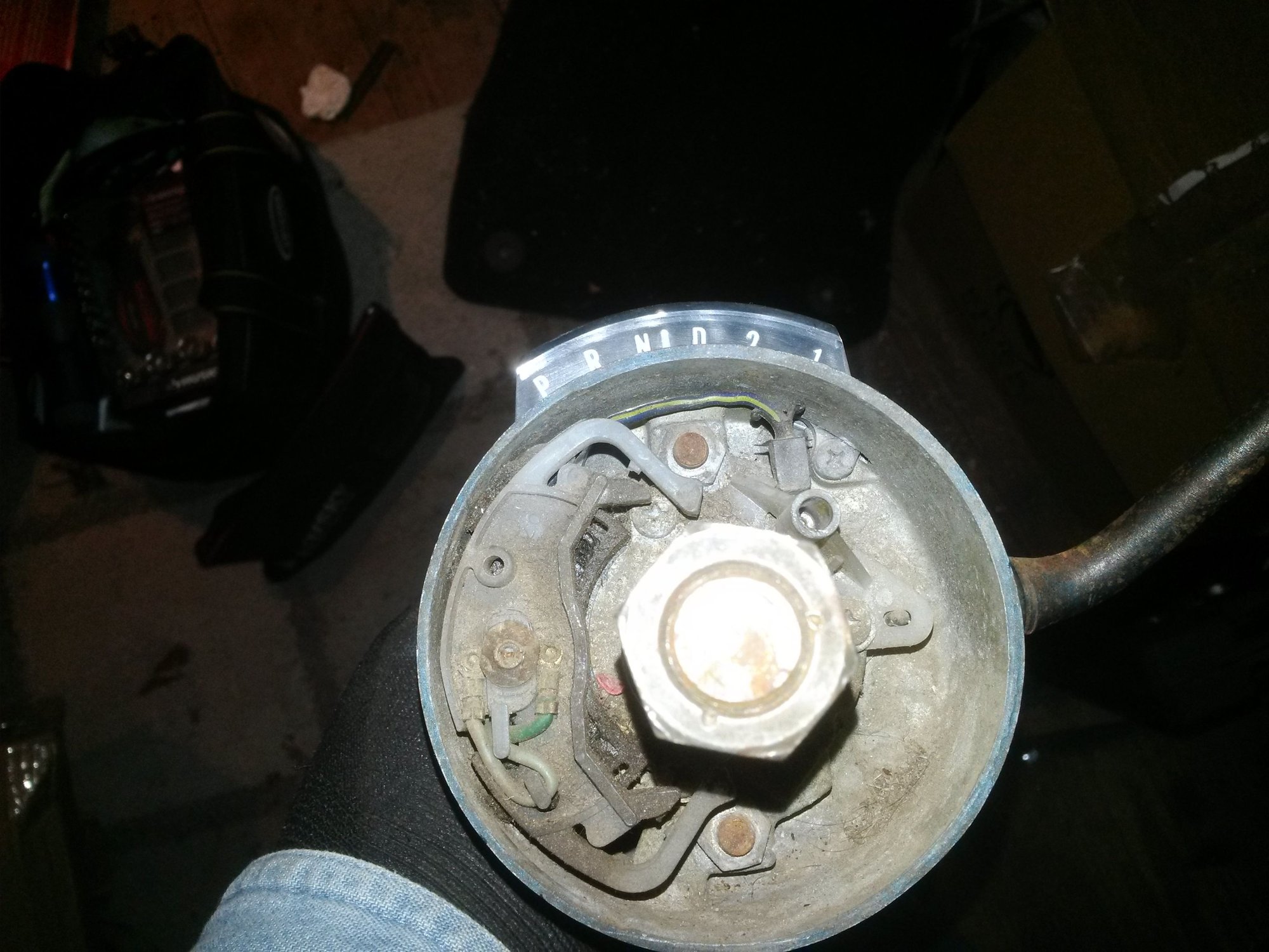

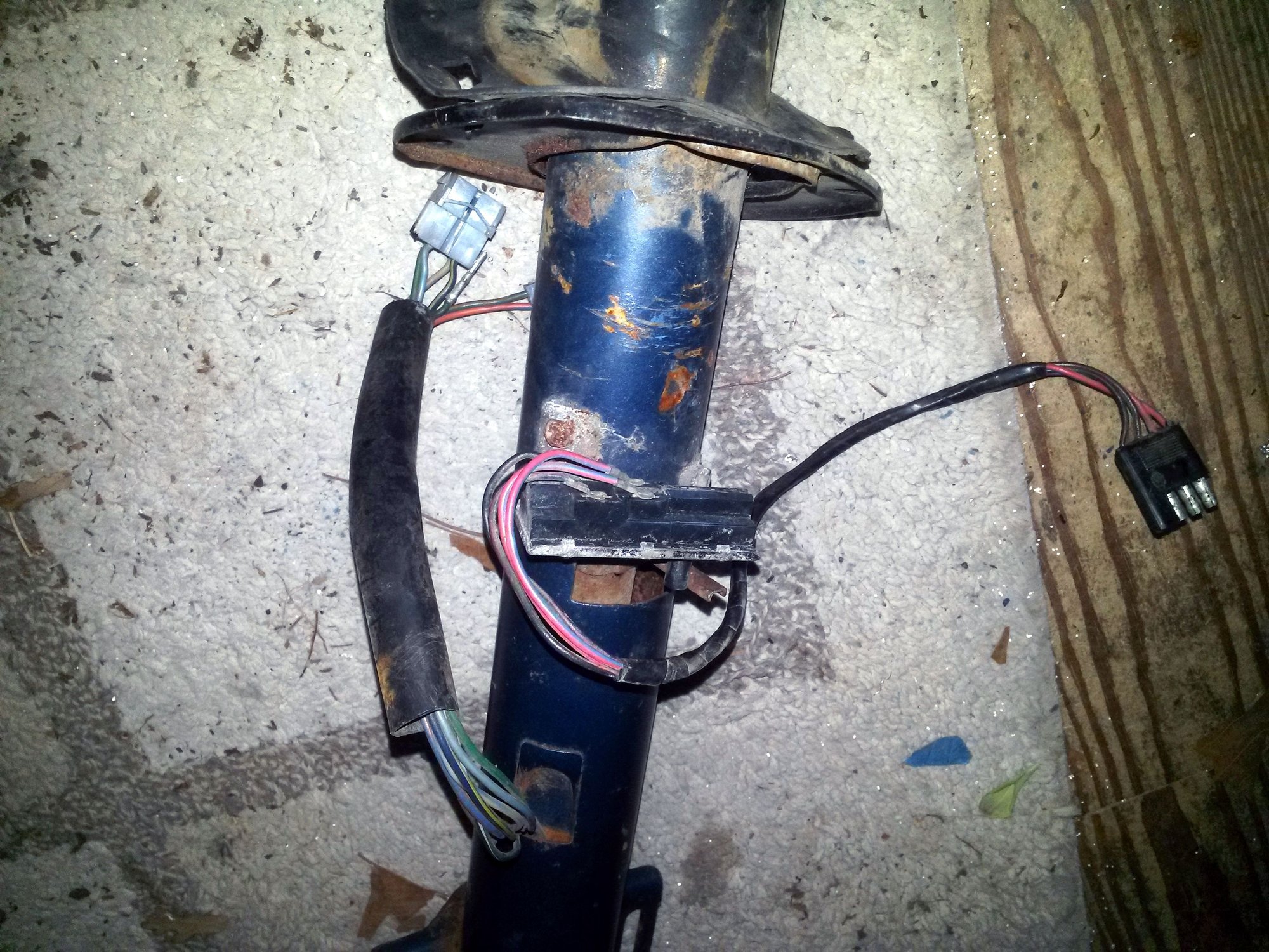

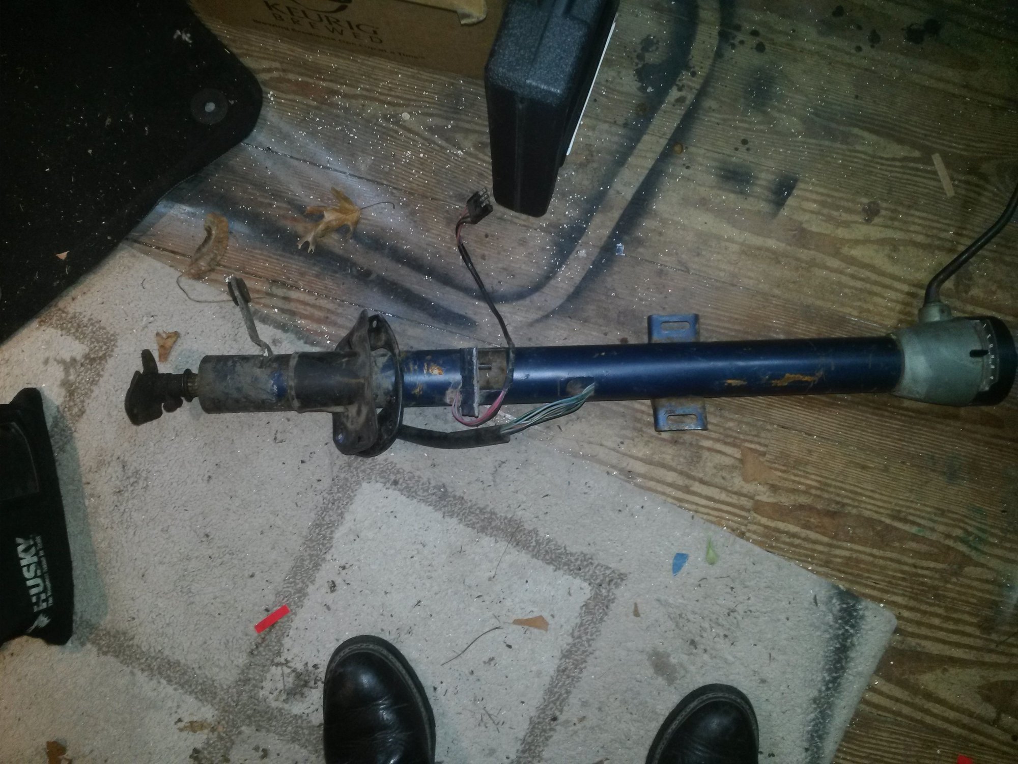

OK, here is the steering column I hope will work with my pickup. Seller thought it was a 69. I can't find any numbers on the thing to look up.
Old Jan 16, 2015 | 10:41 PM
orich's Avatar
orich
Joined: Aug 2003
Posts: 7,592
Likes: 10
From: **** hole San Jose ca.
The lower shift arm looks bent down some or it the way the picture was taken..
Clean up the blinker or put yours in it's place. Looks like filled with mud at one time.
Pull it all apart clean the rust out of the inside the tube put in new end bearings
Should fit it with a good/new blinker assembly.
Orich

Thanks for that information, Orich. I was wondering what to do with the column. Do you know if the bearings are easy to find?
Did you notice the wiring plug that comes off, what I am guessing is the Park indicator (not correct term)? I swear it looks exactly like the flat four-way plugs used on trailer lights, but the wiring appears factory.
