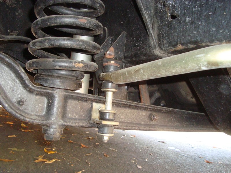

Here is the L-bracket style on a drilled I-beam. I thought it was inverted... not so. This style requires careful positioning because I have seen an F-Series where the bar actually rubbed the coil spring.:

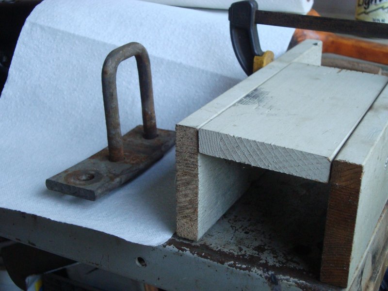

Here is the U-bolt style mount with the endlink mounting plate. The principle remains the same.
I cannot stress enough to mock it up at ride height with the weight on the suspension. Drill the I-beams first.. then swing the sway bar up, install the frame brackets, then mark the frame brackets' holes.

Note in the L-bracket style pic above ...look above the endlink bolt where the bushing and cap is rubbing the bumpstop bracket - the shiny spot with rust around it...... You don't wanna do that.

thanks for the heads up.. didn't see that part. Will pull the bar ahead a bit when I install it. (Y)
