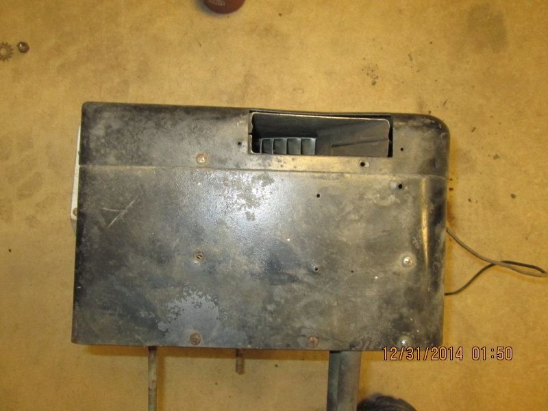

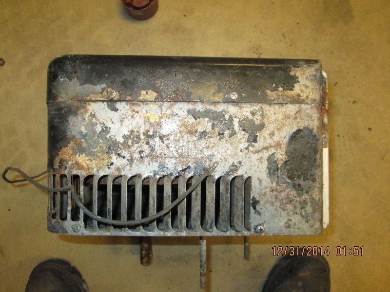

So I tore into this heater that I yanked out of my 49 F2 parts truck, so I could install it in my F1.
I can replace the motor but the radiator shop in town said the core is not worth fixing. So I thought I'd just order one that was close in size and modify the outlet to match the case. I've been searching around online and I noticed that some say "with AC" or "no AC". The ones that seem to match my size and outlet location seem to be the "with AC" models. Will the "with AC" ones be fine for my heater? I'm obviuosly looking for the most efficient type of core to heat my truck. AC is in the form of 2x55 mph (down hill with the wind at my back). Thanks!

The differences in the cores (with AC and without AC) are due to the shape of the housing they go into. If the AC one fits, and you can make it work, go for it!

I have the same or similar heater in my 51 F1. I sent the rotted core out and had it re-cored using the original end tanks and inlet/outlet pipes. The company that did it was Universal Carnegie Manufacturing, and they did a fantastic job.
From what I've heard, trying to adapt a modern core to fit is not going to work very well.
