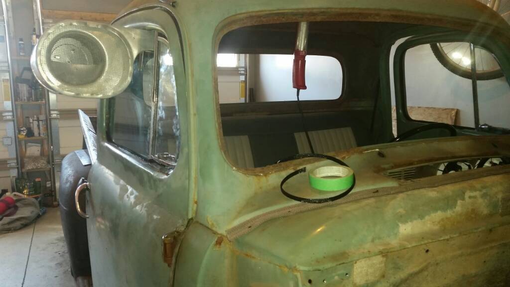

Since the passenger side glass got installed, I had to test fit the AC unit.... LOL!

Love swamp coolers! Is it functional?
Me too, and it should be! The pad inside operates, but the water does leak out a little. Likely an easy silicone fix
