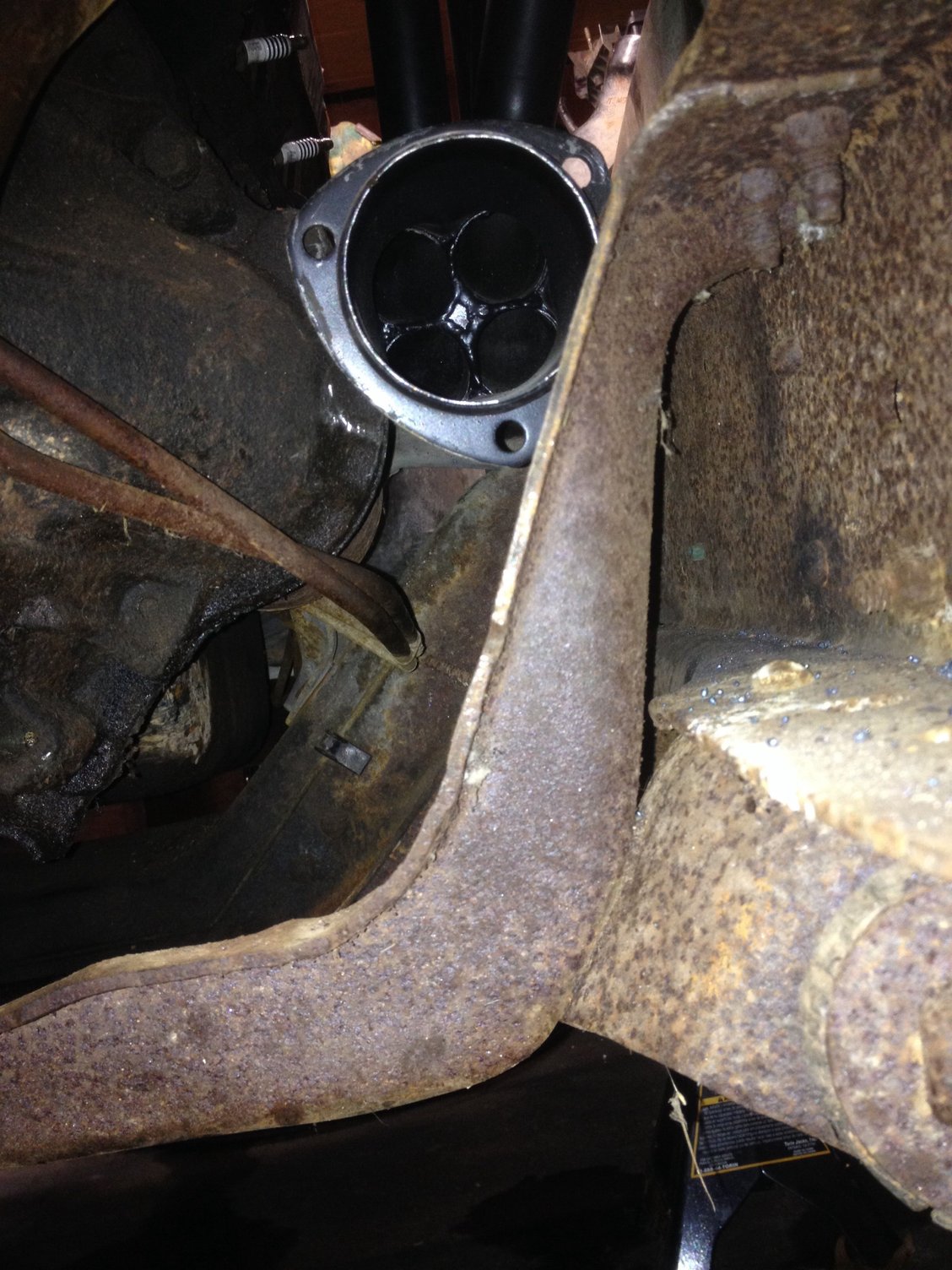

Everyone from hedman says it's installed from the bottom which I cannot see anyway possible with the crossmember in place , I am just blown away at the fact there isn't any shortys for this motor available to just avoid all these issues all together ,

So you're attempting to install them from above? Have you tried installing them per Hedman's directions?
There are plenty of shorties for the 302W... prolly more shorty variants than any other engine out there.

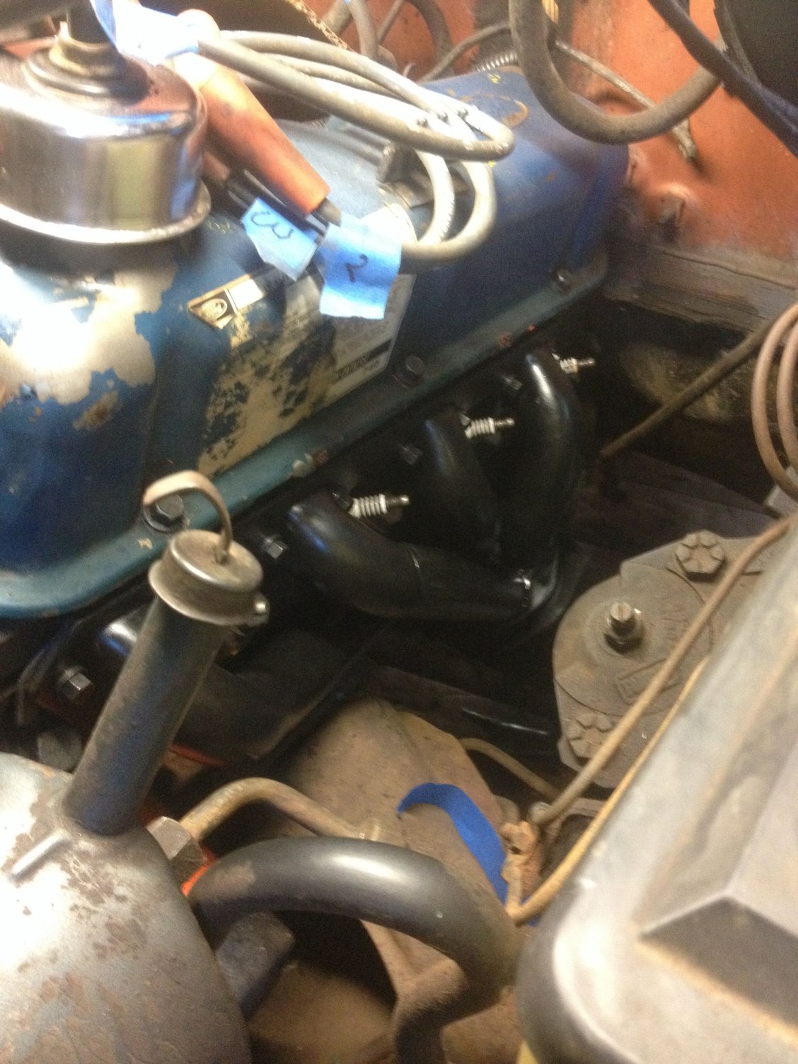

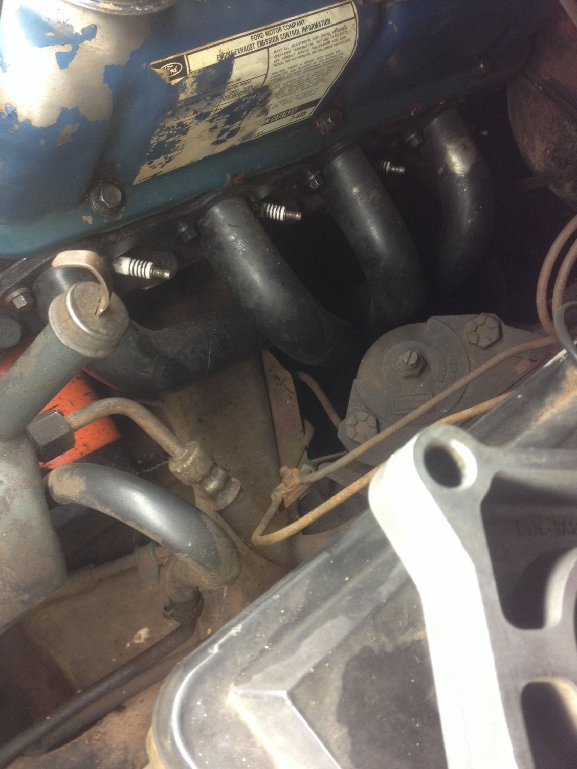

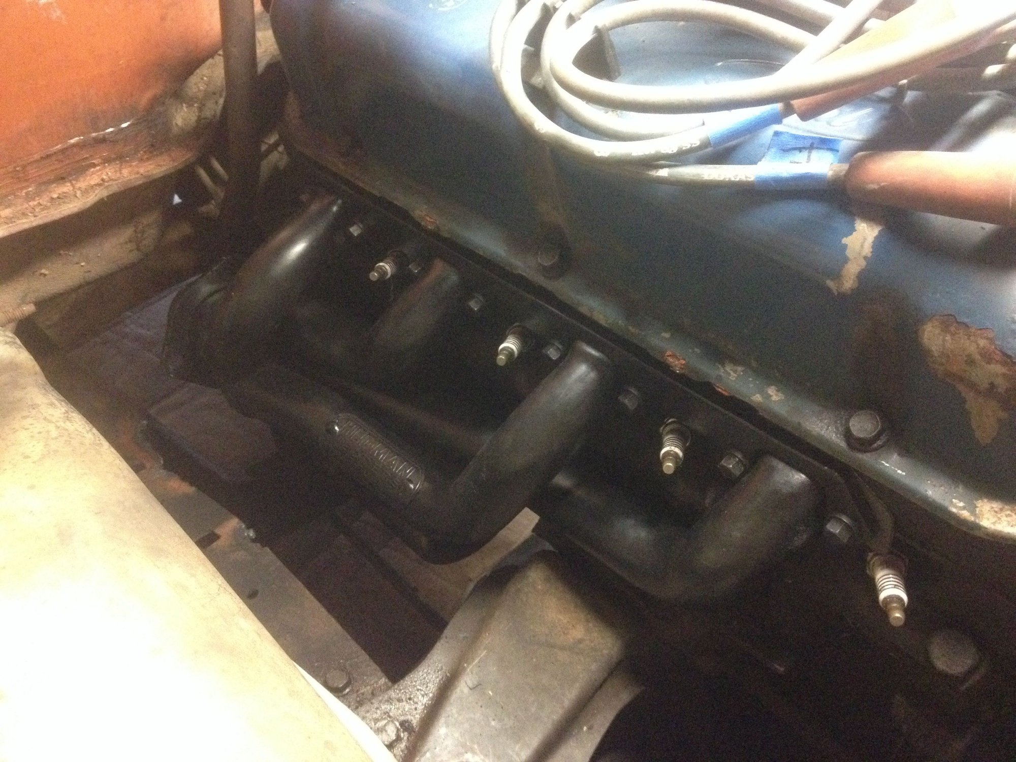

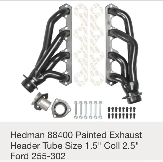

I have tried both top and bottom , the top seems more practical at the moment but i have been at a stand still with it for a couple weeks now and i dont have any extra help , i cannot use block huggers because of the motor mount brackets which i will show in the next pic , i have considered jba 1516s but im not to sure they will work i need the style like the hedman 88400 but it says they are not compatible
The pic shows the driver side with the install of the hedman 89150 and it clearly shows block huggers will never work

Looks like you need to take the starter off, and unhook the motor mount on the passenger side. Lift the motor on the passenger side to get the header past the starter bulge in the bell housing.
I install and remove the headers out through the top, never from the bottom, I have a manual transmission though, so that may be the catch.

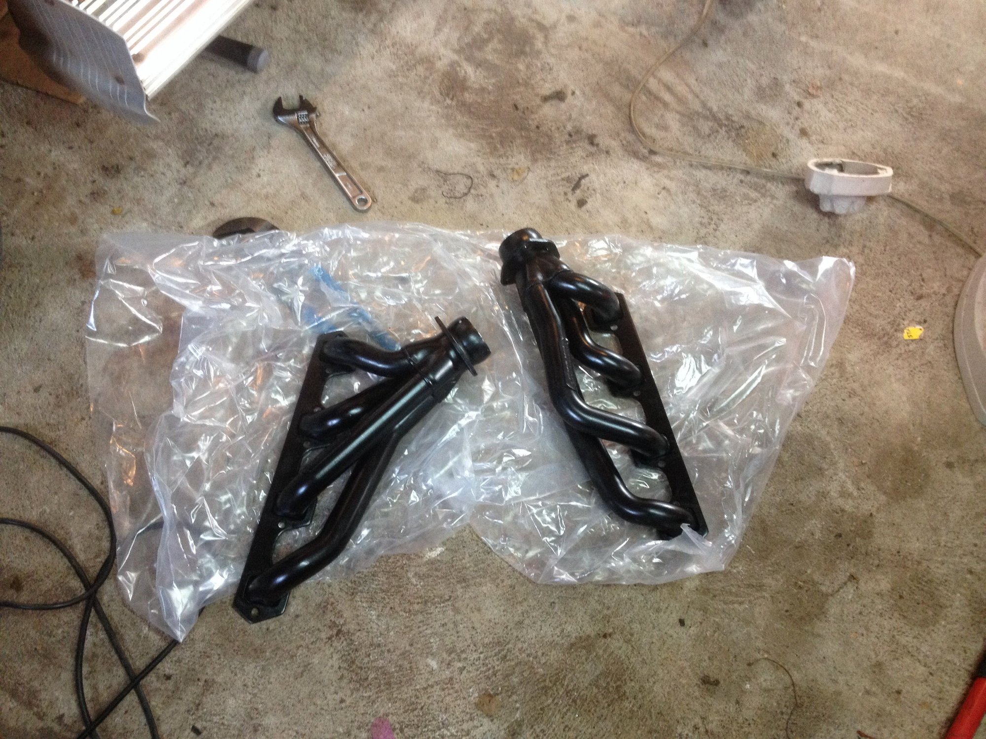

I really appreciate all of our guys help , I actually have the starter off and mounts as loose as possible last night I jack that side of the motor up and it still could not fit I beat the crap out if it to try and squeeze it down all that did was make a lot of noise an **** off the neighbors dog, I just decide to return these headers , hedman says the 88400 and 88600 will fit my motor so I ordered the 88400 from my local speed shop and will be picking up and installing tomorrow afternoon , I will post my outcome tomorrow , my gut told me to go with the 88400 from the beginning but everyone said they wouldn't work on the motor , we will find out I'll let you all know ASAP thanks

I have success thank god!!!!!
Old Dec 30, 2014 | 10:00 PM
Customexplorer77's Avatar
Customexplorer77
Joined: Nov 2014
Posts: 10
Those are hedman 88400
