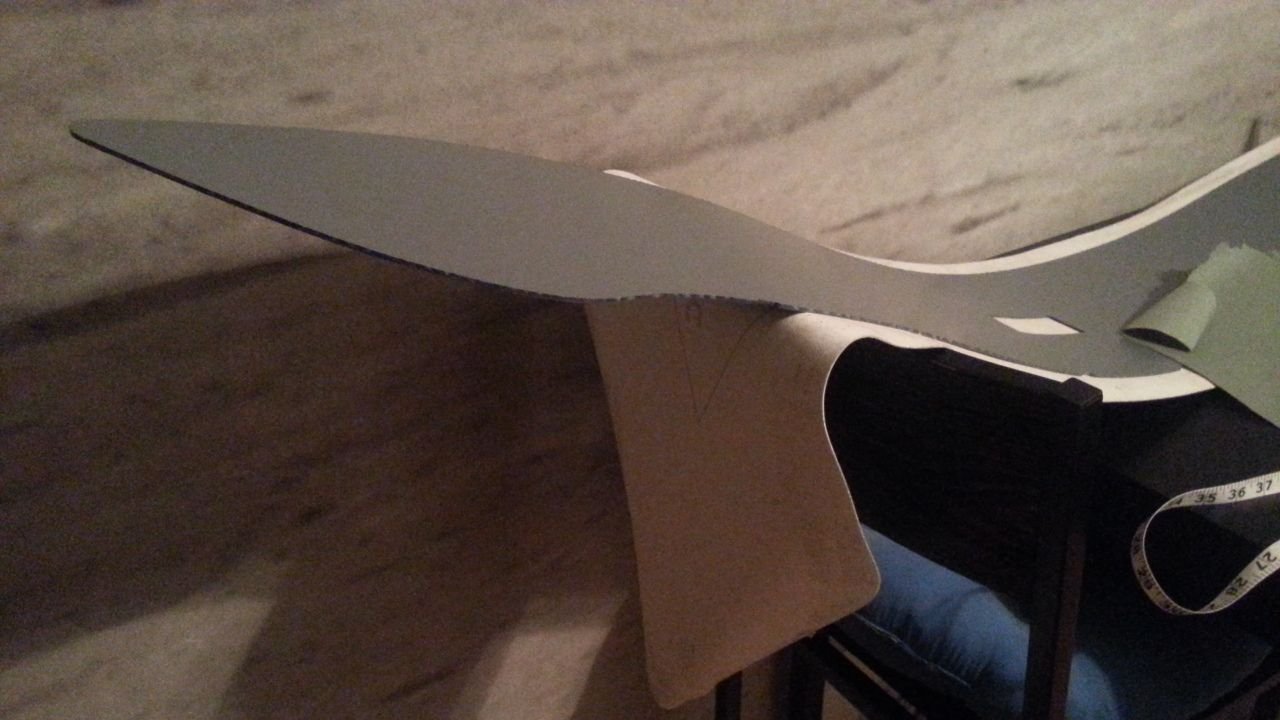

Ok, no more putting it off... most everything else is done in my interior and the abs headliner from StockInteriors.com has been sitting around way too long. My question is about the vinyl that overhangs the plastic all around. Do I trim it.. or wrap it around to the back side? I was thinking to maybe trim the sides that are hidden behind the trim and rear window seal, and to wrap the exposed ends.

I say trim it, no way the clips will fit over the abs and vinyl.

I trimmed mine where the trim and rear window covered the edge and rolled the rest over. Stock interiors said I didn't need the clips. The ABS is too big and will need trimming over the doors. The rolled over edges came loose with contact cement so I'll have to use a more aggressive glue.
Now I'm redoing it because of delamination problems and the black made the cab too dark. I'm thinking of using the clips but putting them on under the vinyl. I didn't use the Velcro included in the kit but will use it this time on the cab support in the middle of the cab roof.
Another problem was the piece over the rear window wanted to move upward and I haven't sorted that out yet.
I'm repainting the truck and moving the gas tank out of the cab and everything is out of the cab now and haven't got to putting stuff back in so I can't give solutions to everything

Yea, that's another story... mine is delaminating and it's been sitting inside the house! I'm redoing it with 3m high strength 90. We'll see how that holds up. Oh... and in post #1, note the rear of the main piece.. I had to jb-weld the tabs with fiberglass mesh tape as they both broke while trial fitting.
