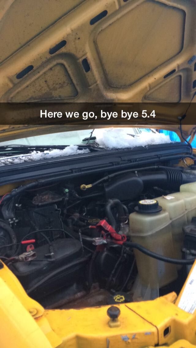

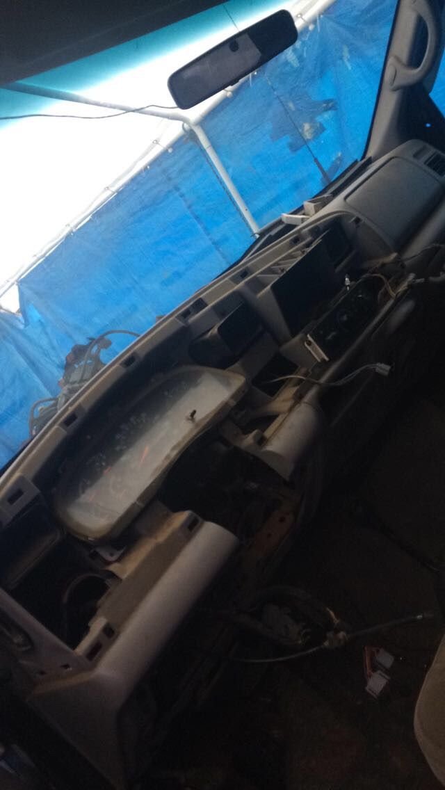

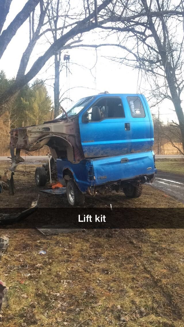

Finaly started workin on the 04, pulled the motor and tranny, Gonna pull all the wiring tomarrow, Ill post a few pics if I can

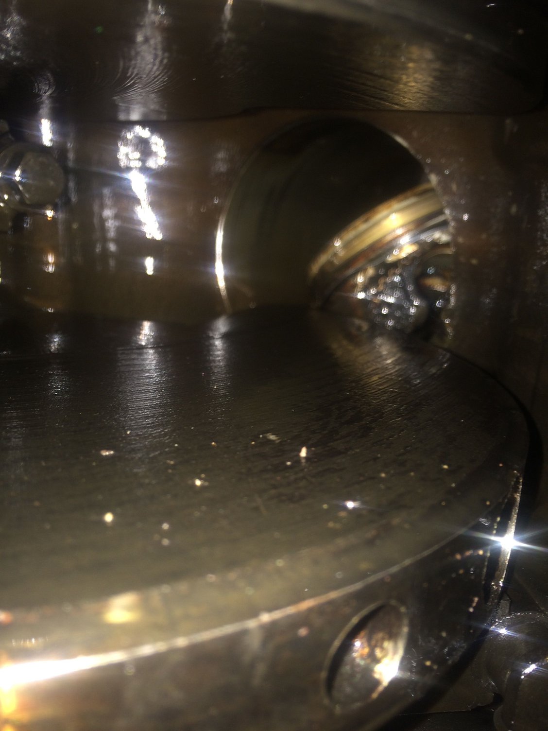

The 5.4 that was in the truck threw a rod lol, thing still ran tho

Same here, drove it on the trailer and off the trailer,, wouldn't do a burnout tho haha,part of the rod went threw the oil pan, so by the time we pulled the motor it didn't have any oil in it,

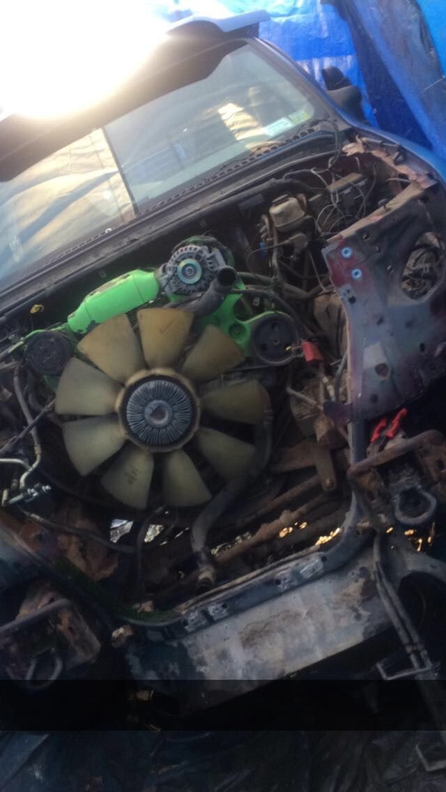

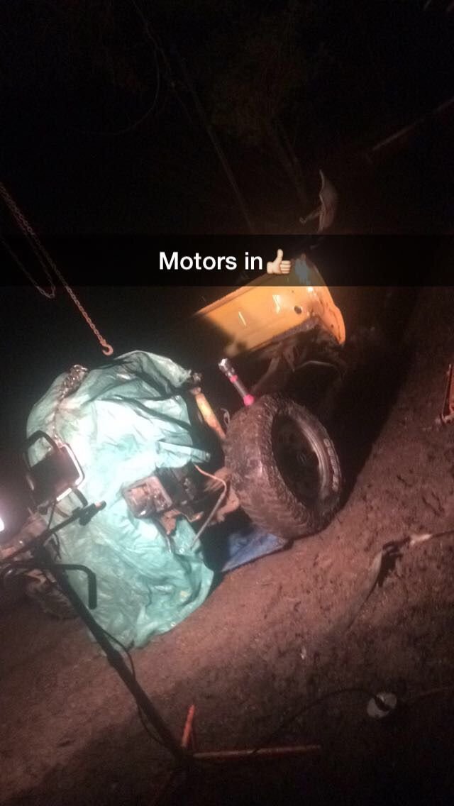

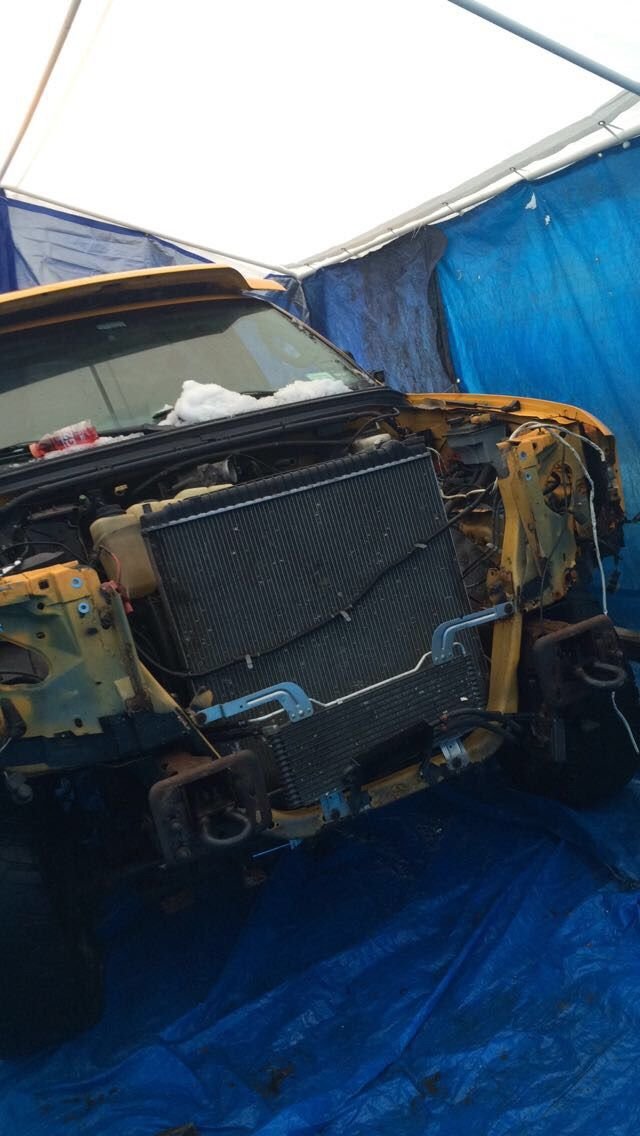

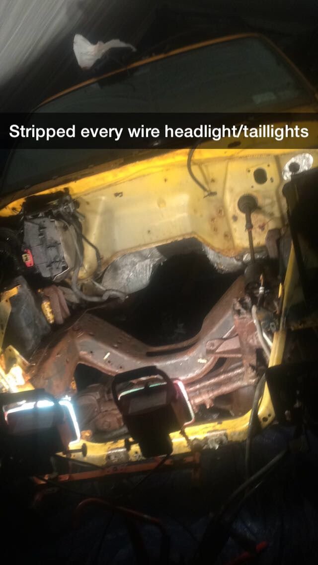

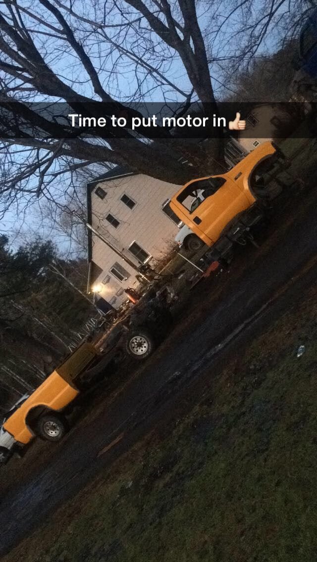

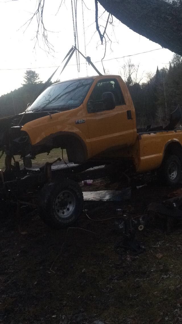

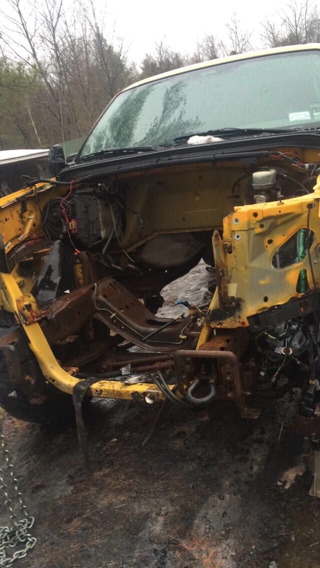

He's some more pics,started tearing the powerstroke apart yesterday and got the motor set in the 04
