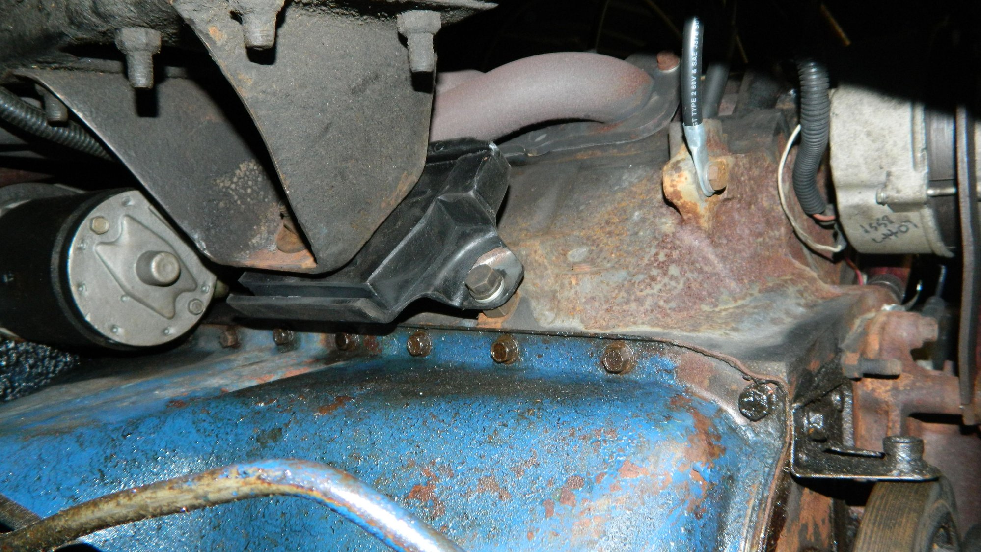

i posted about this several weeks back and had no pictures. took a couple to see if you guys can tell if the mounts are correct or are they installed wrong ? original 4x4 150 351m . the guy that installed them said they wouldnt line up unless he used the spacer between the block and frame mount.

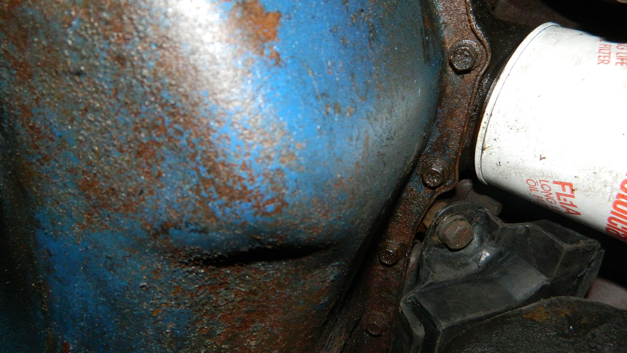

My guess is it looks wrong to me because the spacers (nuts) under the motor mount. I would think that the motor mount metal plate should be bolted flush against the block.
Looking at the pics of that mounts you have, they can not be the correct motor mounts, because it looks like if you remove the installed spacer (nuts) the metal part of the mount will/could contact the oil pan, especially on the dvrs side.

Ok so a pic is worth a 1000 words. So I just went out and crawled around under 2 different trucks...
1st 2 pics are from a 79 4x4 F250 with a 351M 4 spd that I swapped in from a 79 bronco (auto trans) myself.
2nd 2 pics are when I double checked an all stock, never been worked on 77.5 4x4 F250 351M auto.
Then checked the block that came out the 79 with the mounts are still on it.
NO where did I see that spacer (nut) installed on any of them.

I am thinking the same thing that the mounts look the correct thickness too, with more oil pan clearance on the right than the left. But that spacer nut is wrong for sure.
Maybe loosen the main center mount bolt (remove the nut), remove the spacer nuts and make sure the mount clears the oil pan and bolt the mount flush to the block then lower the motor overall a little bit to get the main mount nut back on, if the stud is long enough then?

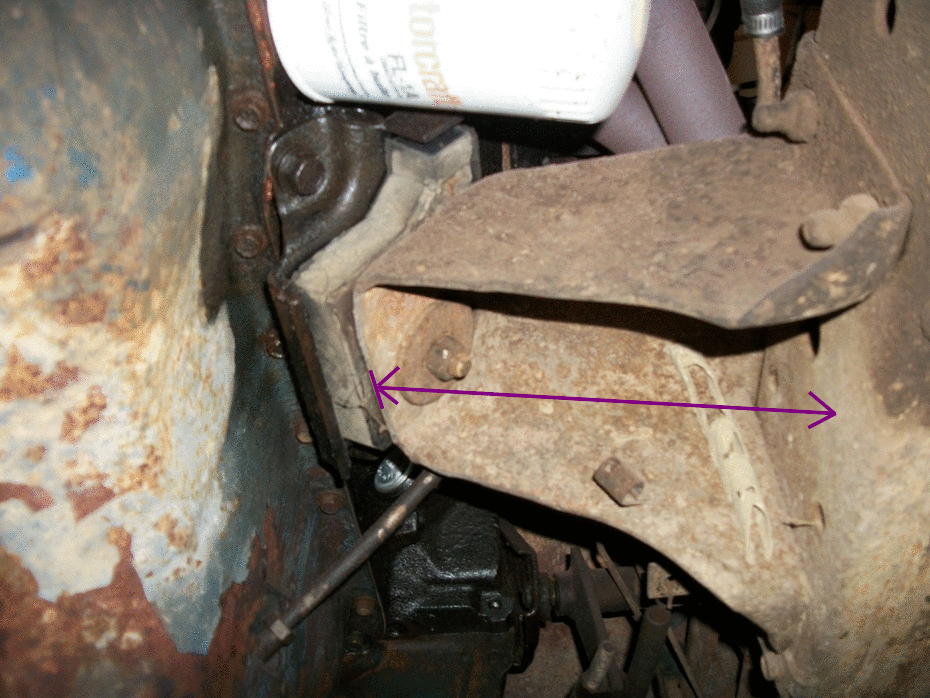

hey 77&79,
thanks for the assist. i went out and did some measuring. see picture/ i have marked from the inner frame rail to lower edge of the mount closest to the pan. (on the driver side it measures approx. 7 3/4") ( on the pass side is approx 4 3/4" ). if you get the chance , can you confirm that distance on yours. if its a match then i am thinking i can break the mounts loose and remove the spacers one side at as time and see if they will drop down in the slot further.

Your purple mark measurement on my dvrs side 79 F250 351M 4 spd, 8 1/16", passenger side was 5 1/2".
Tape measure was matching the angle of the mount and went to the bottom edge of the truck frame. My red line.

i agree , they have no business there. im thinking in short order they will work loose.
77&79 : the dimension checks out. same as the numbers you posted. and it doesnt look like an easy task to replace them. even though we parted on less than good terms i am going to have to bite my tongue and ask him why he felt the need to do it in the first place. i may tell me to take a leap.
