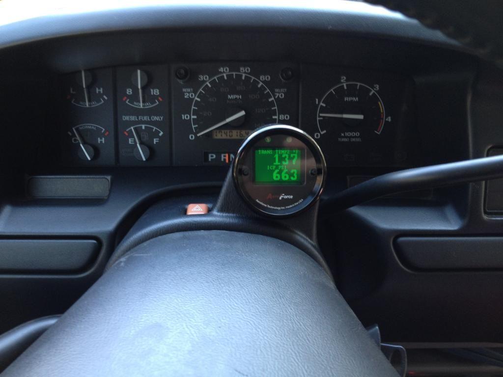

The FD is for the OBS.
Aeroforce Technology Inc | Products - Interceptor Ford Order
Silver and black bezels come with it. I chose the green colored screen.
The column pod is for a SD with an auto trans. The pod for a manual trans won't have the hole in it. (Duh.) I used heat to soften the plastic and formed the opening for better gear selector clearance. It now just barely bumps it. There is no glue or velcro being used to hold it in place.

Perfect, thanks! Just what i needed.. Question the pod is for a SD? EDIT: yes superduty... Looks like its perfect for an OBS!? Howd you run your wiring? Merry Christmas!! Is it an autometer pod? EDIT: yes autometer... Think b4 u ask Corey!!

Nice placement of that gauge Corey!
