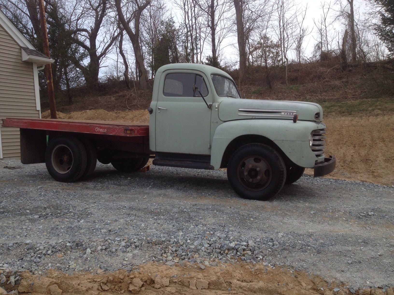

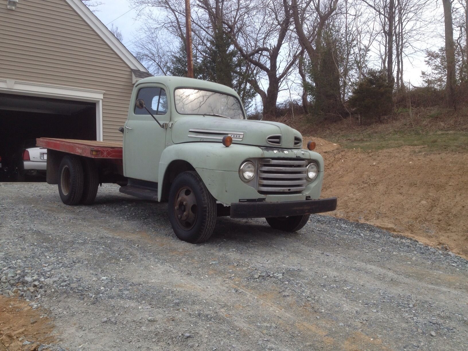

Ok guys question for you, i have a 1949 f-4 that I'm going to restore in the spring,I was wondering how hard it would be to convert it to a M-H 4 wheel drive finding a M-H front axel and transfer case, the truck is all original 21,400miles on it with no rust,garaged kept with a great running flathead 8. Is it too hard to find the parts or just restore it the way that it is?

It looks fine to me why would you want to change it? Looks like a great survivor, I would leave it as is. Just make sure it's mechanically sound.

Stu, will be your expert, but I think finding the front axle and transfer case would be a big and expensive chore. I would get it safely going and stopping like it is and enjoy it.
I'm afraid your truck would be sitting for quite a while as you assemble all the necessary parts to make the conversion. That's too nice of a truck to be sitting in pieces in a garage.
Of course if you do decide to go the M-H route, you have to take tons of pictures and post them regularly. Well, actually if you don't go that route, do the same thing.

Thanks ,actually I do drive the truck now,it's my go for a coffee vehicle! That thing is truly a monster going down the road! Lots of fun though but I still think about the 4wd thing
