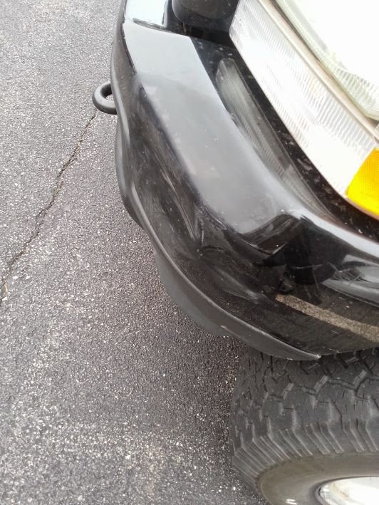

Here are pics:

Originally Posted by jpcjguy
Here are pics:
Thanks bud. I'm 98% certain if you drop the bumper you can push those out yourself. If nothing else, lay it front down on a blanket in the yard and step on it gently increasing your weight until you feel/hear it pop back. While not paper thin, the bumper isn't wicked thick either.

Posts: 270
Yeah. I think I can at least get it close. Then take it to get painted. Hey - at least all the rock chips on the rest of the bumper will get taken care of.
