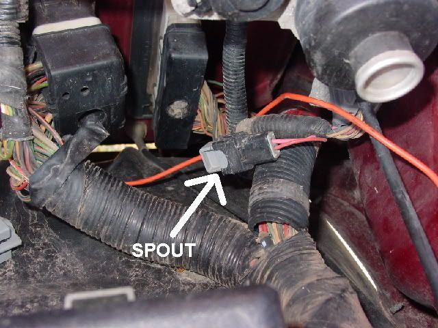

In your case the spout plug is in the wiring harness back near the hood hinge on the drivers side, see the pic below.

I looked there but still can't find one. What do the wires lead into and come from? I did find a taped off bundle of wires that look as if someone cut them exactly where the spout is in this picture. I seen it before I started the build but thought it just came from the factory this way. The only other person who's owned this truck is my dad he bought it in 97 but I wouldn't think it'd run right if this were the spout cut off like that.

The wires for the SPOUT go to the Ignition Control Module (ICM) and computer (PCM).
A wider angle view:
courtesy of subford

Ok I'm gonna check again. I've looked a dozen times. I've looked by the distributor to I've read that it could be there or the drivers side fender. Could the plug in look different than the two pictures posted here? Or are they all the same?

Ok I finally found it. It was taped up and underneath some stuff and inside the conduit tubing. Now that I found it. I take and start it with the spout out, get it all in time, then bolt down the distributor once it is in time, then I plug the spout in last? What keeps it from advancing once the spout is plugged back in?

Pulling the SPOUT connector allows you to set the BASE timing and keeps the PCM from controlling it. Once you connect it back, then the PCM can control advancement and retarding for fuel table and load, and other stuff.
