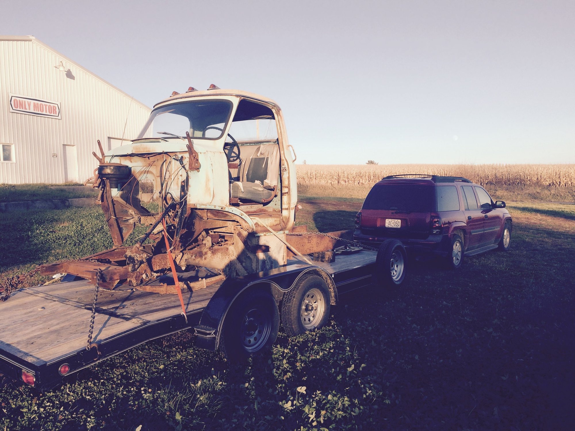

1955 COE Ready To Take Home
Getting ready to take the COE home.

Welcome to FTE
Lookin Good where's the frontend?

From: Kingsville MO
Believe it or not, all of the sheet metal is inside the Trailblazer. It was a noisy ride home.
