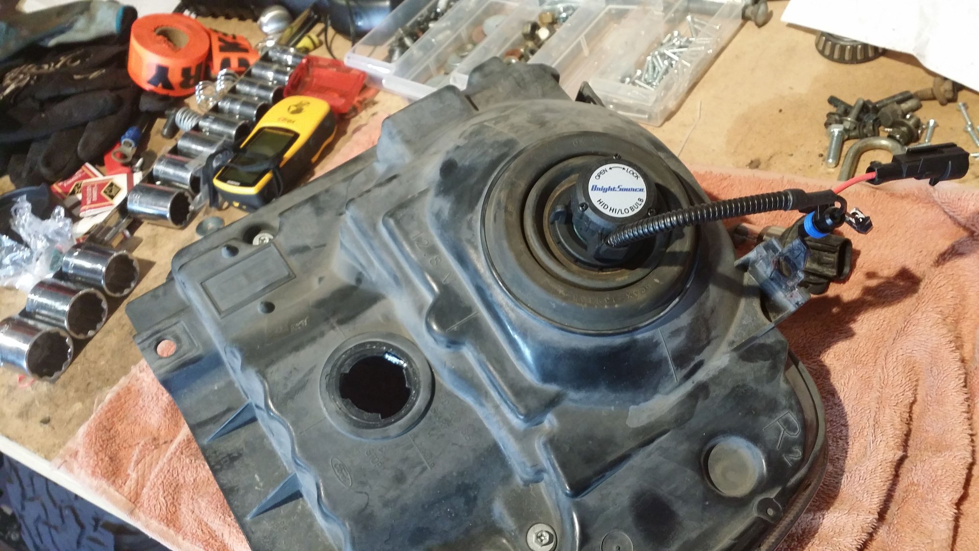

The new HID lights come with tabs that screw into the factory location, then the HID screws into the tab. These lights will do low and high beam and this is accomplished by the tube moving in and out to project more light.

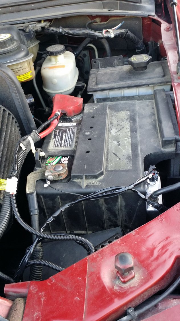

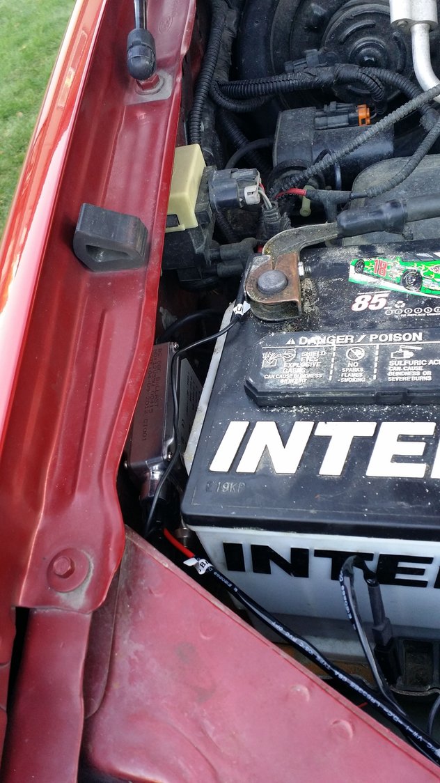

With the lights in, I just had to find a home for the ballasts and attach the grounds and power supplies. The install took me just over an hour to do with most of the time figuring out how to keep the wiring clean in the engine bay.
Passenger ballast mounted to an existing ground point.
Driver's side ballast mounted to the battery box cover.
