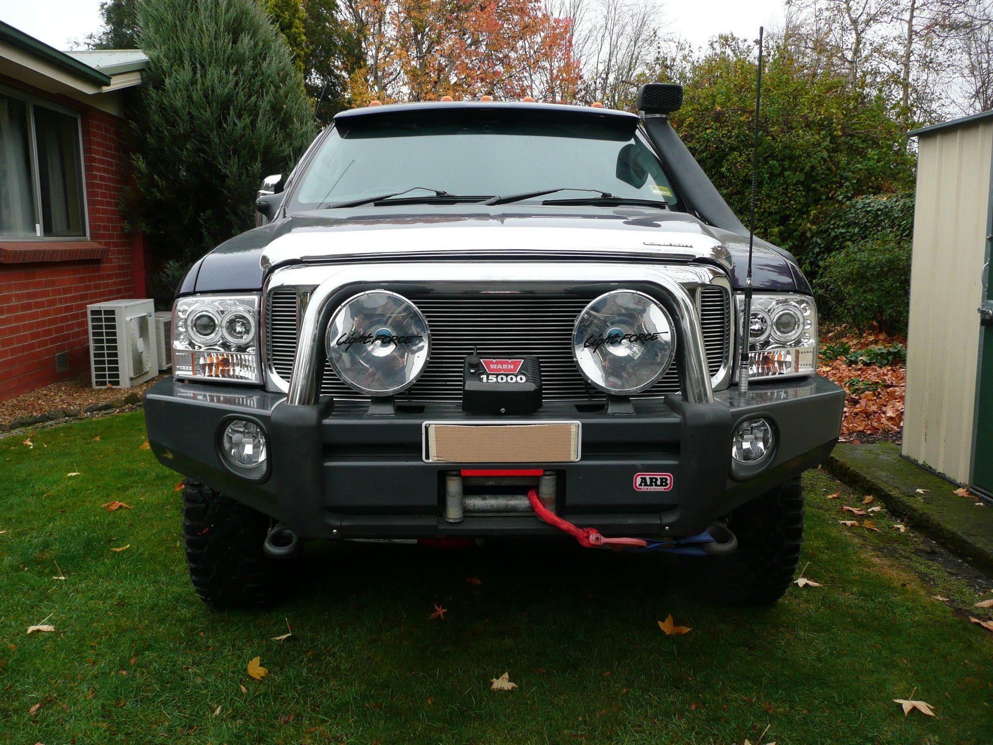

Yes , i'm waiting on the new bulbs and will try it in the housings first.
If you look at the photos i posted you will see the the new housings are flat on the backs so i might not have to cut the header panel.

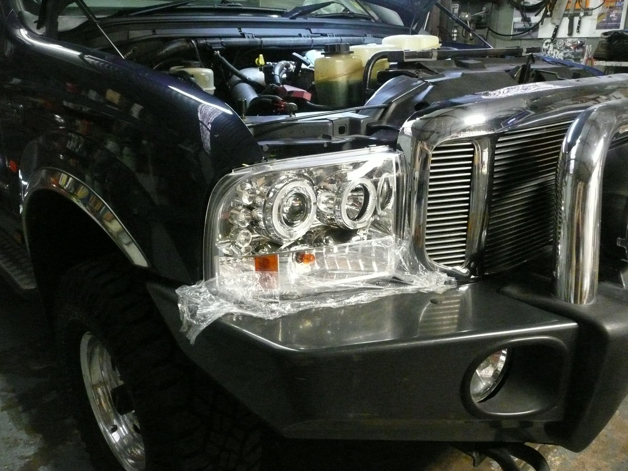

Update - Projectors lights (hid's) are in place, i bridged a diode across from low beam to high beam so i don't get light drop out as you mentioned Simon.
This shows the diode from LB to HB
I haven't road tested the light spread yet as I'm still playing with the PVH solenoid.
The housing fit was really good, i had to trim the header panel on both sides, i'll show that in the next post.
