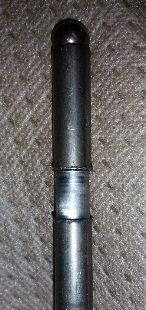

Also had some valve pushrod issues, which caused me some grief. The guy who built my motor (me) did an idiot move and used guide plates on a motor that had rocker arms that were guided too. Wasn't a good thing. New rocker arms and pushrods... so far, so good.

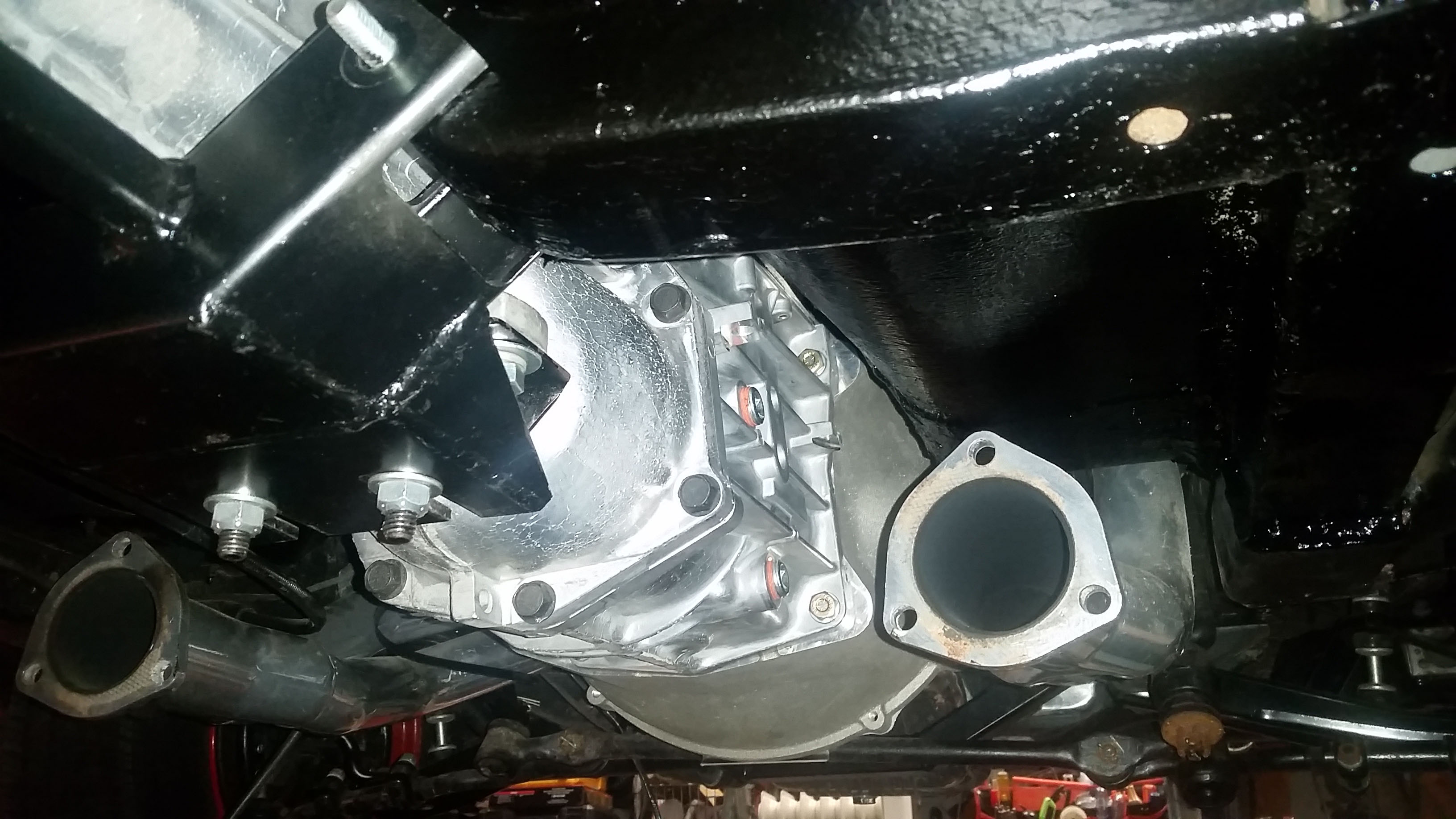

So this fall I decided to bite the bullet and do a T5 conversion in this, which I suspect will bring the joy back into driving it. Not quite done yet, as I'm doing a couple other WIAI™ things, but getting close.
The T5 is in and just got my drive-line back.

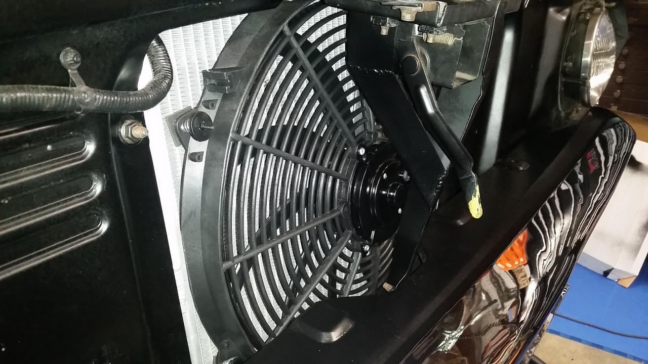

WIAI™ I decided to deal with some cooling issues by adding a electric fan and smaller engine fan (found my bent pulley while at it)...

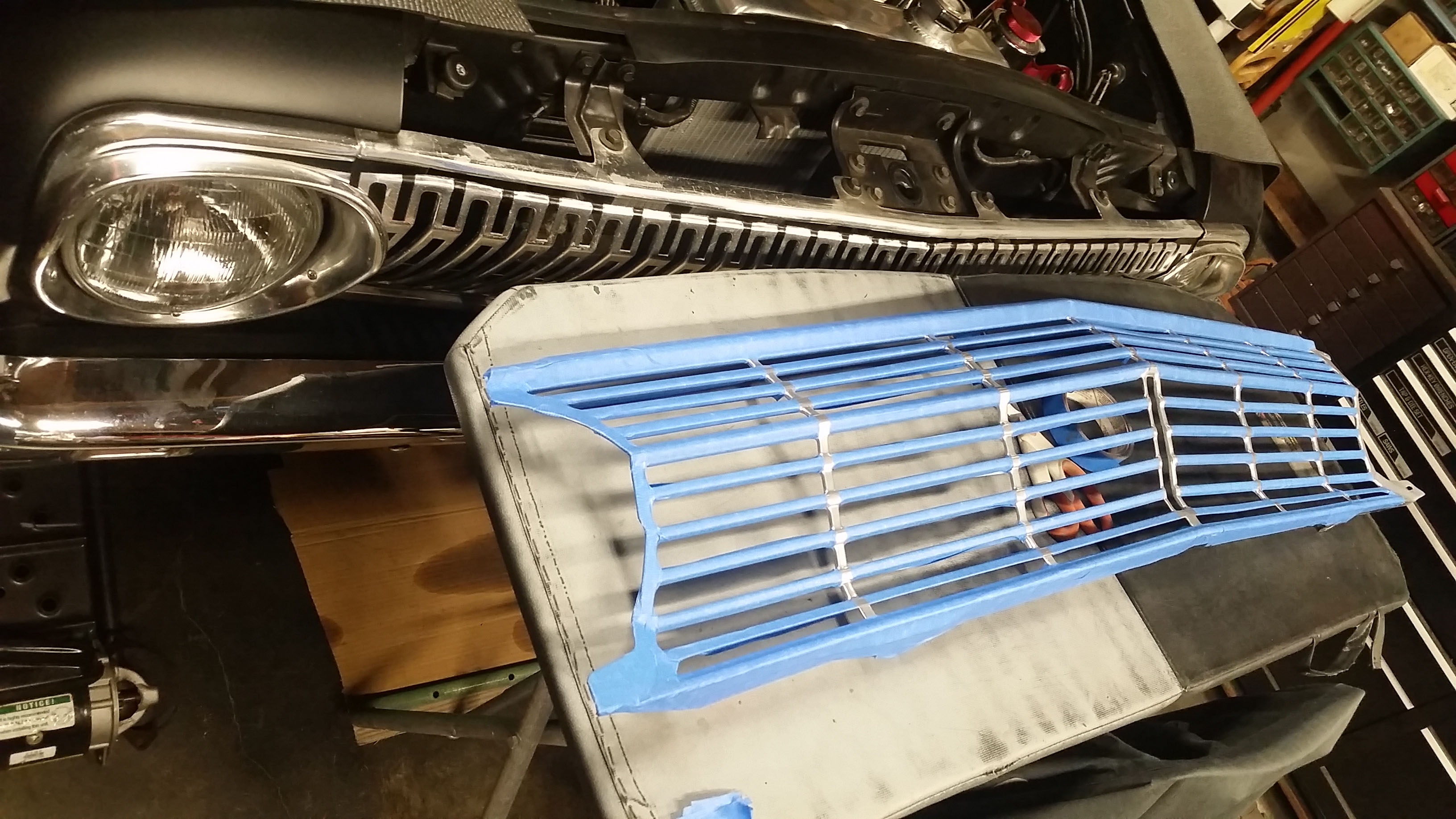

...swap out the grille to a '63 grille...

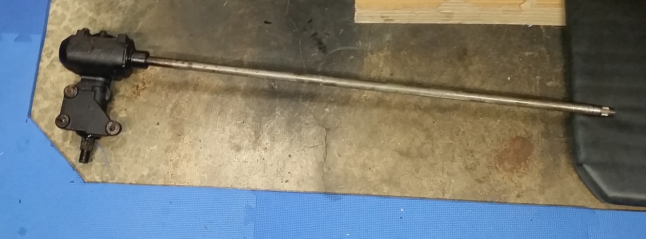

...instead decided to just rebuild my steering box...

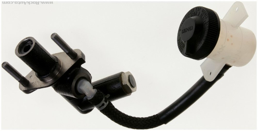

...now I'm working on the hydraulic clutch, which I'm doing using Mazda MPV hydraulic parts...

Once I had the T5 in (used Mazda MPV hydraulic parts) there was not enough clutch travel, so I had to engineer a new lever-arm for it.
