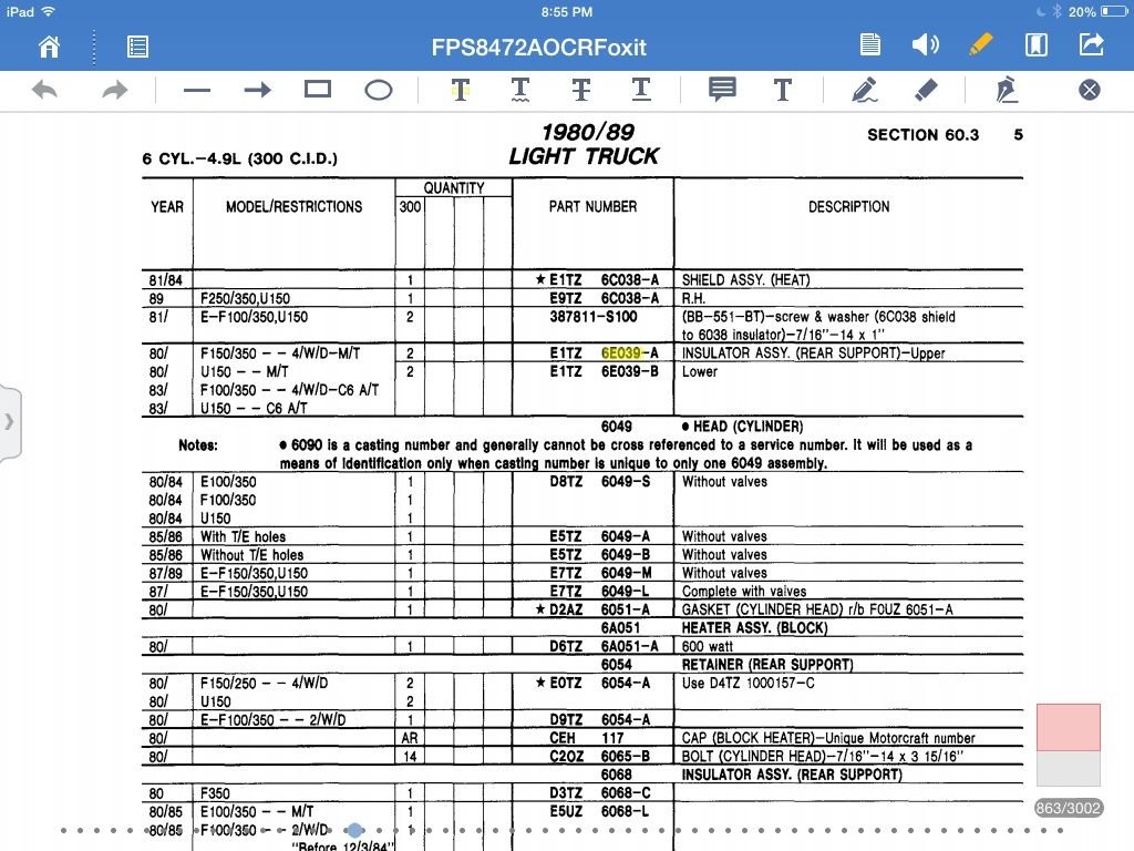

Is what you're looking for in these drawings?

Yes, thank you, the part is 6E039 in the drawing. My Haynes manual refers to it as rear transmission mount-to-crossmember isolator. Looks like they were only used on 4X4s.

I think this is what you need. The #'s are the same for all engines.

Gary is saying that you want: E1TZ-6E039-B

Actually, I thought he wanted "A". Isn't it the upper one he wants?

E1TZ-6E039-A .. Insulator-Rear Support-UPPER / Obsolete

But the -A says that part number is for a 4WD manual-transmission only (unless I'm reading that wrong, which is possible)
I think the box is showing what all the upper and lower fit. If you look at the other engines it is fairly clear.
But the -A says that part number is for a 4WD manual-transmission only (sigh) (but you're reading that wrong, which is typical for a novice).
Uh huh...the next time you're here .. I'll teach you how to read a part catalog.
Here's the 300 I-6 page you posted (that you taught me how to do!), how many upper part numbers does it show? ONE
How many lower part numbers does it show? ONE
So the applications are for both A/T & M/T and if you look at other engine sizes, as the Oklahoma Kid said...there's no mention of A/T or M/T.
