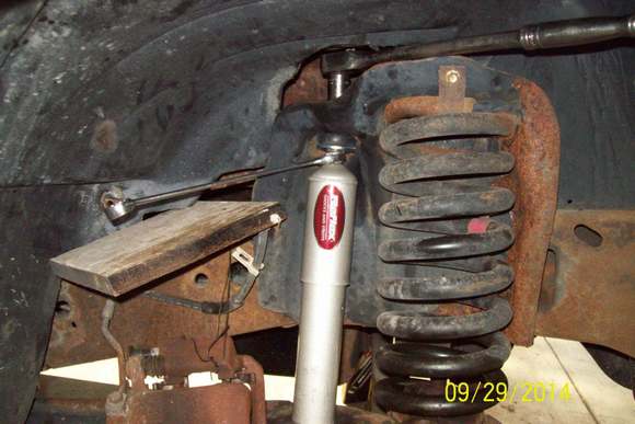

I recently just installed new swaybar bushings new sway bar links new front wheel bearings new tire rod ends new ball joints and also -new pivoting axle bushings
And brand new KYB shock absorbers
So im confused on where this sound is coming from it also sounds like i here the same sound when i cut the truck off and my door is open i kind of here the same clunk
Could it possibly be the coil springs ???? As well

I would think if it was a coil spring it would be more of a popping sound and less of a clunking. Just double check to make sure the spring is seated correctly and the bolts are tight. Did you replace the lower spring isolator? Now when you did the shocks how tight did you tighten the top nut? You want to make sure the rubber bushings are compressed alittle and are bowed out some.
