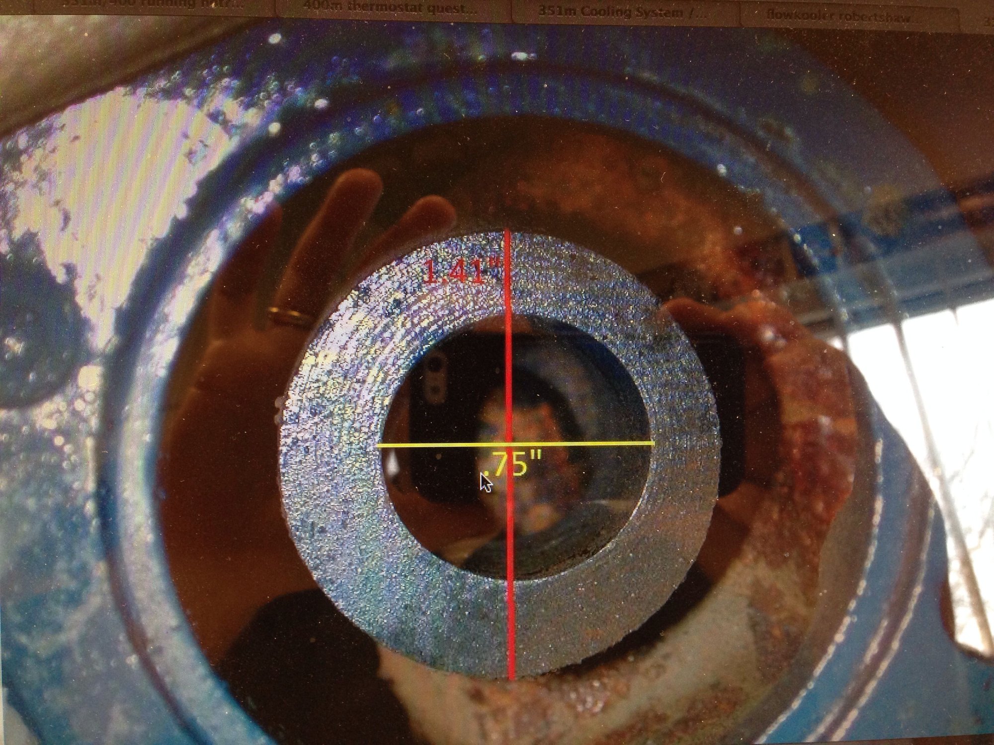

Pretty sure it's my t stat. It has the "hat" but I got it at oreilys. My outlet looks like this
, not like the one in pic in above post. The robertshaw and motor craft t stat look completely different. Robertshaw looks like brass skirt seats on the brass seat in pic above. I can't find a rs 333-192 anywhere. I did find a rt-139 but then started reading forums about the rs 333 being better? Looks like it would be better if my outlet looked like the one in butwheats post.

I know I'm beaten a dead horse with this thread but Im just curious…Any thoughts on why the two thermostats are so different. The Motorcraft ft-139 looks like its identical to the aftermarket stats that also have the "hat". As far as the bypass outlet, why are the two pics so different. Is one for a 351 and the other (like mine) for the 400?? Thoughts…..?
