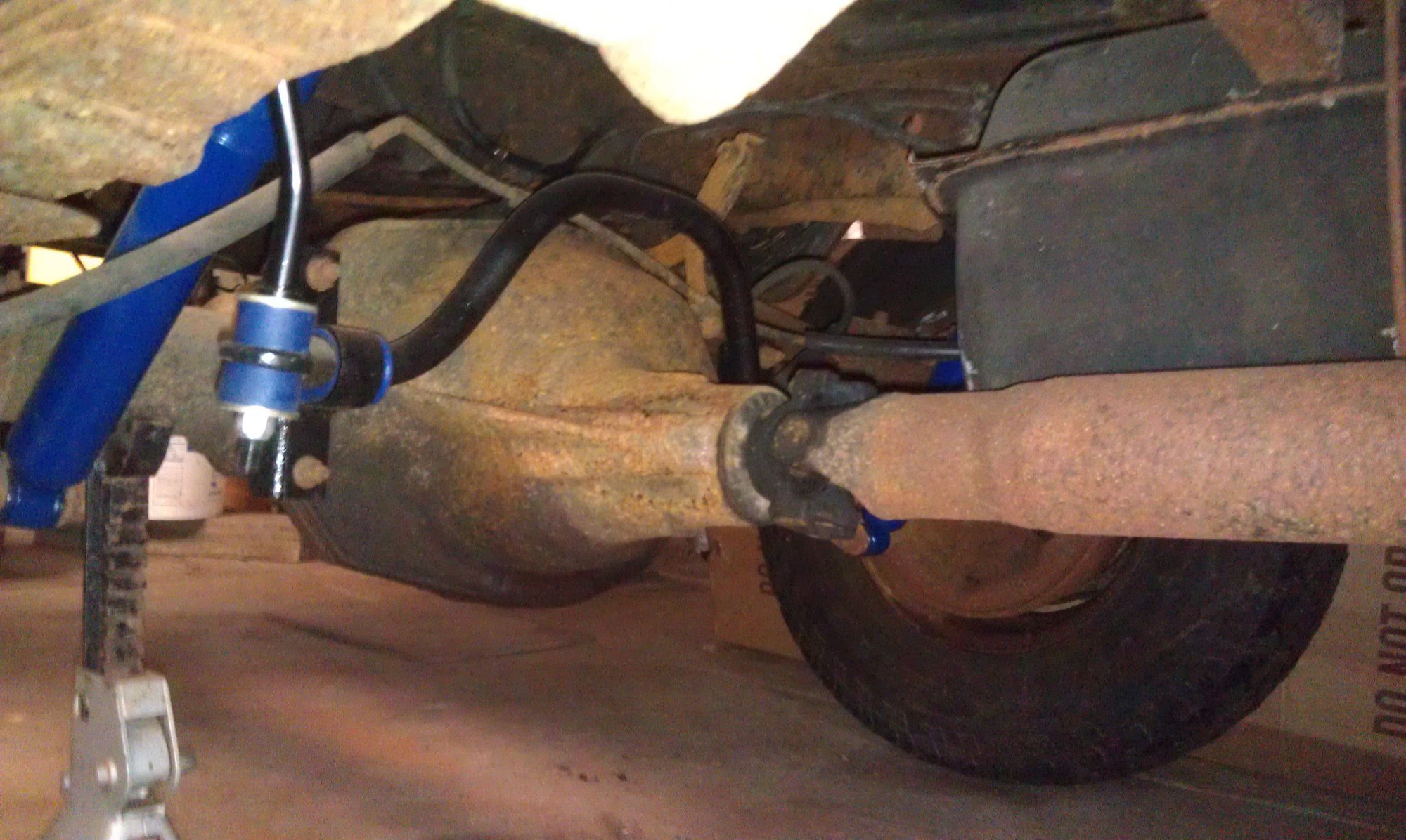

That should be the right nut for that side if the axle is the Sterling. Post a pic of the old nut and rear end if you can.

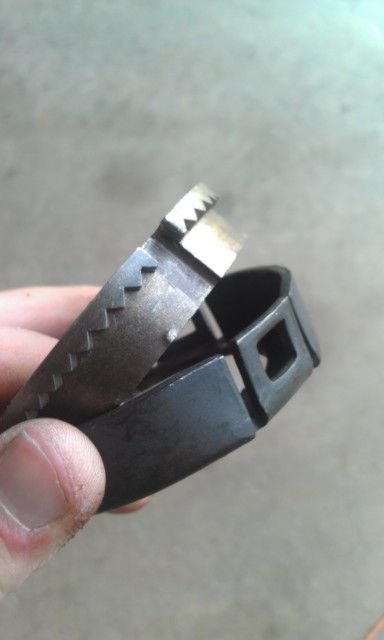

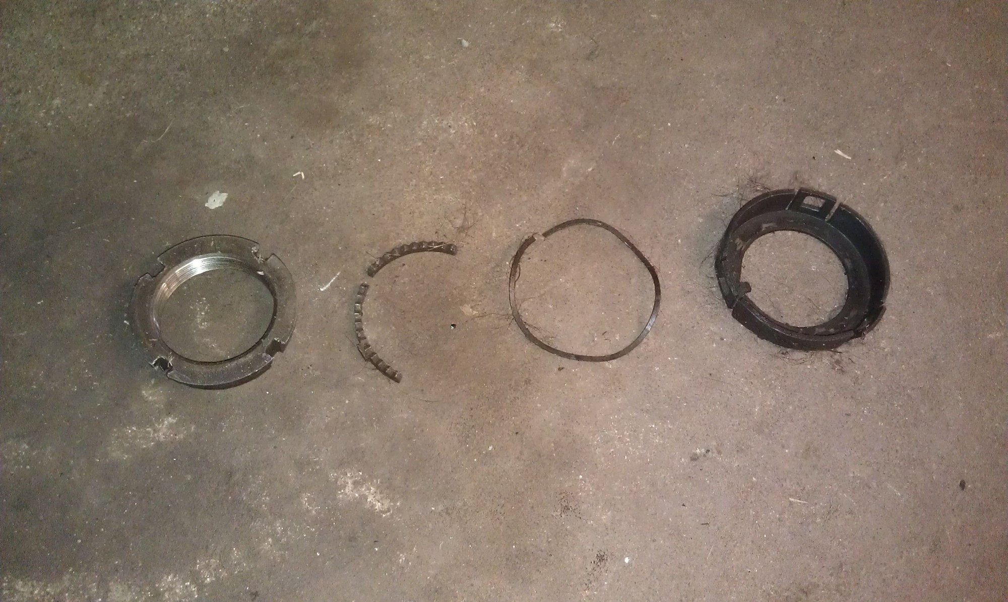

Here's some pics that i had on the computer
not pictured is the ratcheting ring and some sort of spring ring. both of which nestled between the nut and cup. Also its 2wd axle code 35

615-133 is for the right side, 615-134 is for the left side.

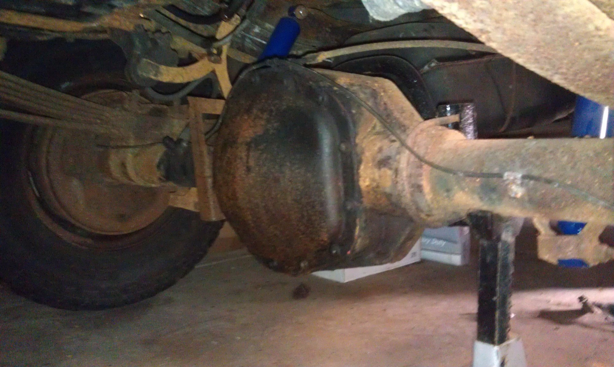

here's the axle

Right hand and left hand threads = left side and right side of the axle.
You need the 65-134 nut for the passenger side.

Originally Posted by 89laredo
Im rebuilding a 86 F250 with the 6.9 IDI and sterling 10.25 rear axle. Long story short i wasnt aware that there was a special tool to remove the spindle nut and i broke it.
You sure it's a 1986?
Quoted from post 3 - " also its 2wd axle code 35 "
1986 F250 AXLE code 35 = Dana 61-1 rear axle.
1987/89 F250 AXLE code 35 = Sterling 10.25" rear axle.
Left (upper): Rear axle decode / Right: Dana 61-1 - bearing shown as 4252 (doesn't match your pic) / Left (lower): Sterling 10.25 - bearing shown as 1A124 matches your pic.
E8TZ-1A124-A .. Right (Passenger Side) Axle Bearing-Sterling 10.25" / Available from Ford
GREEN SALES CO. in Cincinnati OH has 16 = 800-543-4959.
