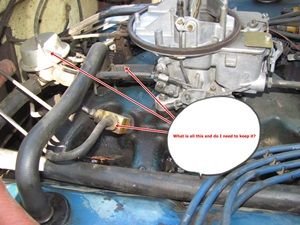

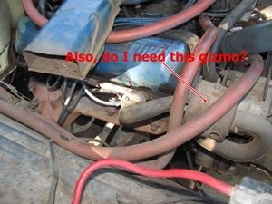

Hello
I'm in the process of replacing pushrods and lifters and cleaning/painting my intake manifold etc. Before I put it all back together, I need some help determining what purpose these (emissions?) parts are and do I need them. Can I delete this stuff and would it improve or hurt performance? Thanks!

I'm not sure if you need it for emissions or not, but the engine will run better without them.

Smog pump & smog pump valve. My x father in laws 66 f100 had that crap on it.
He just left it on and unhooked it but left it all in place.
Some states still have smog laws enforced on old vehicles..
I understand parts of AZ. And, I think NV. still doing some type of smog checks these the last, I heard.

OP's truck is exempt. CA smog tests 1976 and newer vehicles.

Thanks guys. I don't have to get a smog check in California for this truck. I just didn't know if it would hurt or help performance if I got rid of it. I'll pull that stuff off and cap it and see how it runs. Thanks for the help!

One more comment: You might not need it, but someone else does. I took mine off my '66 in an attempt to isolate a problem and it ran the same. I plugged the "air" holes in the heads with brass plugs. I got lucky - I found a guy who had to have a complete, correct '66 Thermactor system for his 352 Ranger resto and I was apparently the only guy in the world who had one. Please don't throw it away. Take pictures, clean it up and maybe a handsome sum of money will come your way eventually, as it did to me.

C6AZ-6052-A .. Plug-Cylinder Head Exhaust Air Supply / 1/2" -20 x 1 11/32" / Used to plug T/E (Thermactor Emission) holes in 289/302 & FE cylinder heads.
