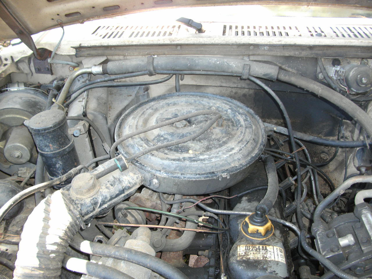

Here is a picture of my oil fill cap. It is original to the truck. It is an 83 F100. Hope it helps.

Wow. Those beautiful, intact, vacuum lines.
Nothing like that at all. That makes sense. Mine doesnt...
OEM style cap as it is on my truck.
Very similar to this engine, except my PCV Valve is at the back, not right by the cap.

I don't think those kind of caps let much air in there if any. Sounds like the breather you put on there worked pretty good.
The vacuum lines on my truck are barely hanging on, lol! I'm very careful when I have to move them around.

Well, they are there and they go to the right place. I like that!
They let in NO air. Which is the part I dont understand. It was building pressure and blowing the dipstick out. My teacher said there may buildup more fumes in the engine compartment with how I have it rigged, but if my truck is running its going down the road, anyways. I dont waste gas idling in parking lots. Perks of being 17 and broke all the time..

By your description, you have the wrong cap. If there are only two holes in the cover, you need the breathable cap. The engine in the picture shows what I believe to be the PCV in the wrong spot-that valve cover should have a hole/grommet in the back for the PCV, where you see the PCV in the picture should be the breather hose to the air cleaner, then a solid oil cap. The 2 hose PCV should have one hose going to the manifold tee, the smaller hose connects to a solenoid for EVAP canister purge. If you don't have any emissions on your truck, only use one port for PCV vacuum and cap the other. ~Bill
