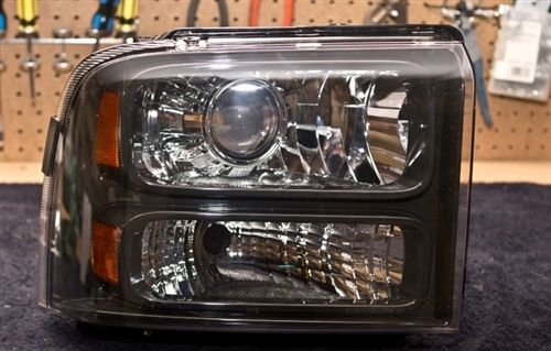

I was actually thinking of going with some '05-07' style Harley housings, which i will open up, and install a set of FX-R 3" Projectors in to. These will be powered by a 75w Hid system at 4300K. The front Parking/turn lights will be a set of 80W CREE XB-D Leds. Assuring i can see, and be seen.
The projectors are actually quite amazing at the light output they provide, while also virtually eliminating glare to other drivers.
the thought is a light to look similar to this
