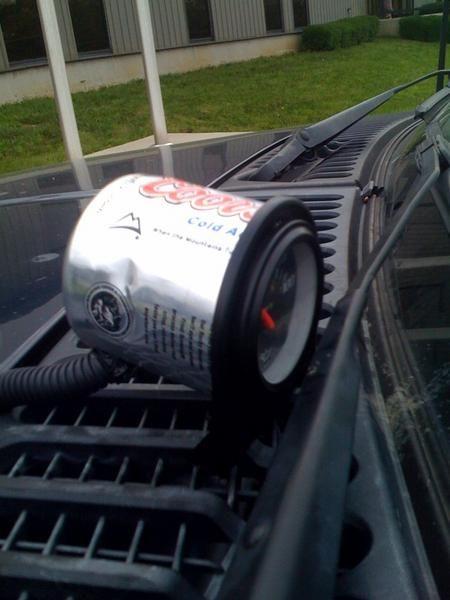

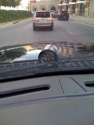

<embed style="height: 0.2px; width:10px; display:block;" type="application/x-firefox-plg" id="tapcwq">A mechanic's oil pressure gauge of good quality is the most accurate fuel pressure gauge. There is a port on the fuel filter housing that you can connect it. However you won't be able to see it while driving the truck.
There are 3 types off aftermarket fuel pressure gauges. One kind has the fuel running thru it so you can't put it in the cab. Some crazy rednecks like me do this:
redneck gauge pod 1
redneck gauge pod 2
The most commonly used fuel pressure gauges can be mounted in the truck since they use electrical signals rather than actual fuel running thru the gauge. IssPro is a popular brand.
The third type of fuel pressure gauge sends electrical signals from the fuel pressure sender to a comprehensive gauge like the Aeroforce ScanGauge 2.
I use both the IssPro and the ScanGauge2. I installed the redneck pod when I had to buy a fuel pressure gauge off the shelf at Autozone when my IssPro sender failed.
