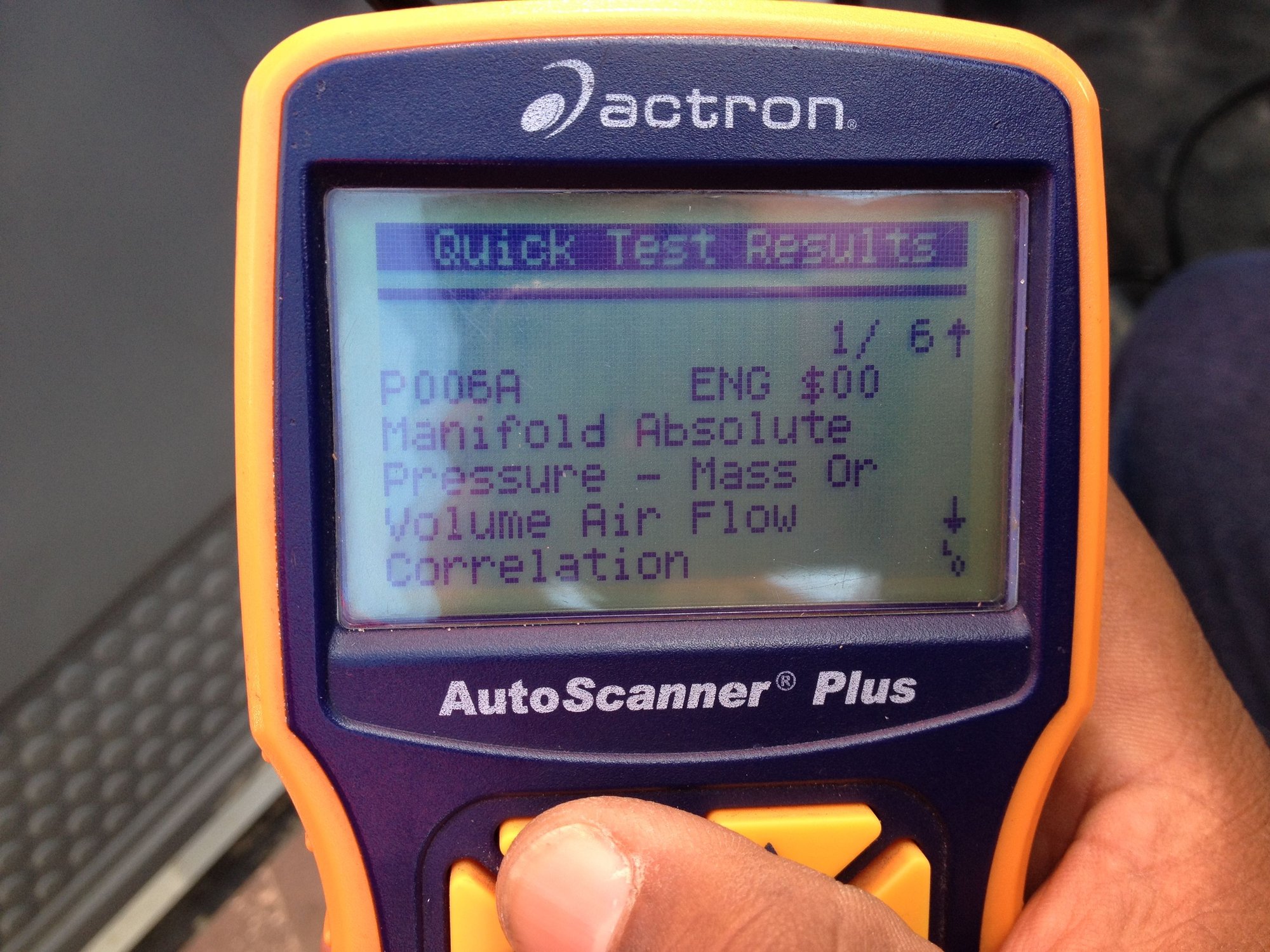

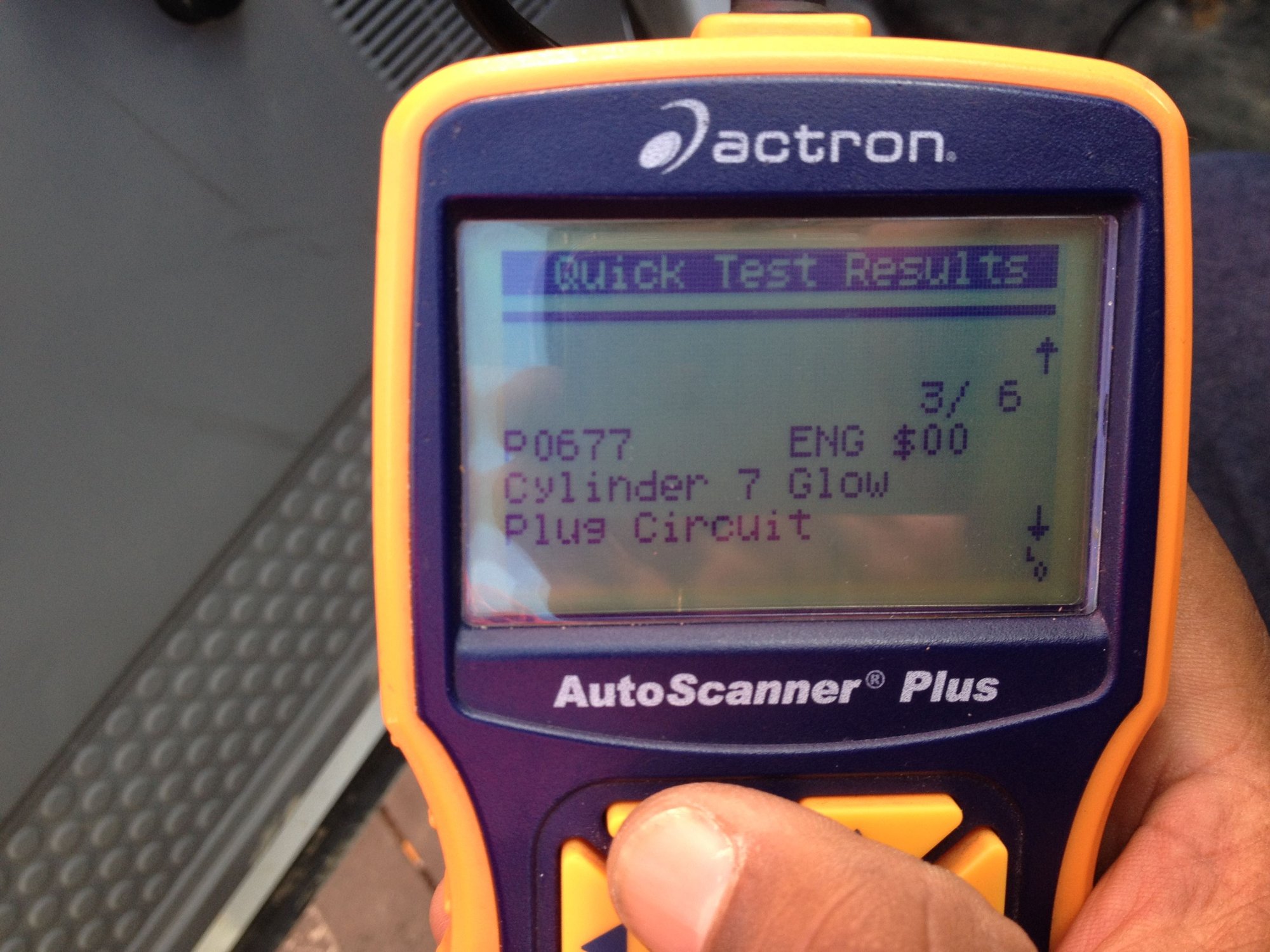

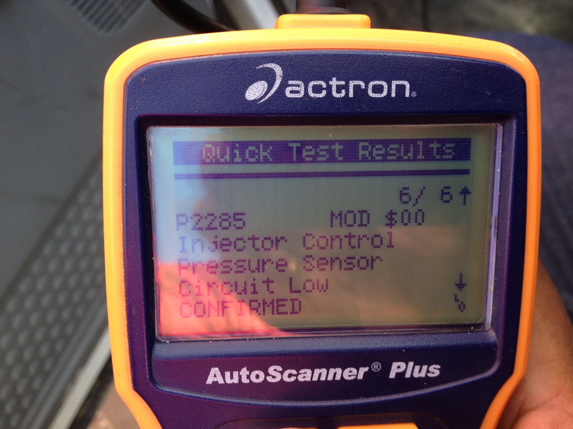

2003 Ford F250 Super Duty. 86,000 miles. No aftermarket mods. No ODBII or additional gauges.
My check engine light is on with the following codes:
P006a - MAP Mass or Volume Air Flow
P0401 - Exhaust Gas Re circulation Flow Insufficient Detected
P0677 - Cylinder 7 Glow Plug Circuit Fault
P132b - Turbocharger Boost Control 'A' Performance
P2285 - Injector Control Pressure Sensor Circuit Low
Truck was idling for a couple minutes when the idle went rough for a second... and the Check Engine light came on.
Found this.. but not 100% if this is it... http://www.justanswer.com/uploads/ti...sb06-24-06.pdf

Truck is dead at the moment.
Stalled multiple times on way to work.... throttle was all over the spectrum.. had to drop it in nuetral a couple times to avoid slamming into car in front of me.
Only code thrown at the moment is the "P2285 - Injector Control Pressure Sensor Circuit Low"
Ideas of where to start to fix this?
