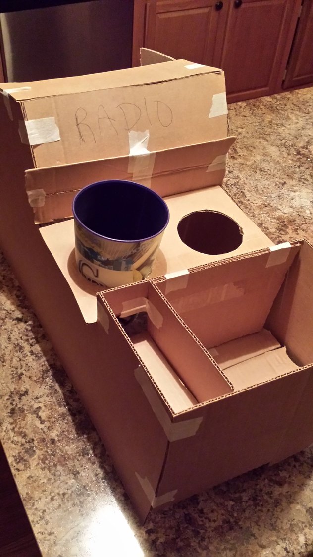

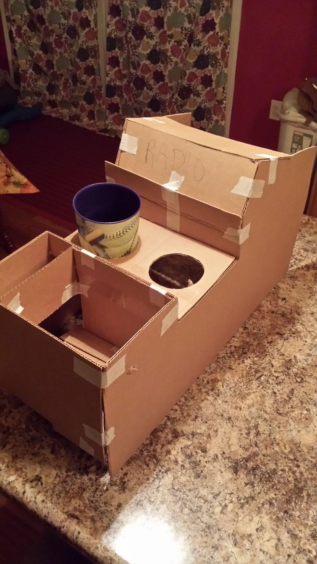

Just bought my dream truck, a 79 F150. It's got a 3 on the tree. It is all original and I don't want to tear out the am radio. Had to replace the dash speaker but am radio is well, am radio. I've decided to add a cd player without destroying the dash. Ive seen some pics and made a cardboard prototype floor console. Any ideas as to what to cover it with. I was was thinking about using mdf and then either painting or covering with vinyl, which would be a new experience for me.
The front left box would be for a cell phone and the deeper box on the right would be for other miscellaneous. I've got room on the back, under the radio slot, to add a small speaker or two, on the sides. I'm looking for any advice or opinions before start purchasing materials.

Here is an idea..
Exactly what I'm looking to do. Not having the shifter there, I'm going to add a couple of cup holders and a catch all box for phone, change, etc.
I looked at the fiberglass idea. It's pretty involved but would look really nice. Still not sure what I'll cover it with. I had to cut down the design a little. The dry fit was way way long. I was creating and watching my beloved Royals last night, so I never made it to the truck for an actual fit. Here is what I've got now.

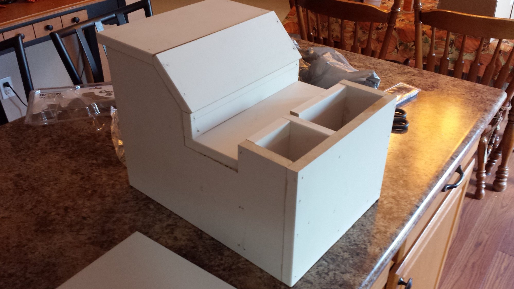

Here's where I'm
at now. In need of some major wood filler and then sanding, and repeat a few times. I'm also going to have to cut the back of the console at a slight downward slope. It's a tight squeeze in the truck right now
I used mdf, liquid nails and some finishing nails

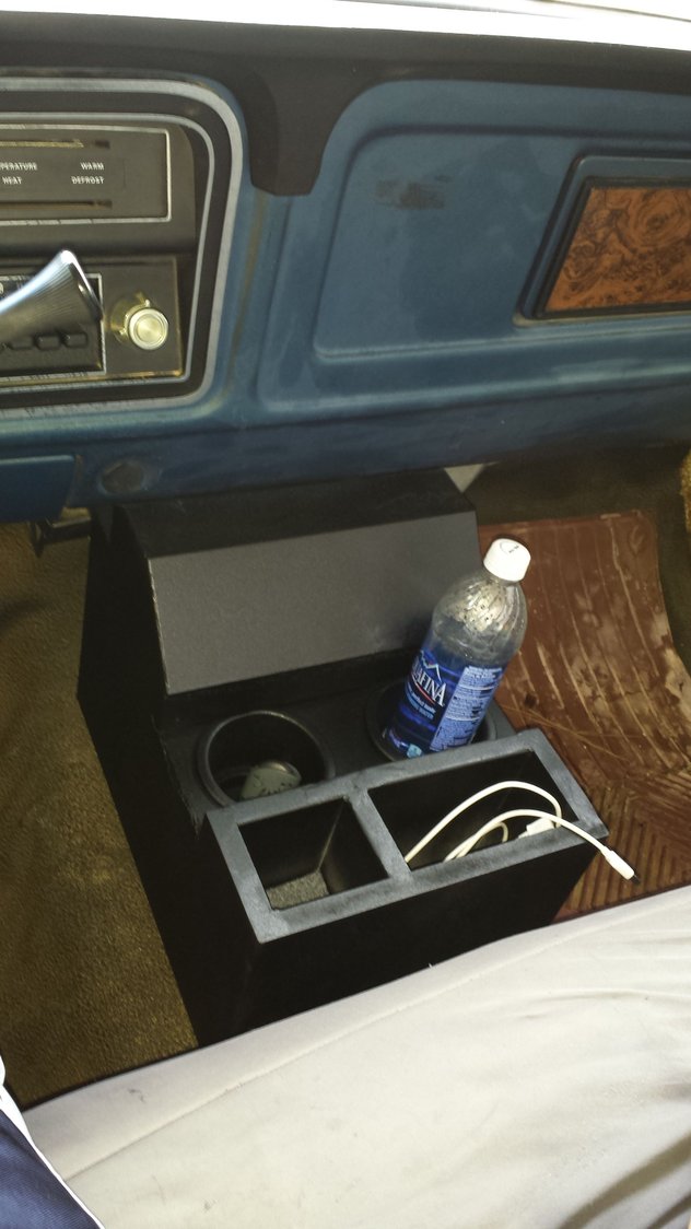

Just finished.
1. I should should have sanded more.
2. I should have sanded again
3. Sand sand sand
Not bad for a first time. I'll probably do another one once I replace the floor pan and floor cover, but until then I think this will do the trick.
I didn't cut cut the hole for the radio, as it will be a bit before I that project.

Sprayed it with 3 coats of truck bed liner

How is it mounted? I imagine it would slide off the hump in a fast turn or "evasive" maneuver.

Its not fasted to the floor. Just sits there. .. Kinda wedged in with the seat .. shorter people have a little issue driving the truck .. lol

This was exactly what I had in mind. Mine just sits there too. After I get a radio and speakers installed, I'll look at mounting it.
