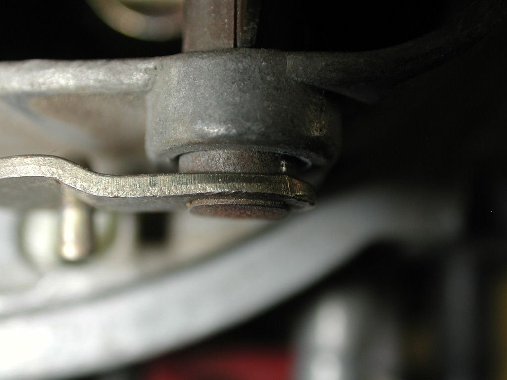

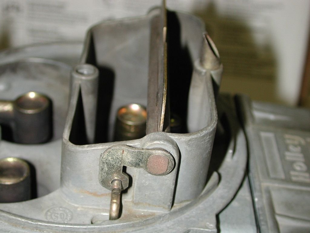

Anyway, just came up with a potential problem. As you can see in the pic the 750 Holley doesn't have a choke - he says it came from a boat, but all the boats I've seen have chokes. Anyway, I don't see how to get the choke butterfly out of the one I have. Here's a view of the end of the shaft, and I could grind the braded-over part off to get the arm off.
But, the butterfly doesn't have screws. Instead it has raised spots that hold it in the shaft.
And, the end of the shaft where the arm is doesn't appear to be split.
So, how does the butterfly come out?

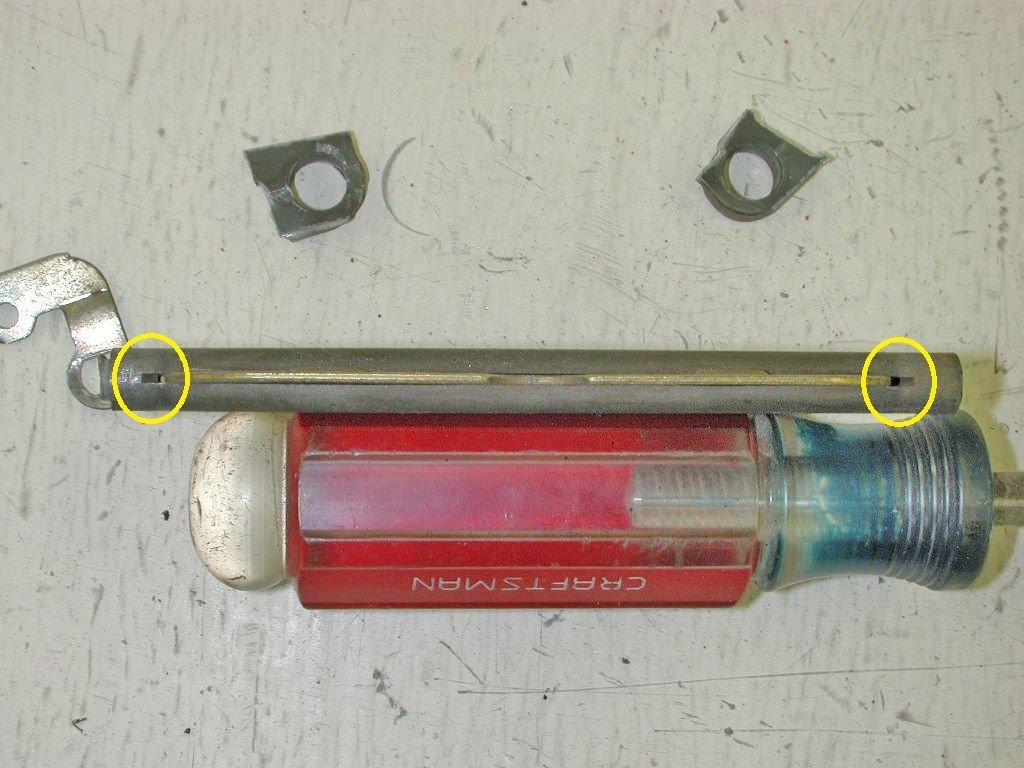

Ok, guys. I really do need some thoughts here. I got the butterfly and shaft out. Have Dremel, will travel:
But, as you can see in the yellow ovals, the slots in the shaft don't carry to the end of the shaft. Obviously I need to get the butterfly out to be able to install the shaft. So, what about slitting the shaft to the end and sliding the butterfly out? The housing will hold the shaft together when it goes in the "new" carb, so????
The only other option I can think of is to flatten the "bump" in the butterfly enough to get it out of the shaft. But, that is likely to deform the butterfly. And, even if it doesn't it would mean either drilling, tapping, and using screws to retain the butterfly, or re-bumping it in the carb.
Thoughts, please.
