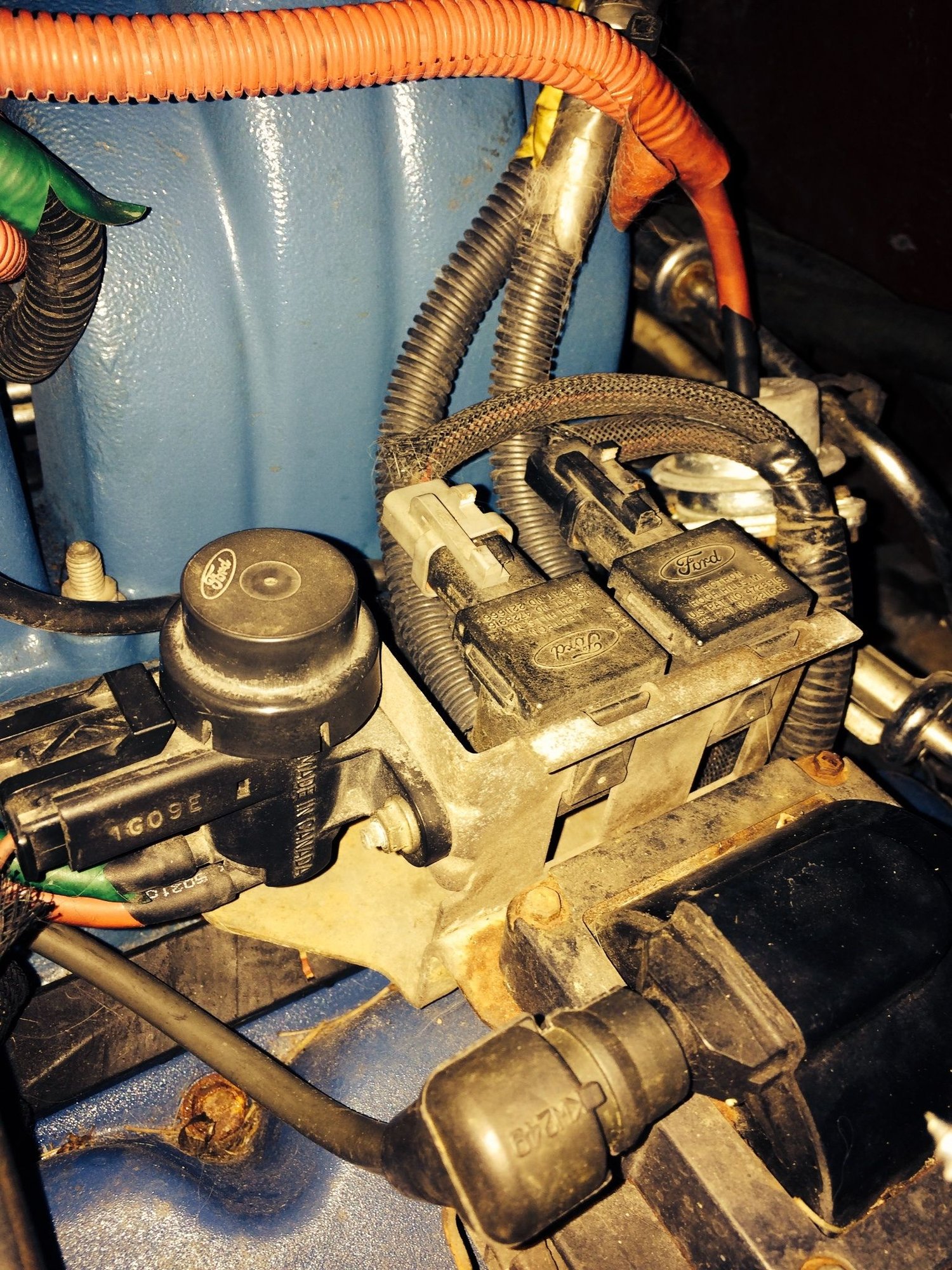

Don't know how much this picture will help, but this is my 91. It has a bracket to the left of the ignition coil that holds the EVR and Thermactor solenoids.
You can see where the EVR mounts to the front of the bracket with it's vacuum connections at the bottom.
The bracket has two small studs that mount the EVR with nuts.

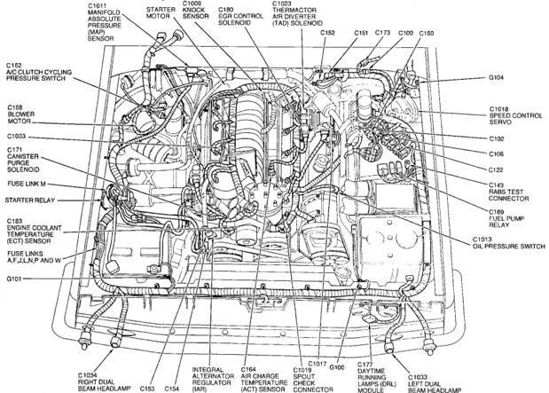

Here is a locations picture from the manual also. It is up near the top of the picture.
Your 88 may differ a bit, but hopefully this is some help.

thanks you. I really appreciate it. I plan on replacing all the vacuum lines with rubber hoses. the previous owner has the lines going all over the place. so I will definitely make sure I do one at a time. I am also having trouble finding those tad/tab solenoids. Can only order from ford?

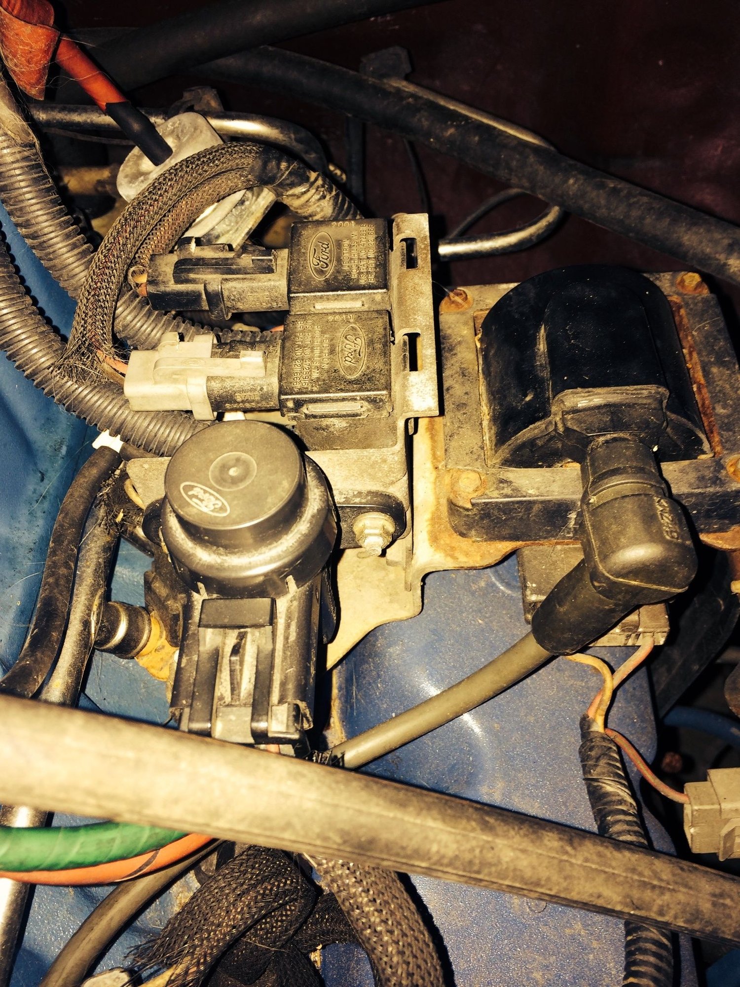

Yeah, I replaced all mine with rubber hoses not too long ago.
I also looked around and couldn't seem to find the solenoids online for sale. You can always try the dealer, but I wouldn't expect them to have them. You never know though. You may end up going to the junk yard.
Here's a couple more pics I shot of it. May be of some help.

Yea ended up going to the junk yard. got the bracket and solenoids for 10$.
